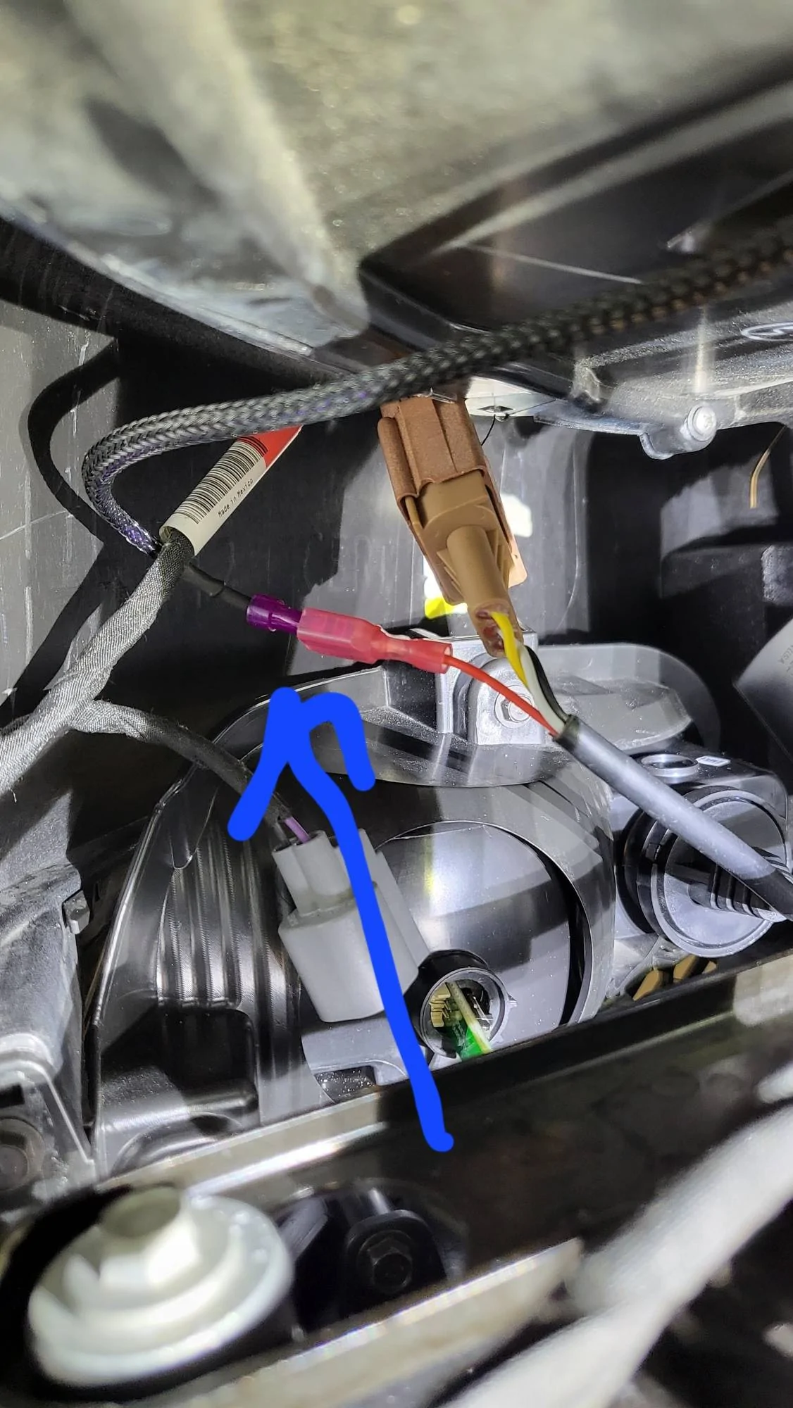

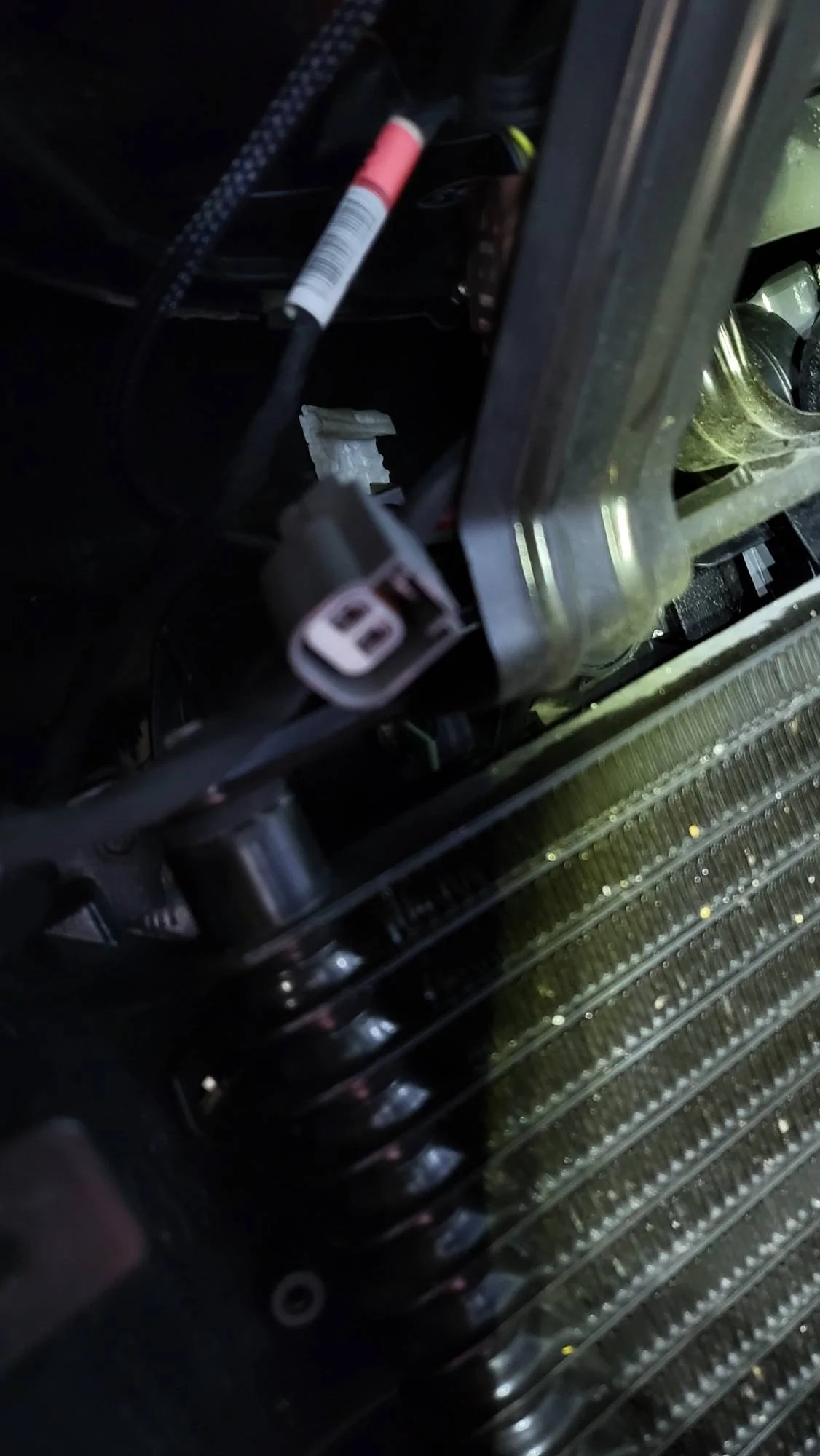

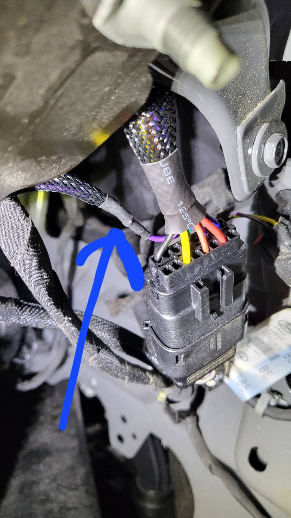

I noticed their instructions are wrong now. It seems they updated their harnesses. The DRL harness has a single wire (purple wire) below that now plugs into a single wire coming out of the light. You no longer have to punch a hole out of the plug and install an additional wire. But the instruction state to do it.
One thing I do not like is the grey plug that was the corner marker light is no longer in use. This is now exposed to the elements. They should have included a dummy plug to snap into it so water doesn't get in and corrode it.
