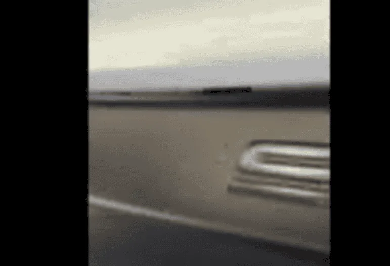

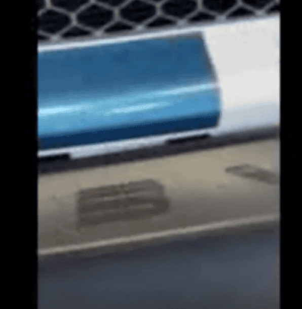

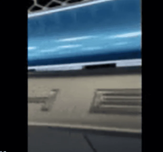

I am looking at a 2020R out of state and hope to drive it off the lot this afternoon (about to book a flight). Through the extensive lurking on this forum, I found a few instances of people complaining about poor splitter installations. From various reports, I asked the dealer to send me pictures of the installed splitter to ensure it was properly seated. Unfortunately, the video I received is compressed and fuzzy, but even though the poor quality I believe I see a gap above the splitter and below the bumper with obvious slots for the splitter tangs across the front. Will someone please post images of their splitter so I can put my concerns to rest. I don't really have time to sit around and wait for their mechanic (I was told their expert did the prep work). I have an 850-mile drive home with the car and I don't want any issues.

Keep it under 140 and should be fine. Looks fubared to me

It's definitely not installed properly. If installed correctly the holes you see will be covered by the splitter - there's tabs that go into the holes that hold it in place. Instructions tell you to cover the splitter and tap it in place with a rubber mallet after lining up the tabs. If the fasteners underneath are all installed it should be fine to drive. Also, I would inspect the bottom of the splitter because it can pop out if you scrape the splitter.
