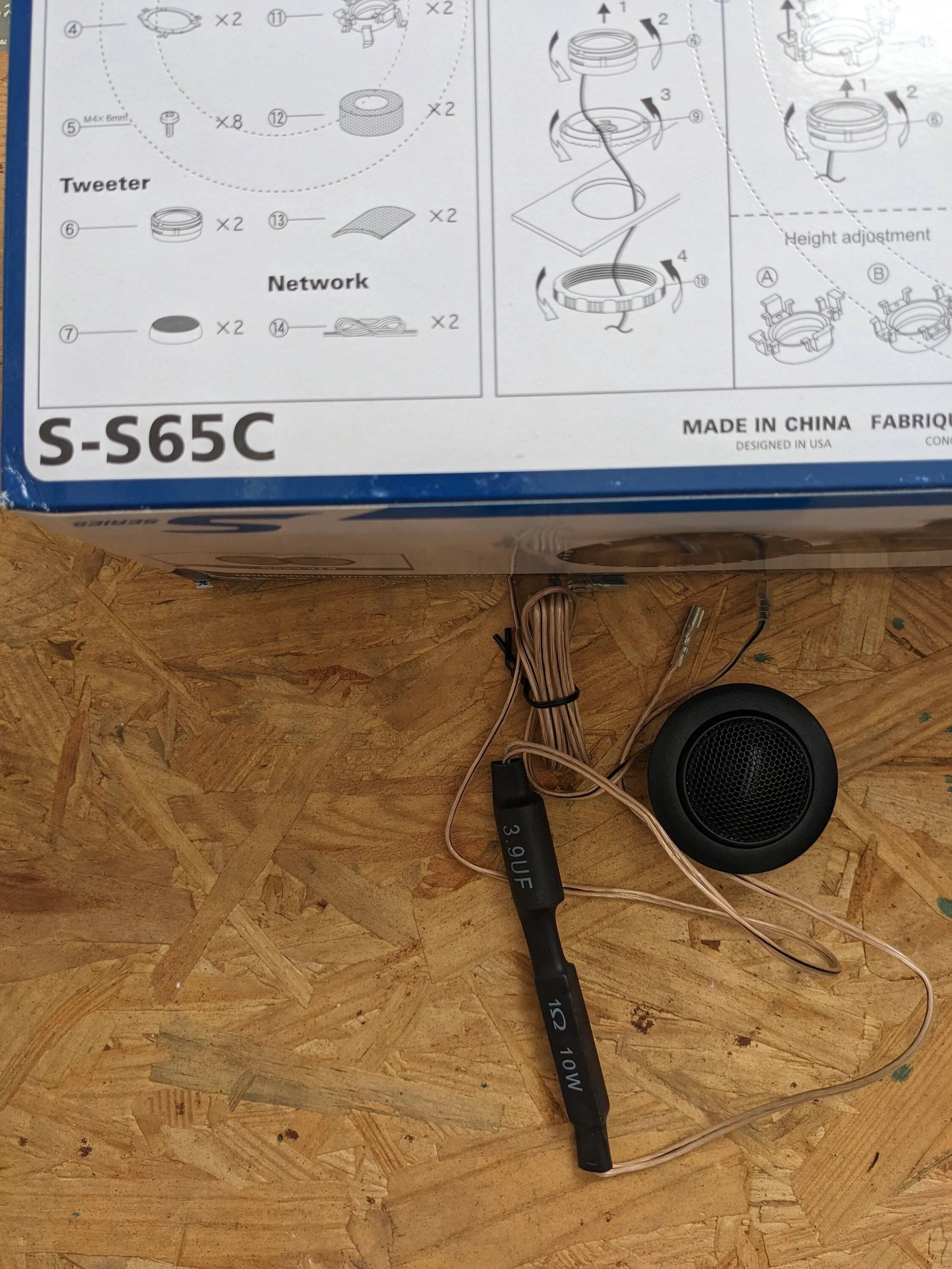

I was going to start a new thread but decided to post here since it seemed relevant to the OP's post. I'm in the process of installing some components. Local shop sold me these speakers for the door/a-pillar:
https://www.alpine-usa.com/product/s-s65c
https://www.alpine-usa.com/product/30mc-midrange-component-speakers
Pictured below is the mid-range and the tweeter (6.5" is already in the car) and I'm not sure what the other piece would be called. Is it a filter? Crossover? Alpine box just says Network. Anyway, all I'm doing is a modest (hopefully) upgrade of the speakers, nothing else (except a sub when I'm done this step). My question is, do I need to connect this piece inline with the tweeter, or just leave it out, since as you say, the amp already sends the appropriate frequencies to each speaker?

Yes, it’s a basic crossover.
So, yes, install it? I'm confused as to where, since it came in the package with the 6.5 and tweeter. The wiring diagram I've seen shows the woofer connected separately from the tweeter/mid-range, which are connected in parallel.
Since I'm a novice when it comes to car stereo wiring, just install it in the a-pillar in front of the tweeter?

Dont know. I usually recommend to rewire the tweeter with new wires, so in your case put the crossover wherever it fits.
