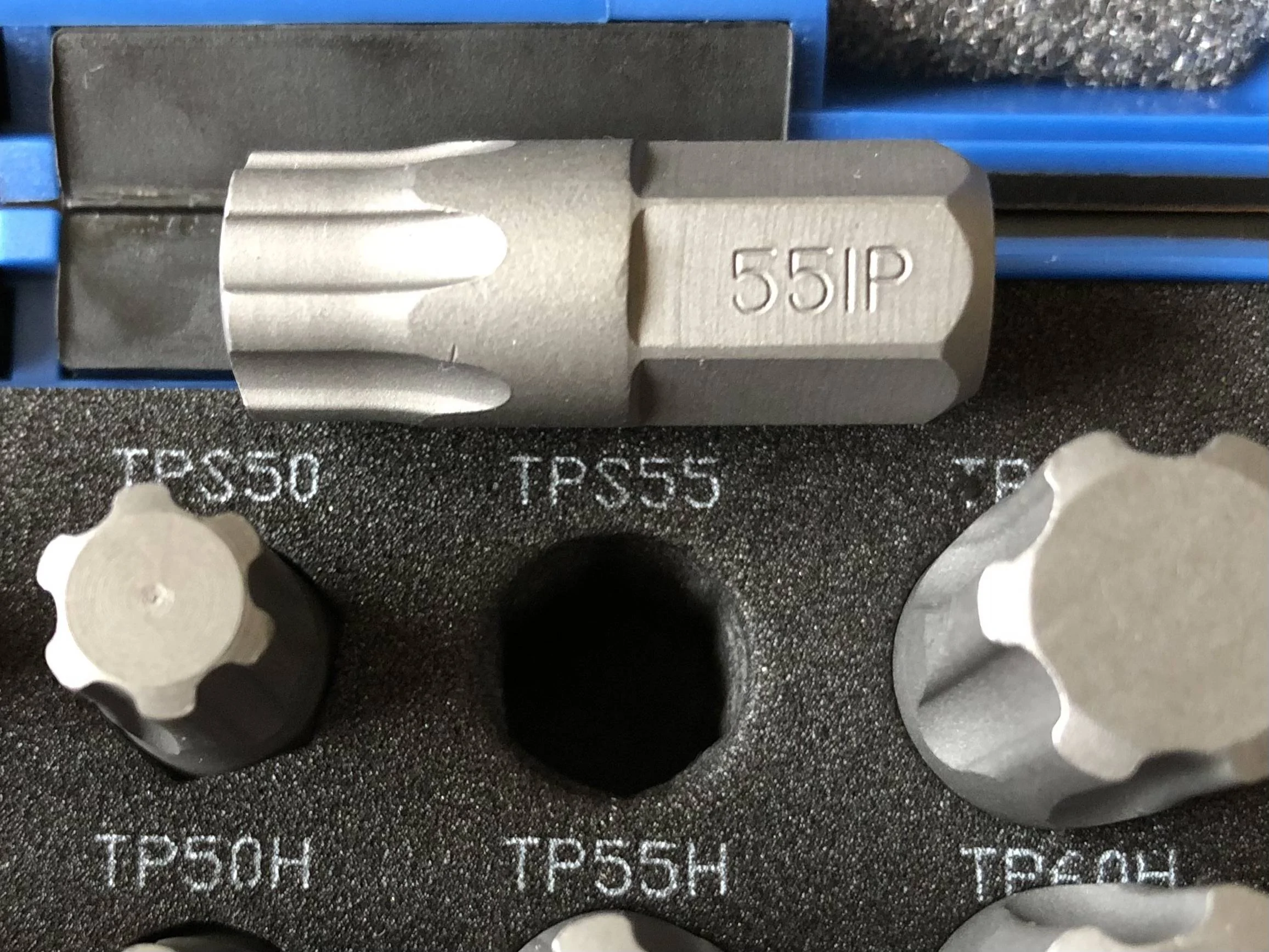

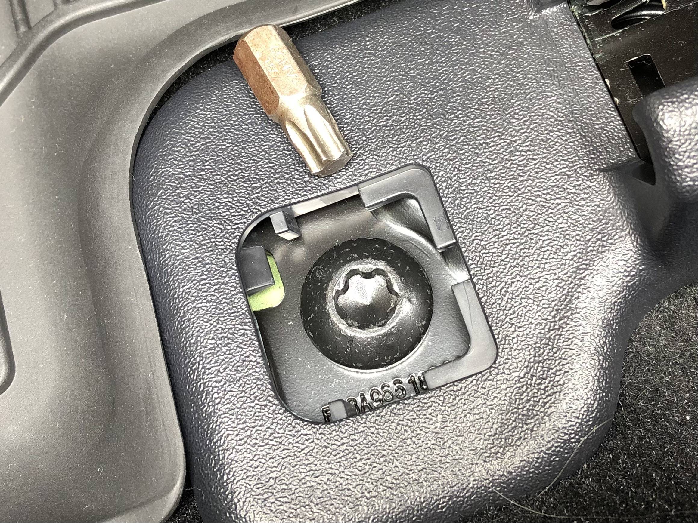

The 2021 Mach 1 uses 4, T-55 headed bolts, to mount the front seats to the floor pan.......bolts are about 1" long
Does anyone know the thread pitch?
I find no facts regarding these bolts, and replacing them with longer bolts, in the rear set of holes.
Reason:
I want to mount a CMS seat belt harness bar, to the front seat's, rear seat mount holes....the stock 1" bolts sit in a recess, and are likely too short to mount the bar, without a longer stud, and spacer for the recess.

You will need the T50 to remove the OEM bolts anyway, so why not just pull one of the fronts to check the thread spec yourself?

Ok,
Stock rear seat bolt is:
10mm x 1.50 pitch 1.2" long, or 30.45mm long.
I purchased 2, 10mm x 1.50 pitch 42.54 mm length. Looks like it will accommodate the Watson 1/4 plate, as it measures about 12MM 1/2" longer, but needs a 1/8 " washer under the hex head to spread the load.
The 1/8" thick CMS plate...I I got two 37.46 long 10mm x 1.50 pitch bolts. Looks like it will be enough.
