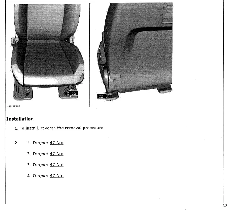

The below is from the service manual.
Installation
To install, reverse the 1. removal procedure.
Install the front seat bolts in the following sequence.
Install the front inboard bolt.
Torque: 35 lb.ft (47 Nm)
Install the front outboard bolt.
Install the rear inboard bolt.
Install the rear outboard bolt.

Perfect! Thank you for confirming.
