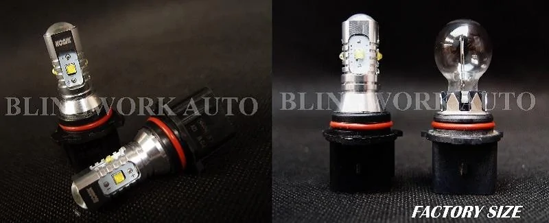

you have to get small drl bulbs, ordinary ones wont fit, look at this exampleJust looked in the handbook and its says the DRL's are P13W but it also says the lamp can't be removed from the holder. Had a look on Fleabay and a P13W looks as though it comes with a fixed base but not sure if the Ford connection / plug is the same arrangement, how did you get on with them blar blar blar?
got to get a narrow base aswel, just above the O ring
Yes mate , the ones I posted in pic, are a bit expensive though. Must be cheaper options out thereDid you get ones that fit yet?

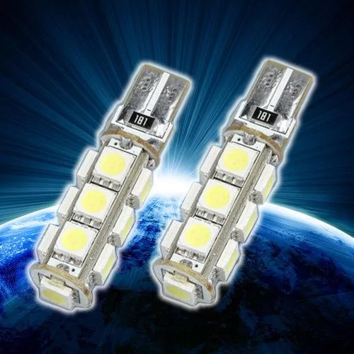

So those ones fit our sidelights i.e. the light right next to the indicator, the ones lit up in Gibbo's second pic on this page, NOT the DRL/foglight?http://www.ebay.co.uk/itm/121355905937?_trksid=p2057872.m2749.l2649&ssPageName=STRK:MEBIDX:IT
These ones mate, and I had to pay import duty grrrrrrr
Load if different types on Fleabay and 10 a penny - just make sure the connection is the flat blade style.So those ones fit our sidelights i.e. the light right next to the indicator, the ones lit up in Gibbo's second pic on this page, NOT the DRL/foglight?
I've found a UK website that does them and they're charging ÂŁ39.99 plus ÂŁ4P&P so you didn't get mugged too badly buying them from Aus.
Does anyone know what bulb the orange indicator one is? There must be a clear version of some kind that flashes orange so we don't have the orange "glow" behind the lens when it's not operating.
Those are the indicator bulbs, yes? That appear clear in the housing but will flash orange?Load if different types on Fleabay and 10 a penny - just make sure the connection is the flat blade style.
P.S. don't believe the handbook that they are just "pull out", I think they missed the wording "twist anticlockwise then pull"... I found out by good old youtube...
181 is most likely the manufacture colour code... These are the sidelight type fitting and not the indicator themselves (fit beside the indicator)... Ignore the colour of the LED when not powered as it will change colour when energised.Those are the indicator bulbs, yes? That appear clear in the housing but will flash orange?
What's that 181 stamped on them, the type?
