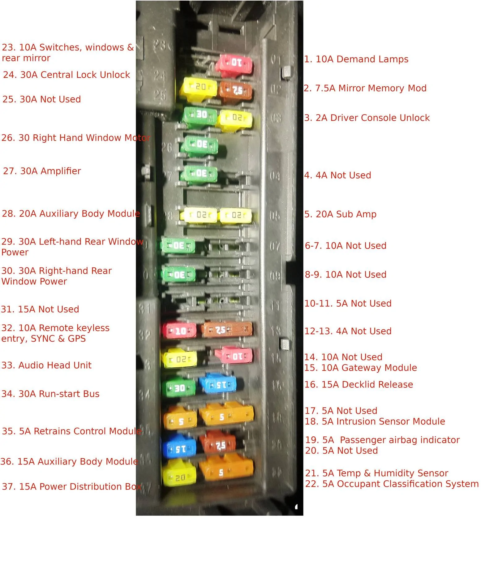

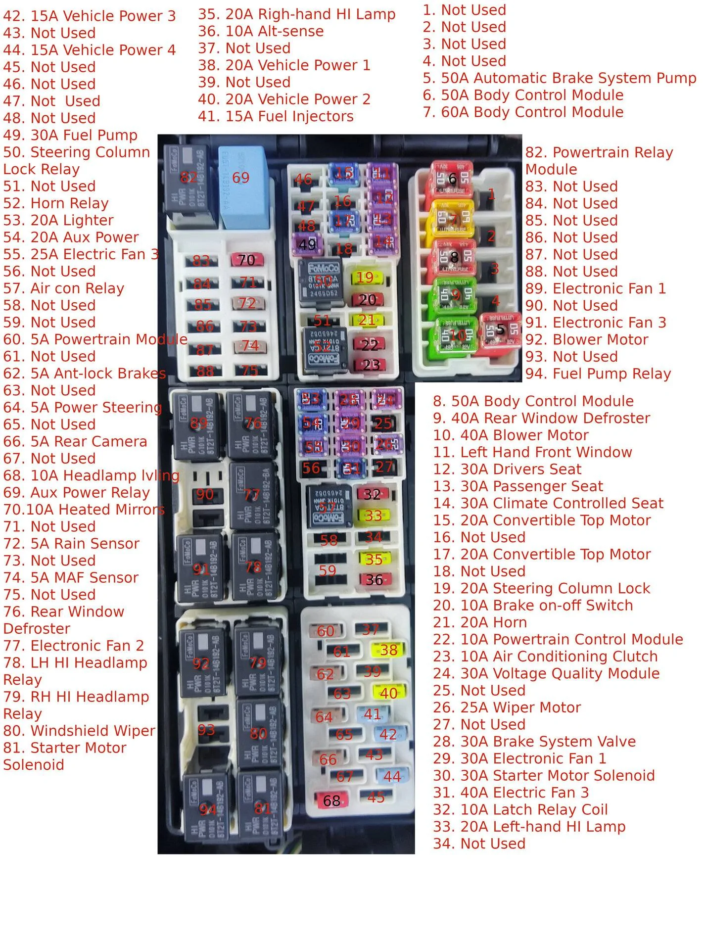

I don't know when they stopped working but the Diode Dynamics SS3 worked when I installed them. I checked the fuse diagram and found nothing that pointed to a specific fuse so I checked them all under the bonnet and the foot well and none were blown. I swapped back the original light and still nothing. I connected a voltmeter to the connector to the light while the engine was running but it's not getting any power.
