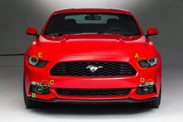

I'm confused!
In the handbook the bulb list contains the DRL bulb which is a P13W/30w, and also a foglight bulb which is a H8/60w.
I thought our foglights WERE the DRL's (B)?
A US DRL
B UK DRL/foglight
C sidelight
D indicator

Yes. In fact, the european B fog lights include TWO lamps inside. One serves as DRL and another one for fog lights.

I'm confused!
A US DRL
B UK DRL/foglight
C sidelight
D indicator
E headlight
Theres two bulbs in the "fog light" assembly.... the lower is the DRL (P13W) and the upper the fog light... turn your car on and light dial to 0, then look at the front of your car and all will become clear :)

I'm confused!
A US DRL
B UK DRL/foglight
C sidelight
D indicator
E headlight
I've just ordered a full set (except for headlights) of replacement front bulbs. I couldn't seem to get them all from one place so I had to order from a variety of sources (I looked on ebay, horizon LEDs, HQ automotive lighting, XenonBulbs and a few others). Looking at the DRL bulb it doesn't look like there is much room inside the actual lens unit so I think you'll probably need a fairly compact replacement bulb (there seem to be quite a few different designs of bulb for each application). For this reason all the bulbs I've ordered are CREE LED Canbus bulbs. Not cheap, but seem to be the best things out there.
