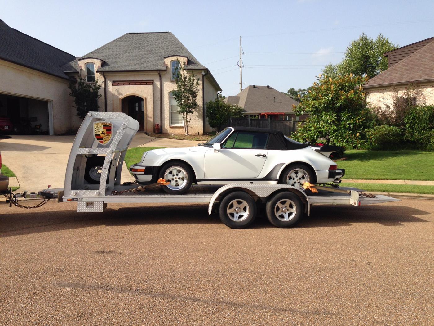

A trailer such as a Texas Rollback will work great and you won't have to worry about ramps. I have a 26' Texas rollback I use for my cars when hauling only one. Most stock 911's do not need any extra ramps to get on my trailer, but my modded cars I use an extra set of aluminum ramps that are 2' long - it would not be necessary for the GT350. It can just drive on.
This is what mine looks like and will try to get more shots of it in action. Although my fenders are removable, I never have to due to the low clearance.
That said, here is a video of a trailer that works similar to mine so you get the idea...[ame="[MEDIA=youtube]dolw2smrbN4[/MEDIA]"]

the vettes nose smacked off the trailer when loading in the video.
not sure how much difference in that, to the R in height.

That's a nice idea but not really any better then long ramps. To many moving parts and worries for me. I can't imagine it's cost effective either.
