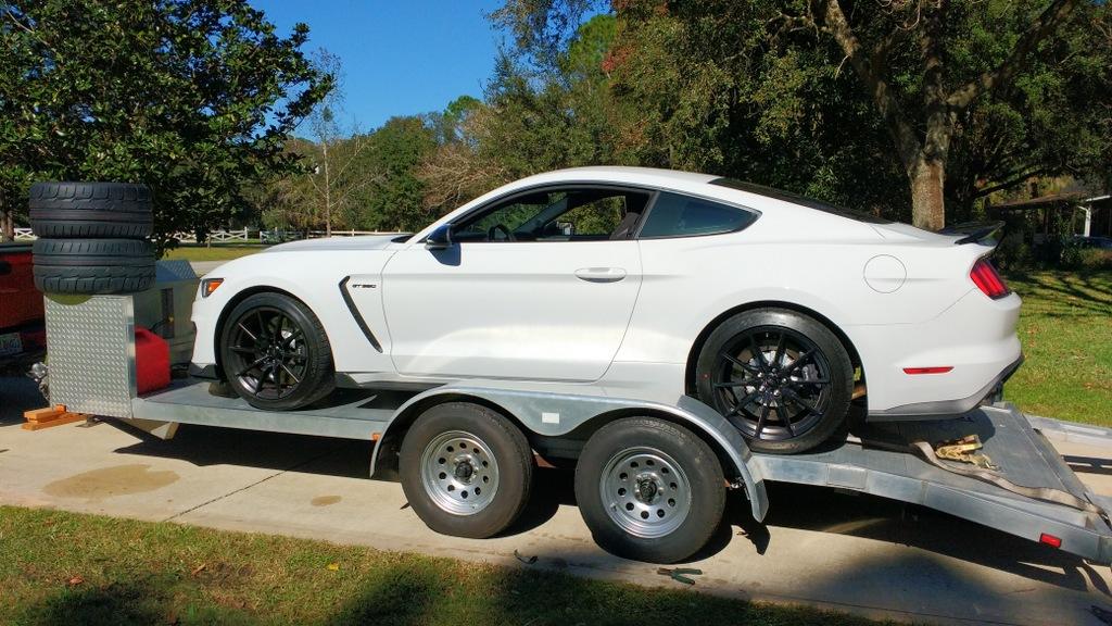

The car is 15.6' long and the wheelbase is 8.9'. You can fit it on a 16' though it would be tight. I think an 18' is ideal if you're not carrying anything else.
Here's a picture of my 20' trailer. I needed space for tires, toolbox and fuel jugs.
Do you have any problems with opening the doors without hitting the trailer fenders?
I'm also looking to buy a new trailer for my gt350.
Yes, the fenders are removable though. I think the measured clearance to the door is 7.5 inches. My trailer fenders were 9 inches tall.
