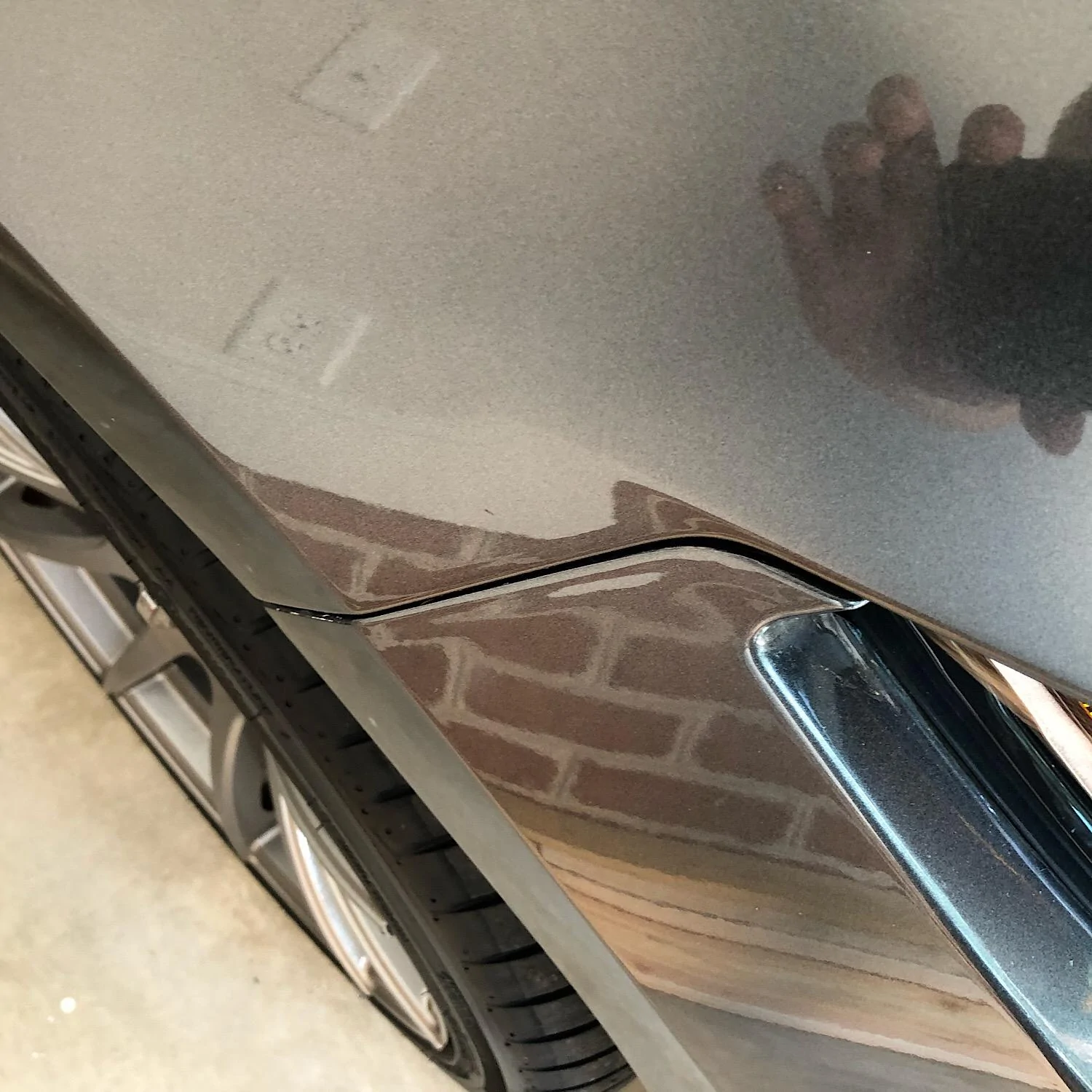

So, my left front dog ear at the trailing edge of the headlamp is looking like a mess. Anyone else having this issue?
The right side looks good.

I see this with other cars from a front impact. Weird

No frontal impact here. My 2014 Fusion did the same thing.

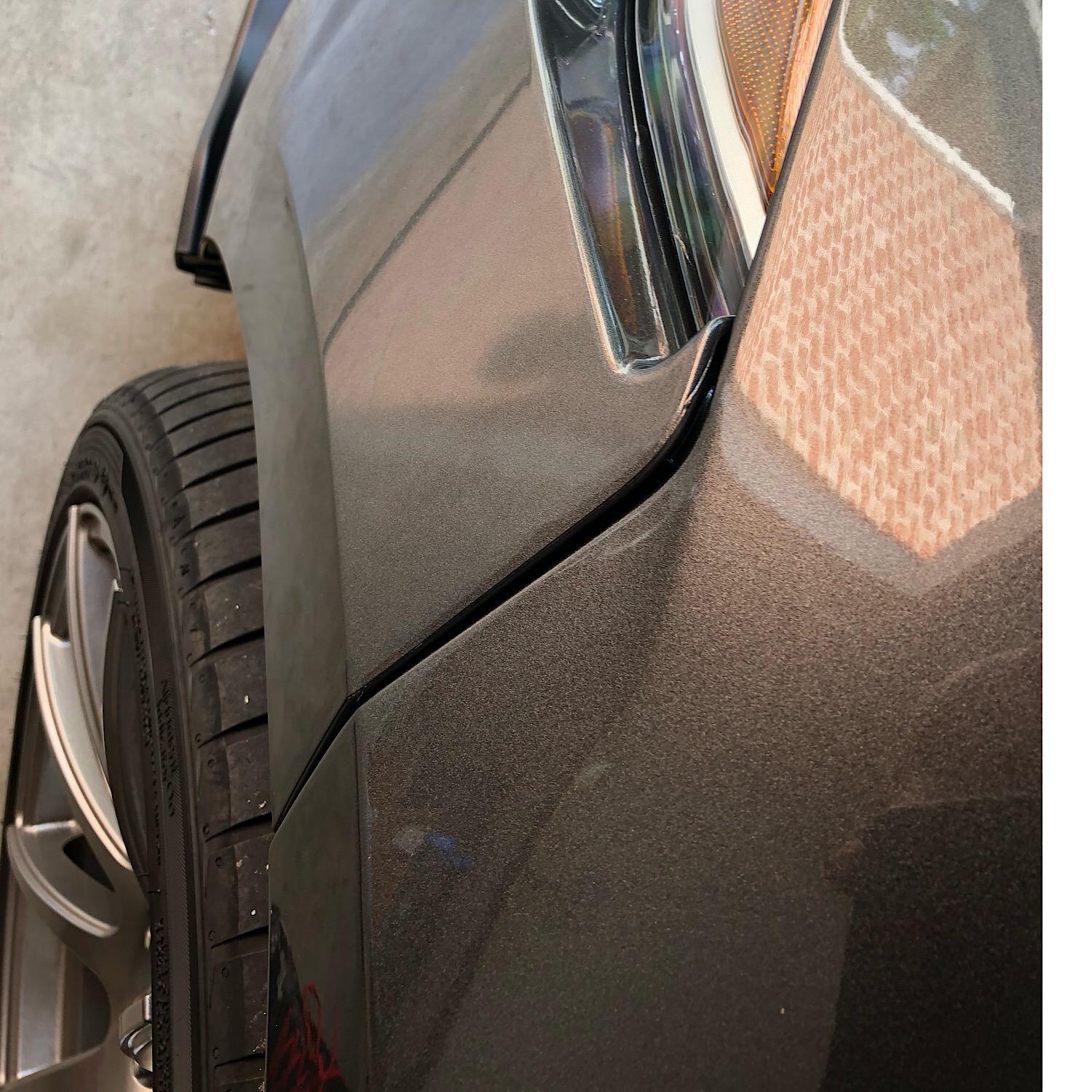

I'm a detail and paint guy and what I've noticed on mine is probably just shoddy work from the factory. I had 2 high end German cars (which were perfect) before this and I've just learned to live with the Ford "flaws".

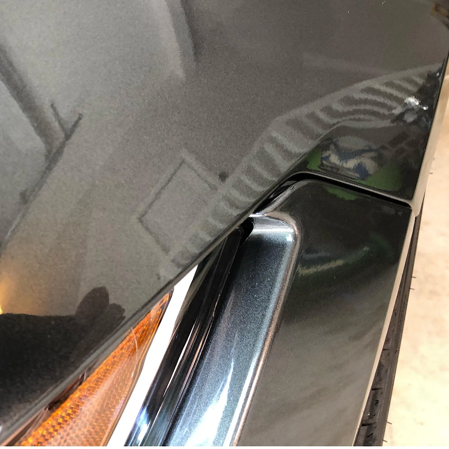

Mine's been *exactly* like that since delivery and the dealer's going to take a crack at fixing it when the parts arrive for the rear bumper fix.

Mine looks the same. I removed the wheel well liner and realigned then retightened but it eventually returned to its original position. A lot of the problem is access to the small bolt and weakness of the bracket. Similar to the rear bumper hardware.

Not only the bracket but the nut plates/u nuts strip and there for hardware is loose. Loose hardware, low tension saggy bumper

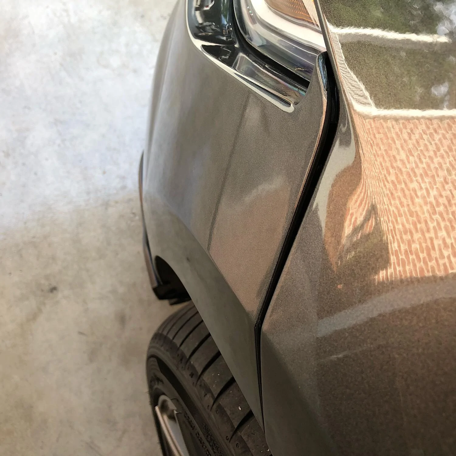

Fixed mine for good, removed wheel well liner, got rid of shitty screw, drilled a hole through bracket and used a stainless steel bolt with washers and nylon nut. Voila, problem solved. Now i need to find a solution for that rear sagging bumper cover, no way i’m letting the dealership touch my car.

I leaned on mine pretty good to pop it back in. As others stated, pull the fender liner, loosen, adjust, and re-tighten

I’ve got the same thing on the top and as a bonus the bottom part sticks out as well. With this and other issues my detailer honestly thought it had been in accident and repaired very shoddily.
