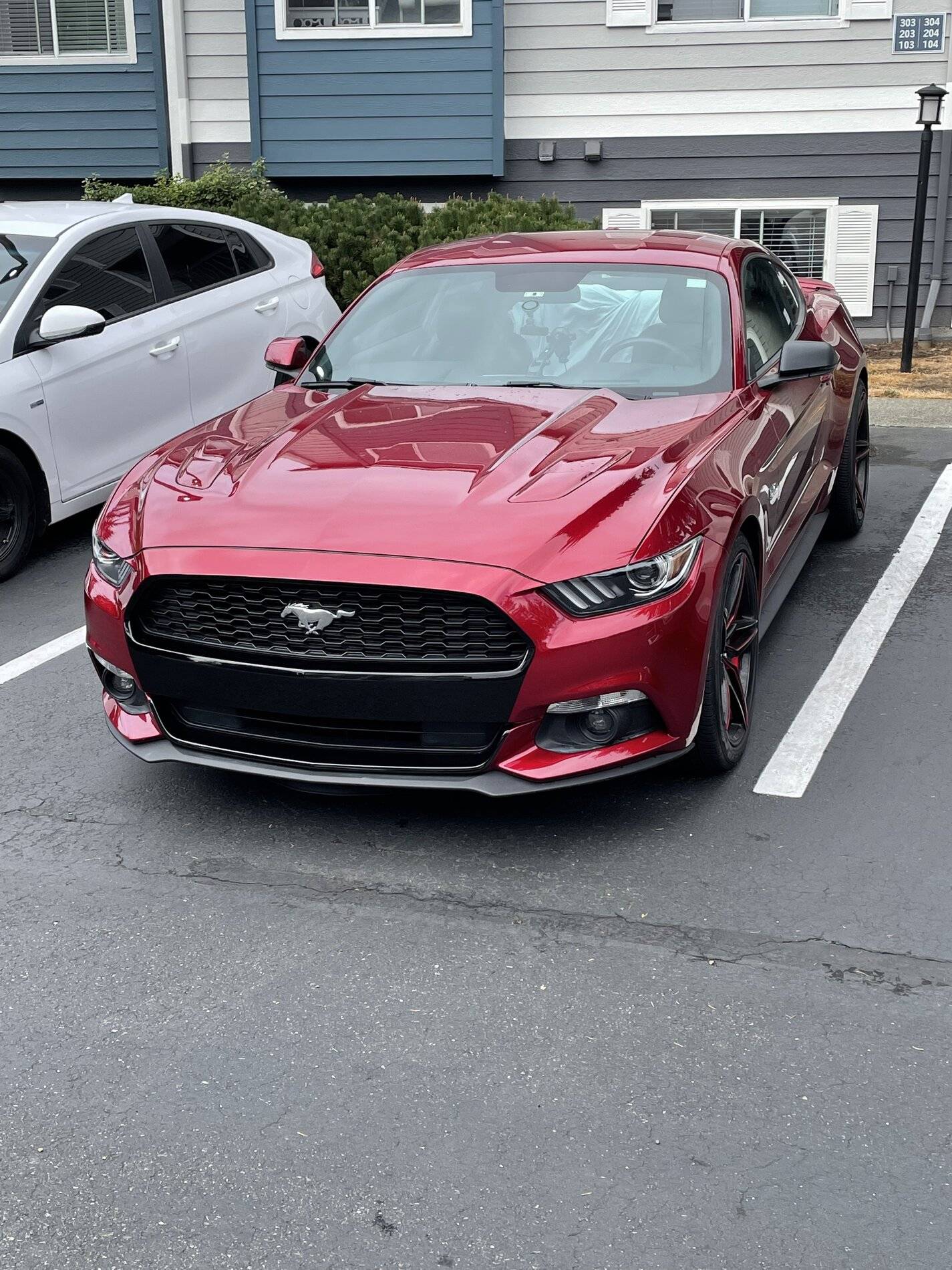

Did it myself with the knife less tape and Avery wrap
That’s an amazing job! You should make a video tutorial next time haha. Lots of people do this specific look but there are no tutorials anywhere. I just bought stuff to do my first wrap. Going to start with the gas cover, rear deck lid panel, and roof. The bumper seems more advanced because of all the curves.

Thank you..When I did that back in 2015 ..had no idea the gt500 would look so similar..when I traded in for my 19...it was more challenging to wrap that bumper cover .
Was it a single piece or multiple?

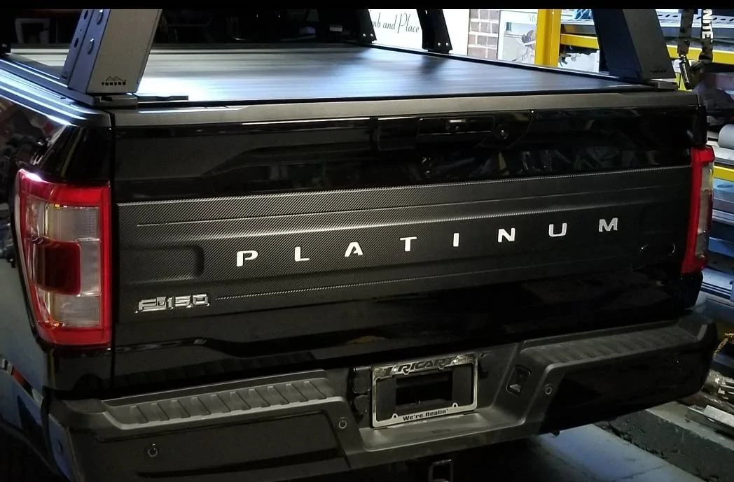

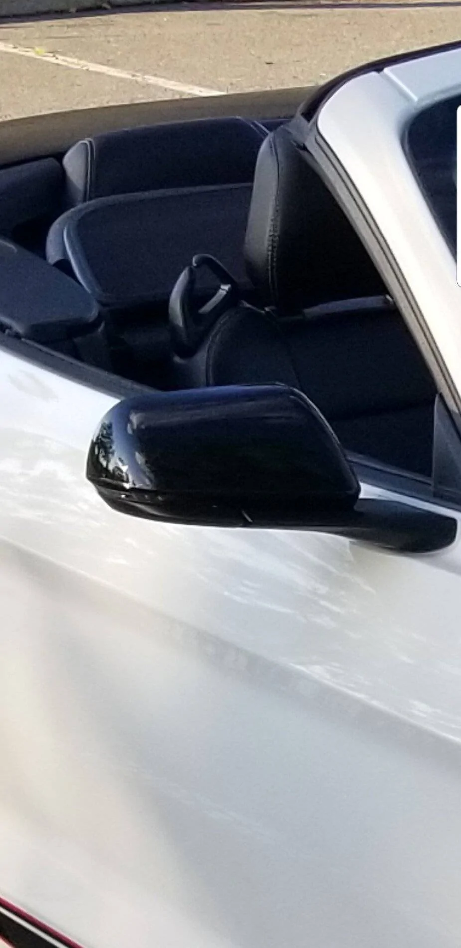

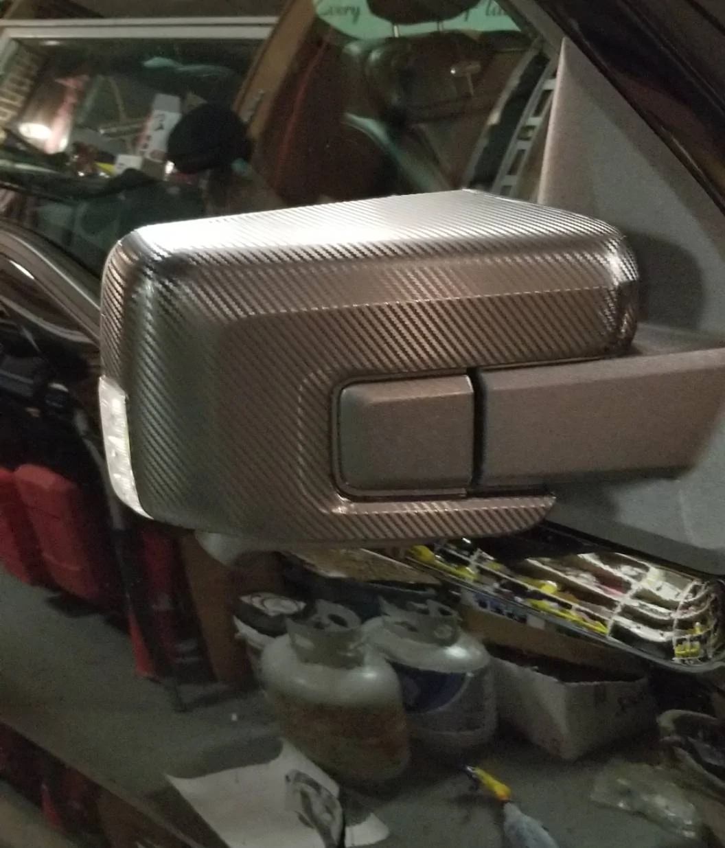

I've done a lot of wraps and PPF for myself. Never a full car or truck, but parts; mirrors, tailgates, trim, door handles, hoods (those are difficult). The material is well under $100. I refused to pay $750 a body part (bumper) and learned to do it myself. I have to imagine you can find an ambitious start up vinyl wrapper to do that bumper for you for $250. $750 and it would/should be perfect. For $250, maybe a few minor creases, enjoy it for a year, pull it off, and you're good. No harm on the paint. I'm a hobbyist and figured it out. So can you. Here's some stuff I did...

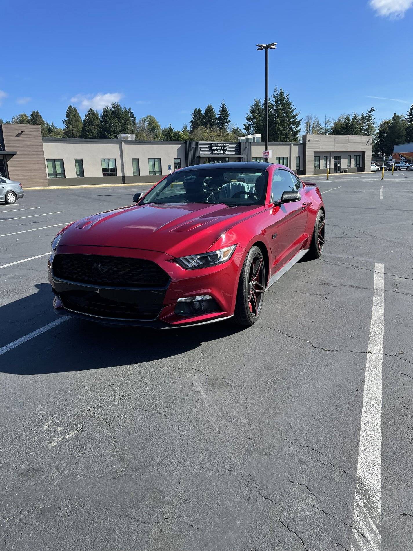

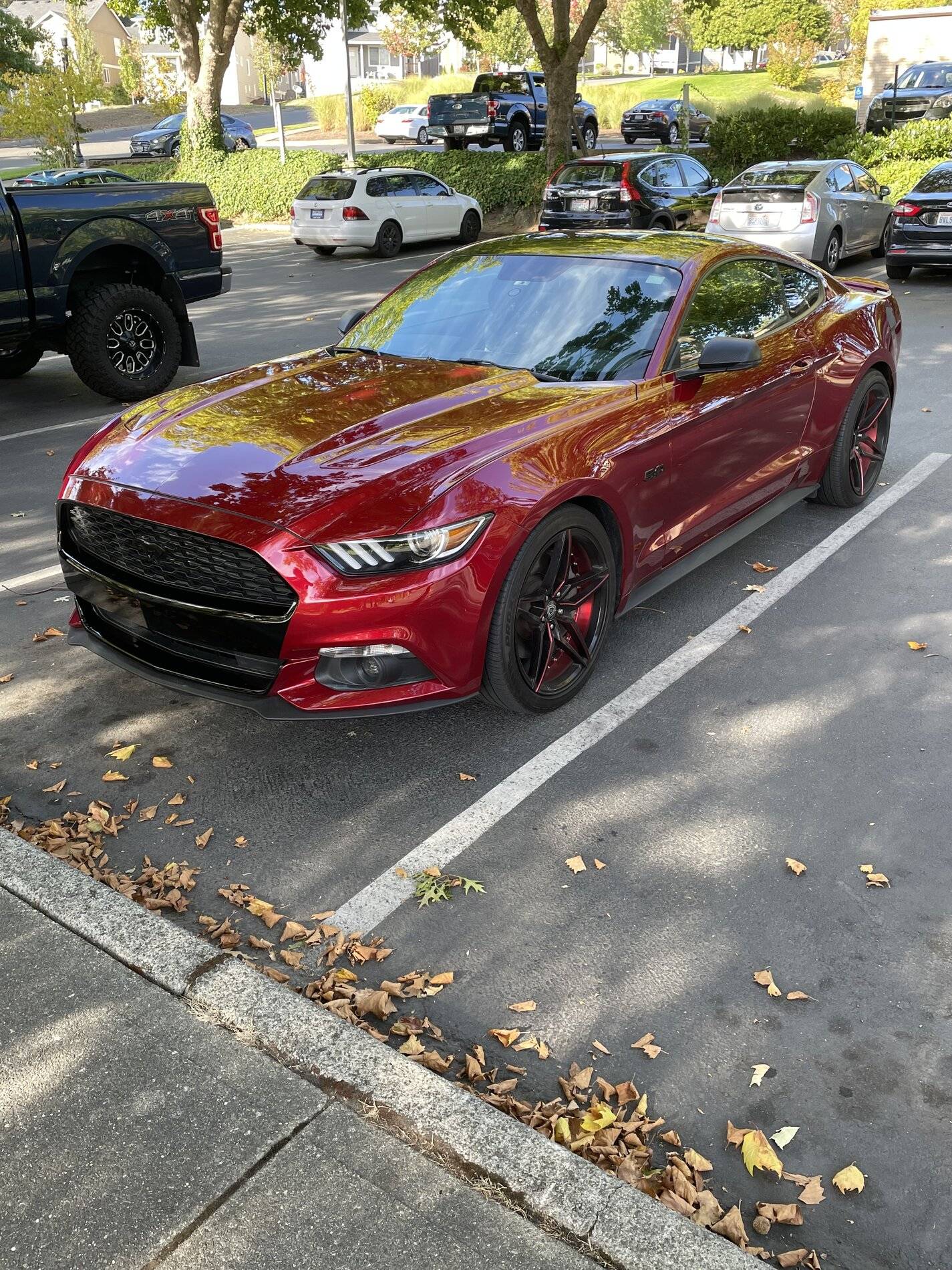

I found someone who wrapped the bumper for $70. I wrapped the mirrors and gas cap in carbon fiber, and the roof in gloss black. Both Vvivid. The mirrors were tough and had to be done in 2 pieces each. The roof was also tough bc Vvivid is pretty tough to work with and is super tacky. I bought some tack reducer and will see if that makes installing Vvivid easier. I then plasti dipped the mustang logo and the 5.0 logos in metallic black. I like the new look but will probably re-do the roof with tack reducer.
