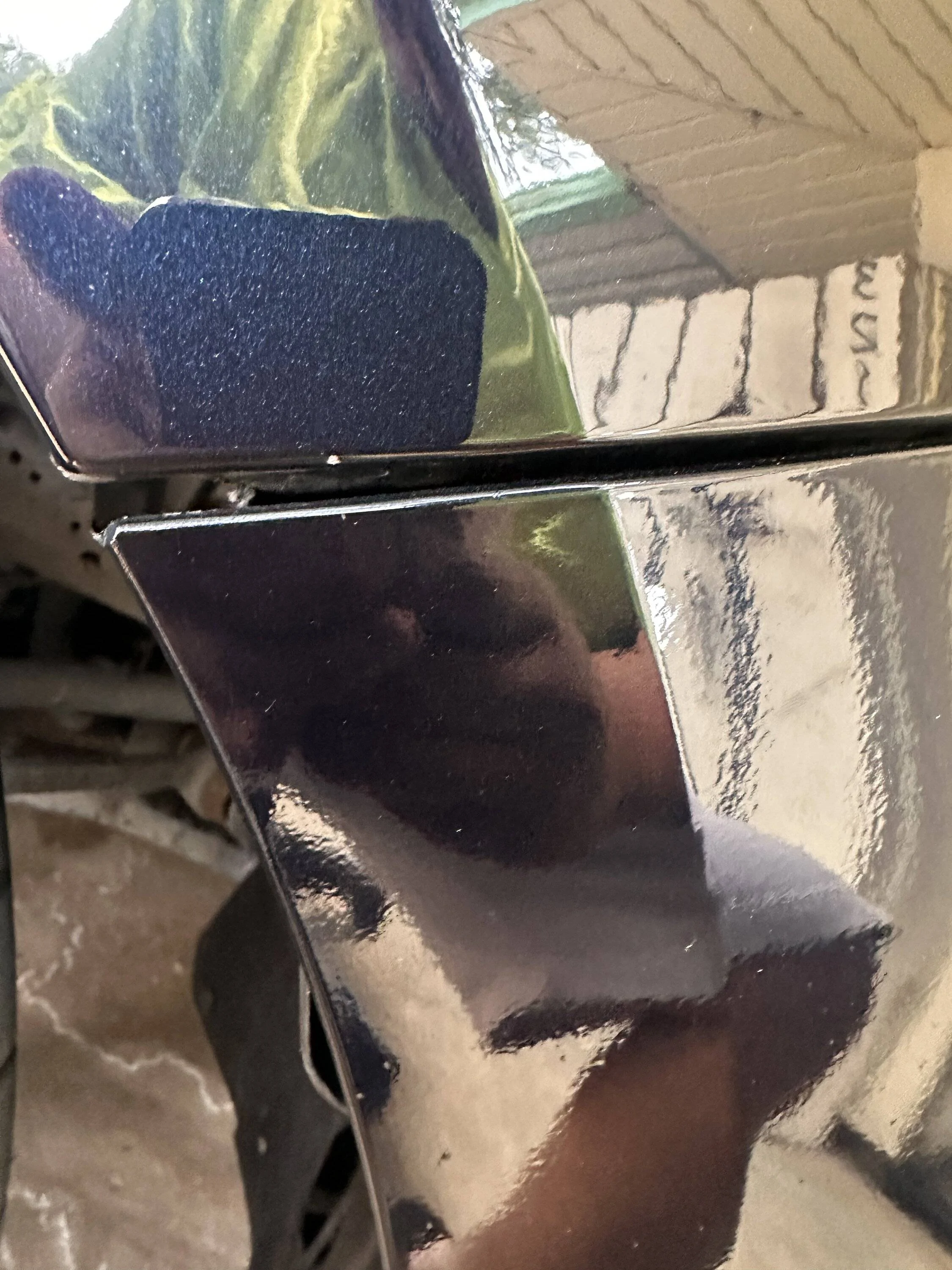

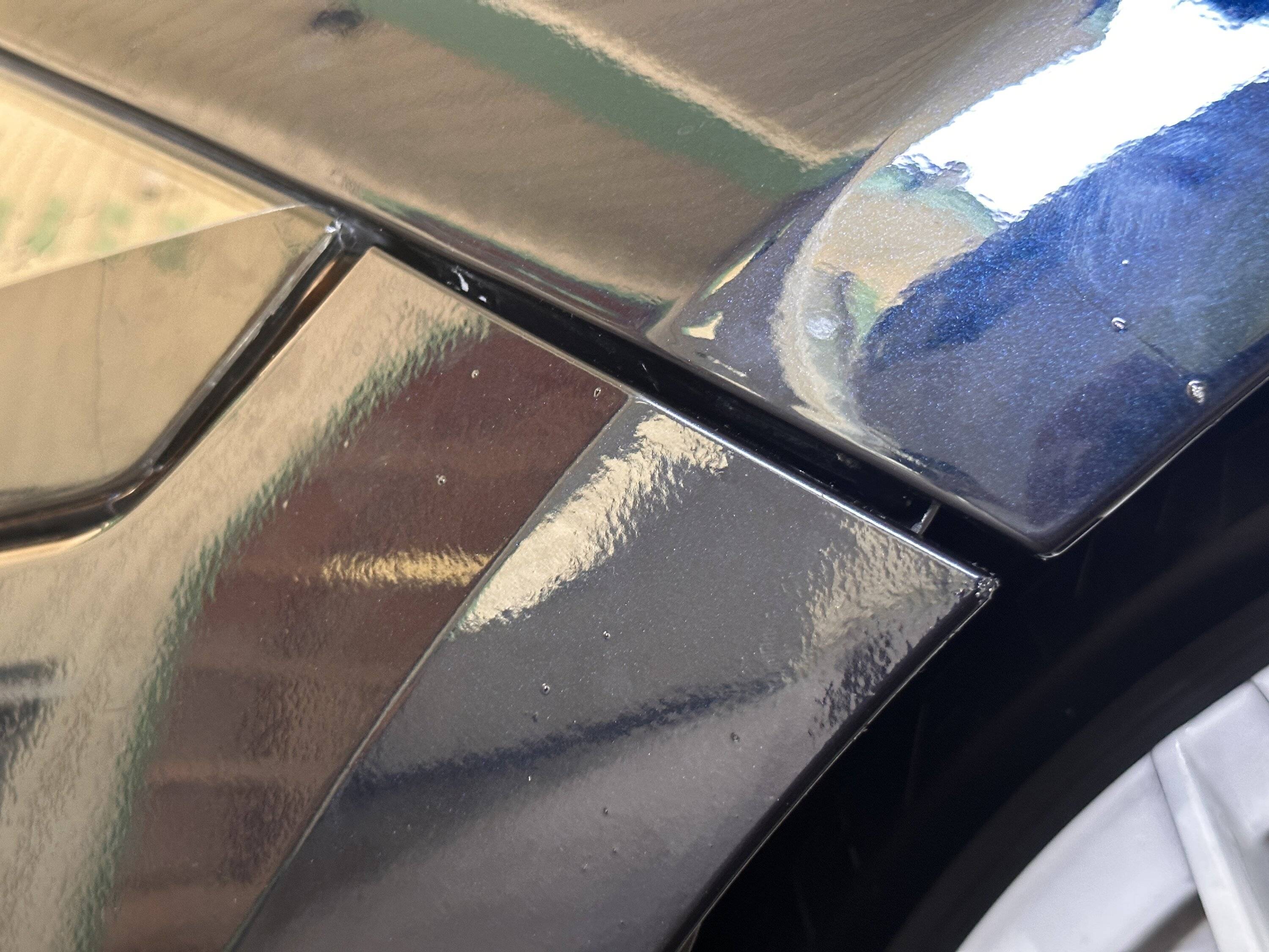

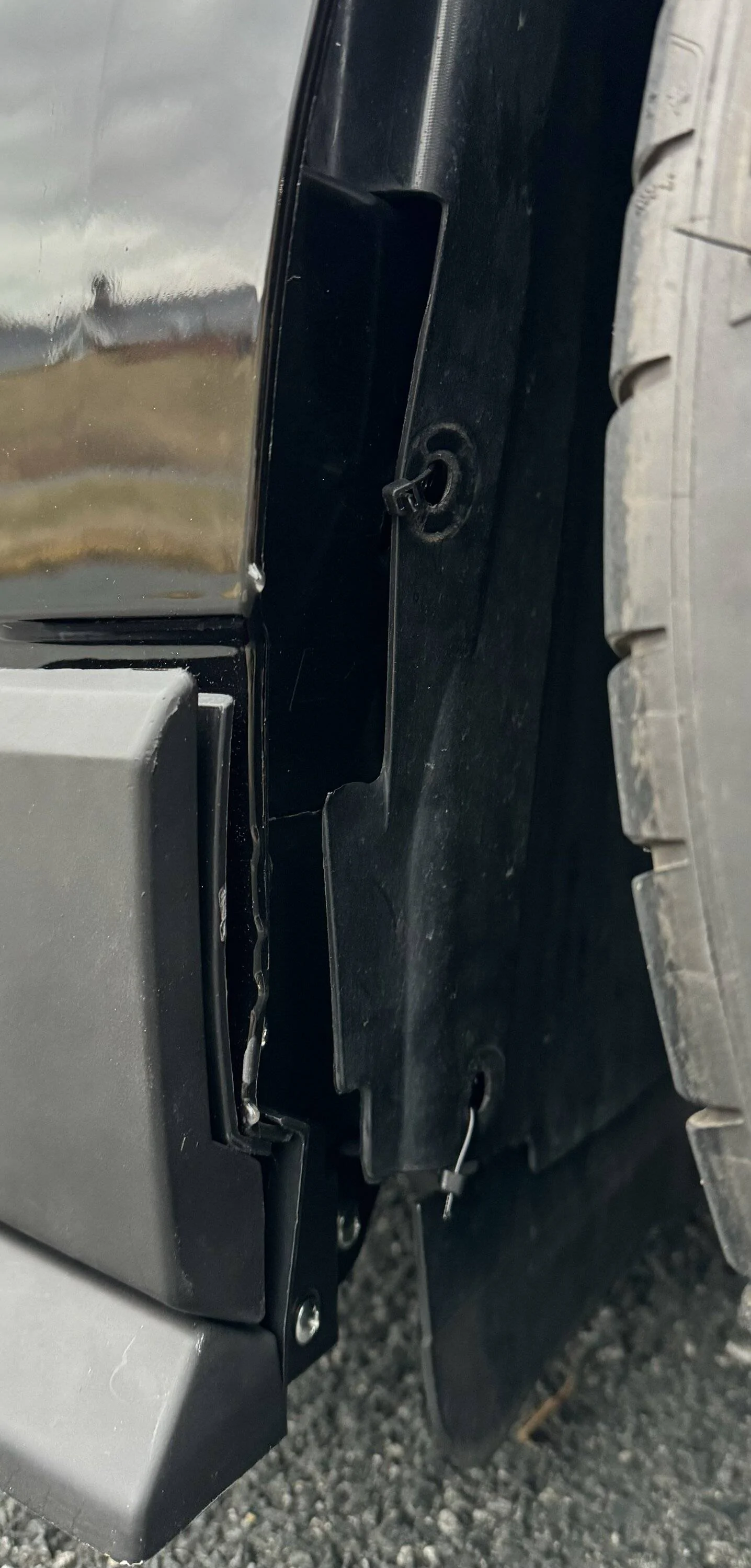

yeah! i’m having a bit of fitment issues with my replacement bumper. originally bought one bumper and had a speed related incident where the lower splitter exited the chat and took with it the lower plastic or the bumper so has to get a replacement. ordered a whole new kit since 777P didn’t have the replacement parts available. got the new bumper and i got these pretty huge gaps on the side where the bumper meets the fender. nothing changed on the car so my body shop isn’t sure why it’s not fitting correctly. all the brackets are right bumper sits where it’s supposed to up front, just the gaps on the side. 777P says bumper is fine so we’re at a loss too.

hahaha no, valid question, but it is a 2018+ bumper. here are the gaps in question.

I did read somewhere that you aren't supposed to put those little fender brackets back the OEM way; You're supposed to flip them upside down and come in from the top, attaching the nuts from the bottom... left should stay on left, and right on right.
Was that done?

oh wow. no was not done. i’ll try it tomorrow. what’s funny is that wasn’t even mentioned by 777P when i emailed them about it.

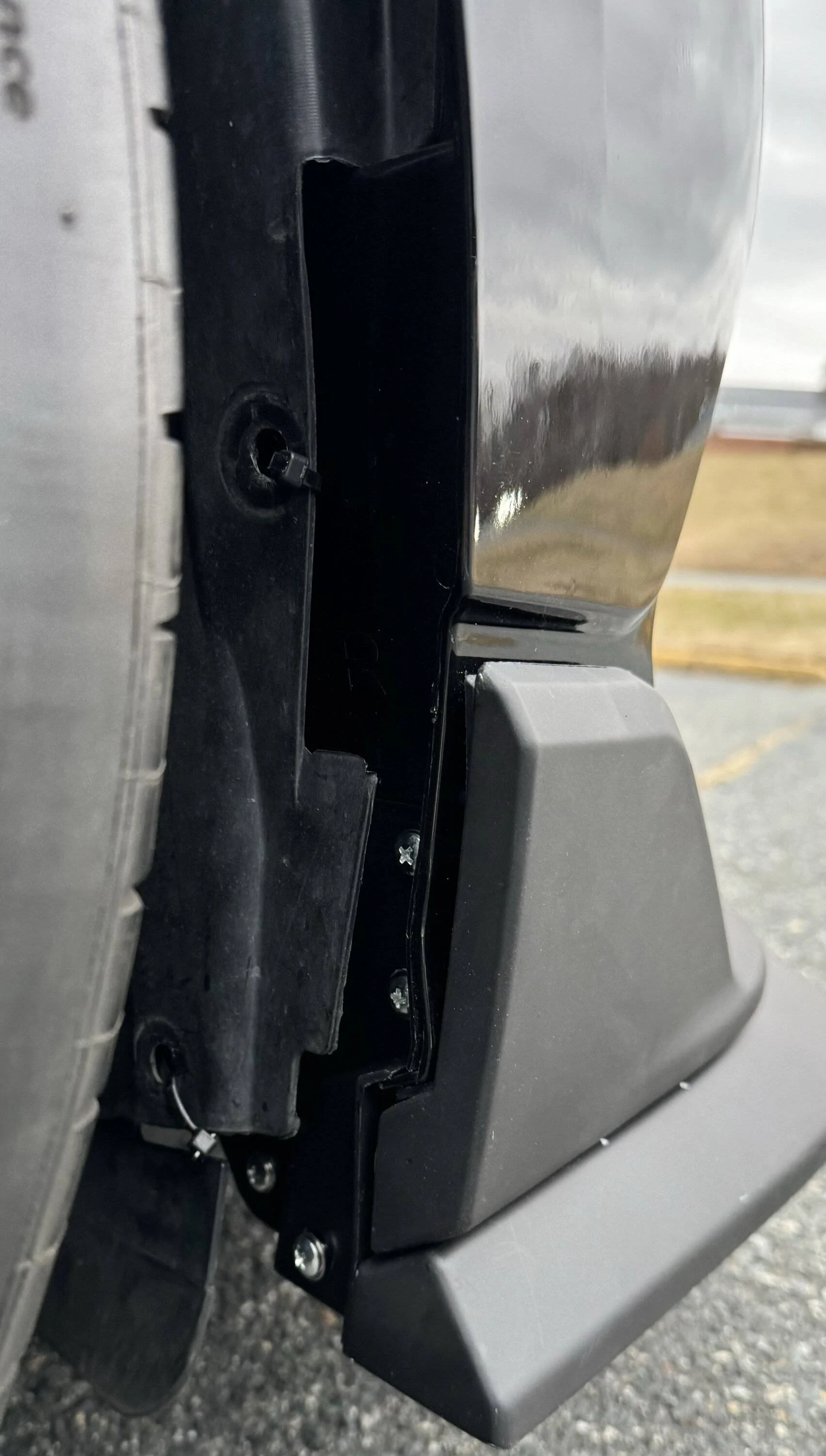

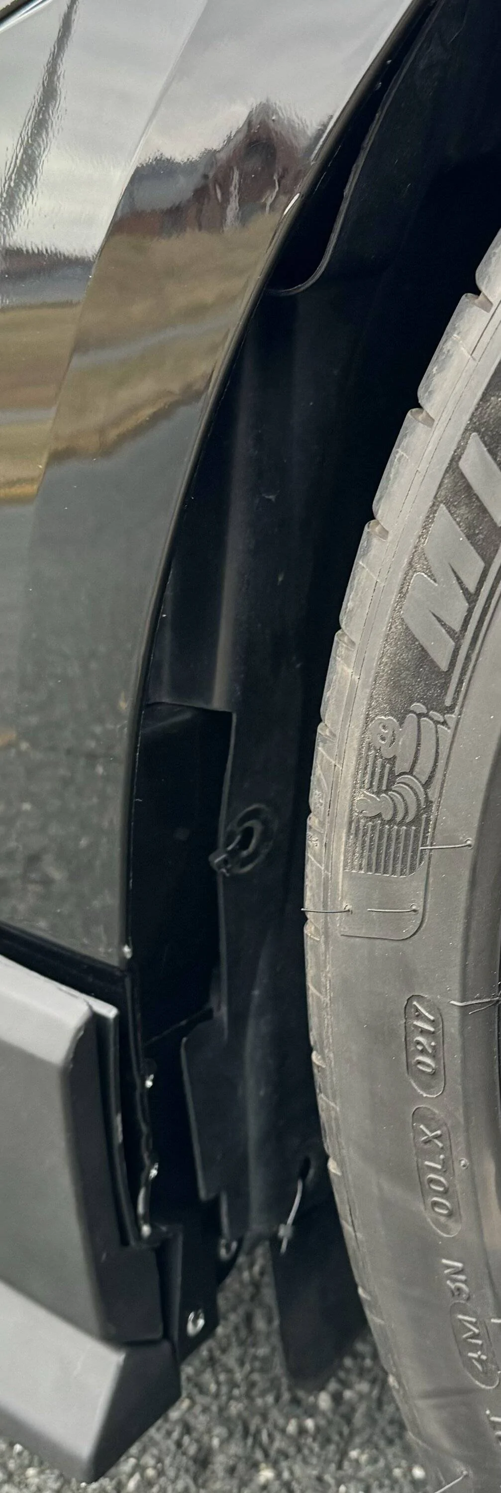

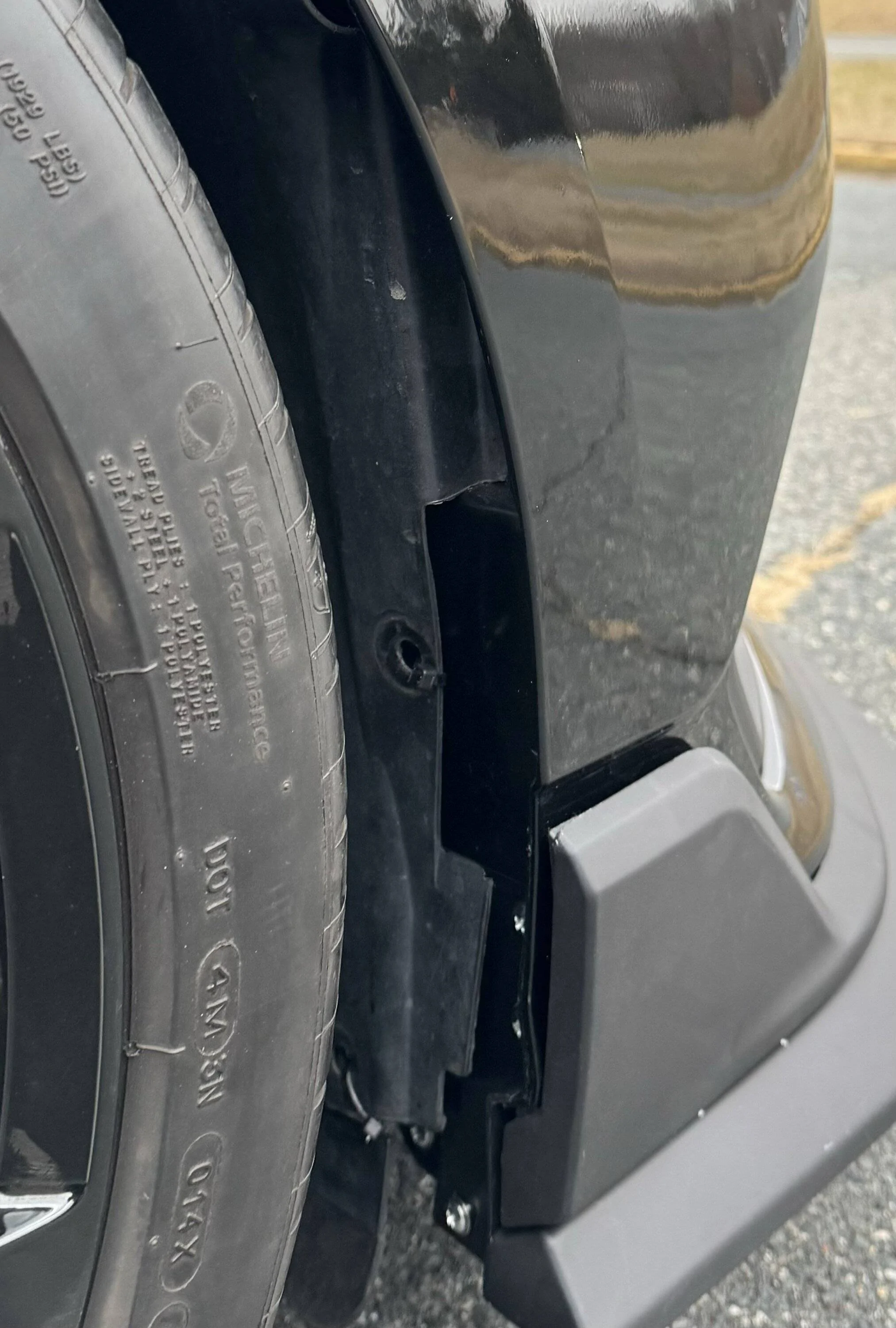

Hi guys, what does your fender liner look like after install? I had fitment issues and it didn’t really line up smoothly or was even flat against the car. I ended up using zip ties
BLACKMACH1NE
Aug 24, 2022
48
South East Virginia
2022 GT Premium PP1
Did you come up with a solution for this? Did you have any issues/fixes for the belly pan?
