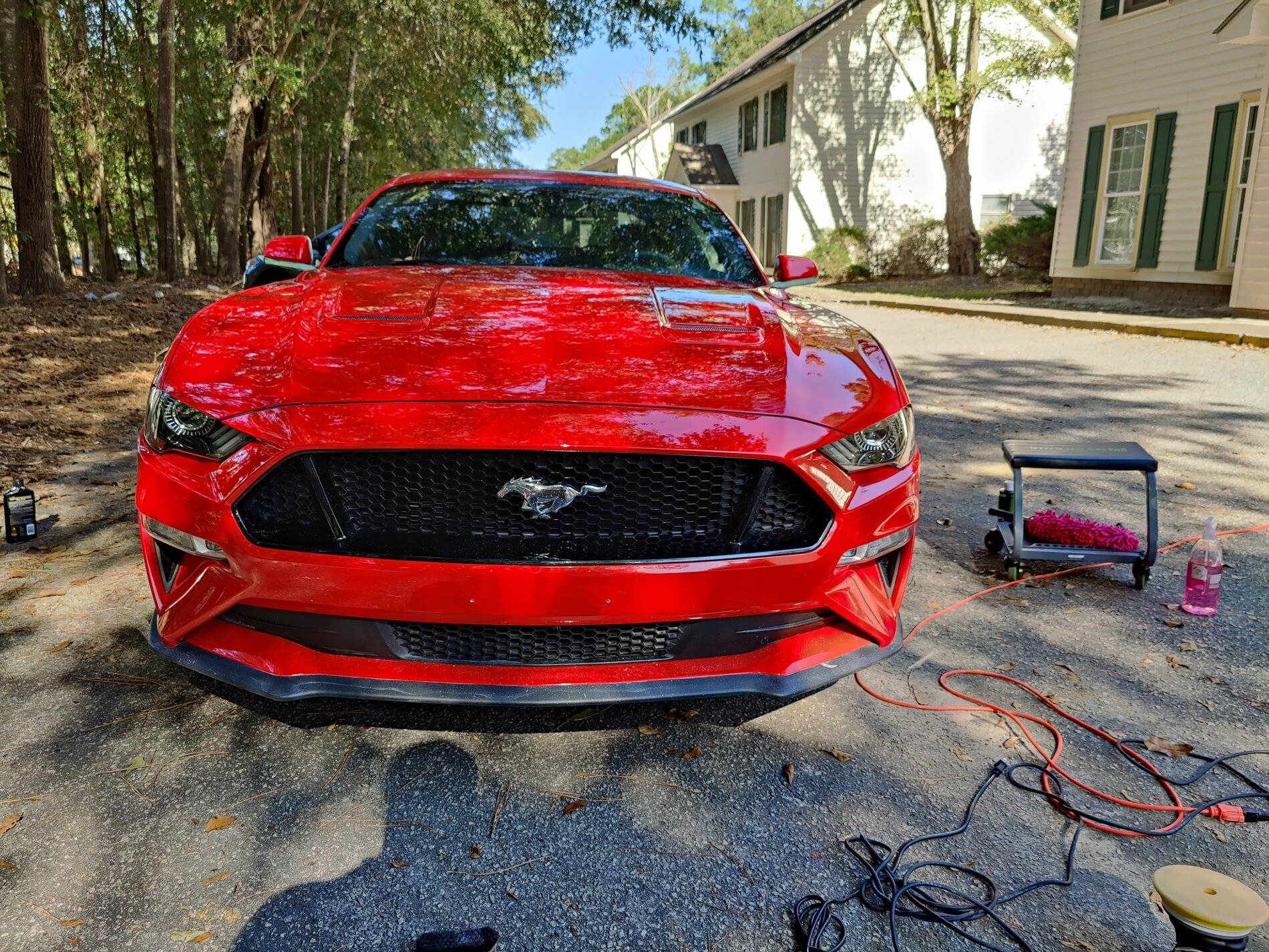

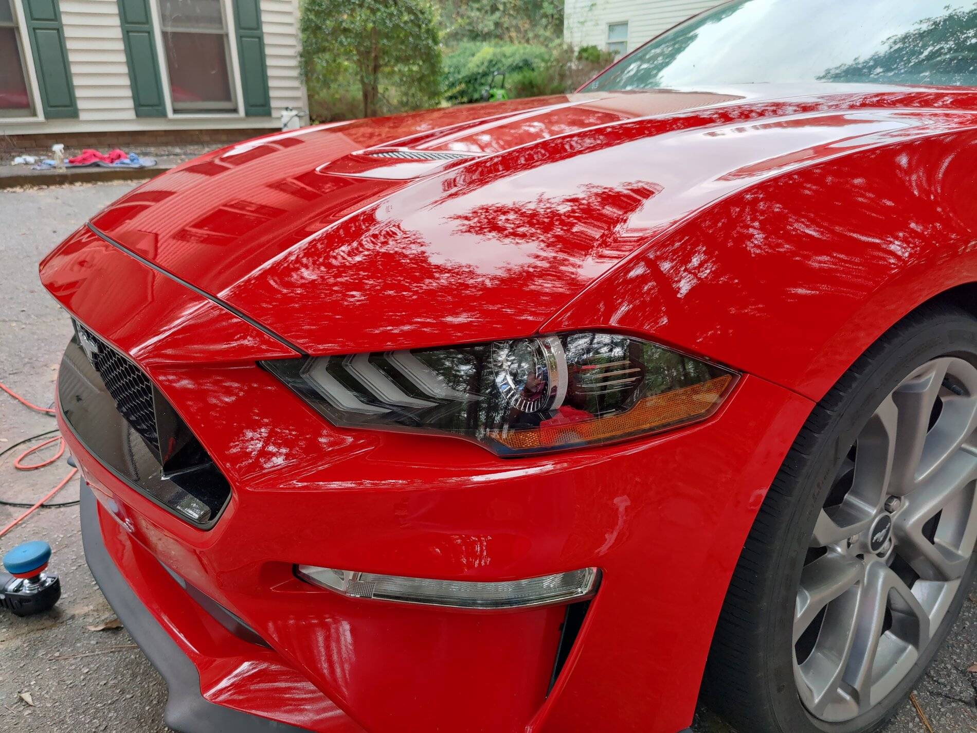

I spent my Saturday paint correcting the front-half of my car. I used Polishers for the first time during this process. A Rupes Duetto, and an SPTA 3" Orbital Polisher. The paint was full of swirls, scratches etching, and water spots. When I got the car in spring, (used), I saw the paint, and I knew I could clean it up. Unfortunately, it would be months before I had the time to perform a paint correction on this level. Whether it was work, the weather, outside tempurature, and unfortunately, Covid a few weeks ago, I was determined to get this car "Dialed in".
I performed the typical steps to wash and remove any wax and protectants from the paint. I did not Clay the car this time around, as the Chemical Reaction from my bottle of Gyeon Iron did not show any purple streaks throughout the body of the car. Plus the paint was smooth to the touch throughout the body of the car. However, I did take a microfiber towel and wiped the car down while Gyeon Iron was still on the car. Then I washed it off. I found this to be a much improved way to chemical decontaminate the car, plus more dirt was removed from the paint as well. Used Gyeon Prep to wipe off any lingering chemicals,waxes, and protectants on the car (I love the smell of that stuff).
It was very intimidating at first, as I walked around the car with my Paint Thickness guage, and discovered some crazy numbers on the rear driver-side quarter panel. My goal was to at least get the Front-end of the car Compounded, Polished, and Protected. I'm going to follow up on the obvious paint job done to the quarter panel, as the thickness of the paint was literally 3 times the average of what I was finding around the the rest of the car.
Made my test spots on the hood of the car. I had a couple of Rupes Yellow, and Blue Pads, Mequires Ultimate Compound, Rupes DA Fine (Yellow label), and Sonax Perfect Finish. I found the Rupes 5" Yellow pad and the Mequires Ultimate Compound produced the best cut with less haze. So I stuck with that combination throughout the process. I have a couple of 3" Rupes Yellow, Blue, and White DA Pads, but (due to my lack of knowledge regarding DA and Orbital Polishers) I stuck with the SPTA equivalent pads. And I'll just say, those pads are horrible. Two of those cheap pads almost disintergrated as I was cleaning them with a brush. Not the case with the Rupes Pads.
Watching some of my favorite Car Detaling Youtube channels, one of the common suggestions, was to not chase after perfection. Running the risk was damaging your clear coat while chasing a small scratch is simply not worth it. Plus taking into consideration the car's purpose: Is it a Garage Queen or a Daily Driver, are you a professional Detailer, or a Weekend Warrior such as myself?
I will say, for a first-time user of both a DA and Orbital Polisher, I was more than content with the results. I will work on the rear half of the car next weekend. I'm just worried about that rear quarter panel.
It's Sunday, so I'm going to Polish, and add a Jescar Powerlock as a Sealant.

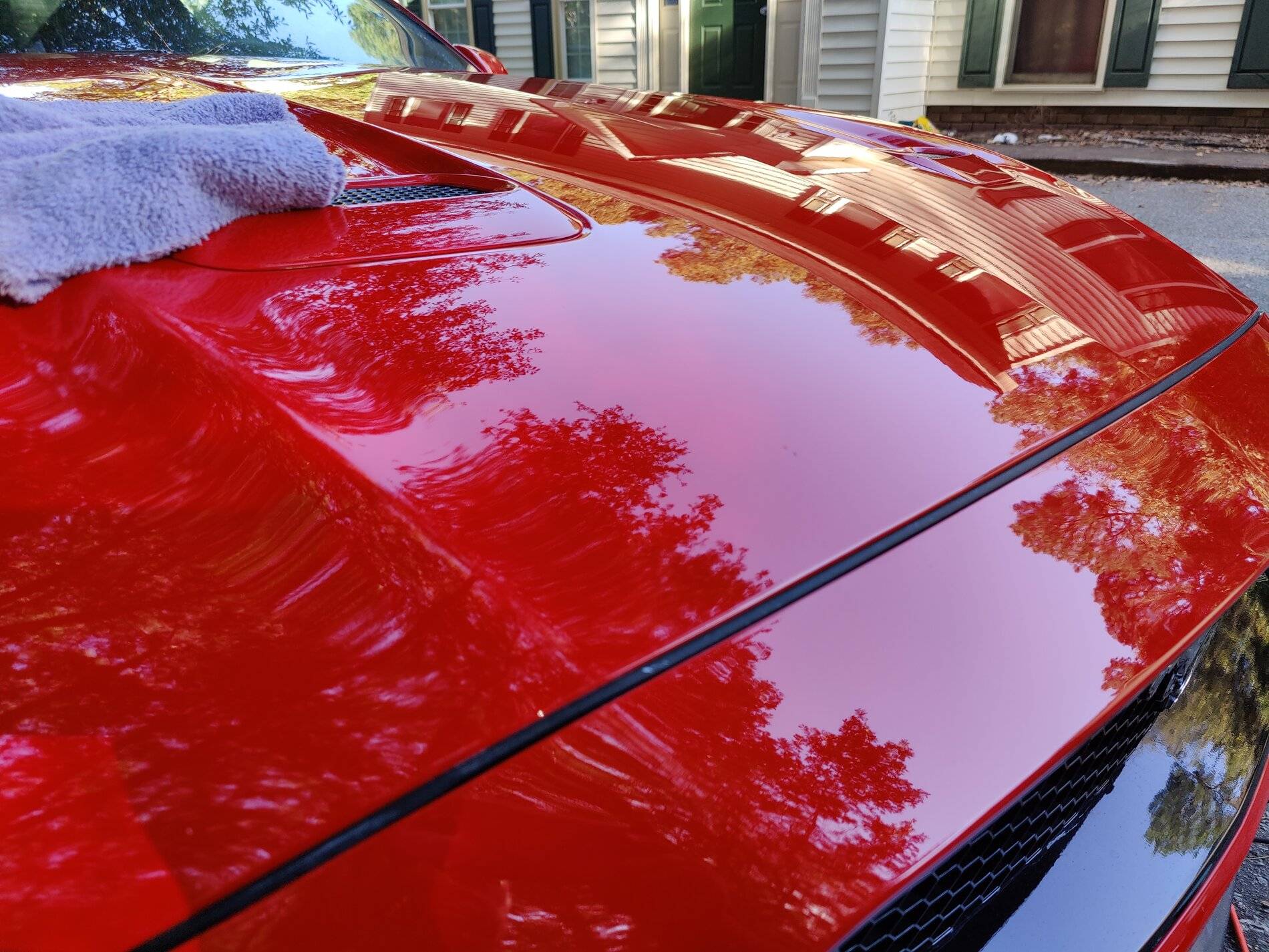

Excellent report Jay and you've shown that a newbie can polish a clear coat, dramatically improving the clarity and gloss, without having any problems. Well done.
As for the triple paint thickness, seems like the vehicle had to have been repainted for some reason somewhere along the road as I simply can't imagine the factory doing that.
Good luck on the rest of the vehicle and I hope you find time before Winter.

Total time was approximately 9 hours for only the front end of the car.
Day 1
Pre Wash with Traffic Film Remover (concoction), and Gyeon Foam
Full Wash with Chemical Guys Clean Slate plus the Concoction
Gyeon Iron, wipe down after spraying the car, no Claying needed
Drying
Gyeon Prep and Concoction to ensure no wax or sealants were on the paint
Compound with Rupes Yellow Pads and Meguires Ultimate Compound
Day2
Pre Wipe with Gyeon Prep
Rupes Yellow Pads and Sonax Perfect Finish
Found 2 deep scratches on the hood, so I tried the Rupes Blue Course Pad with Sonax, and Rupes Yellow DA Fine. I didn't want to get too aggressive with the polishing, and I had some minor improvements.
Another Wipe down with Gyeon Prep to get allof the polishing residue off of the paint.
Jescar Power Lock applied with Rupes White Ultra Fine Pad
Allowed to let sit on the paint for 30 minutes then removed with a microfiber towel.
The Paint is very slick now. Gloss and a much richer deeper Red.
I should be able to do the rest of the car next week with not a lot of prepping involved.
