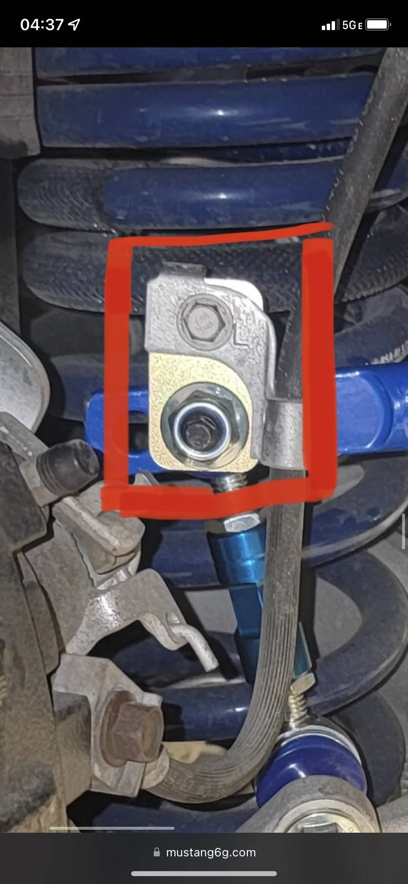

I installed the FP track kit and the stock rear brake line bracket does not mount to the FP sway bar that comes with the kit
Someone on this forum was nice enough to show me their aftermarket bracket (completely flat) that they said came with their FP track kit.
Ford says it doesn’t come with the kit (anymore?)
Does anyone have any idea what the part number for this is????

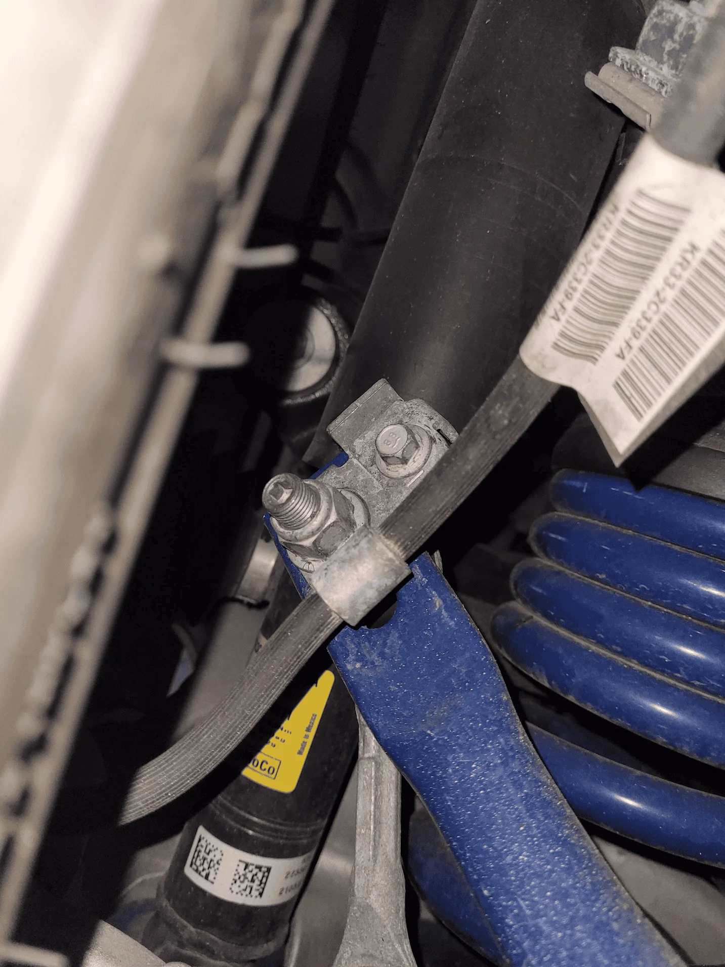

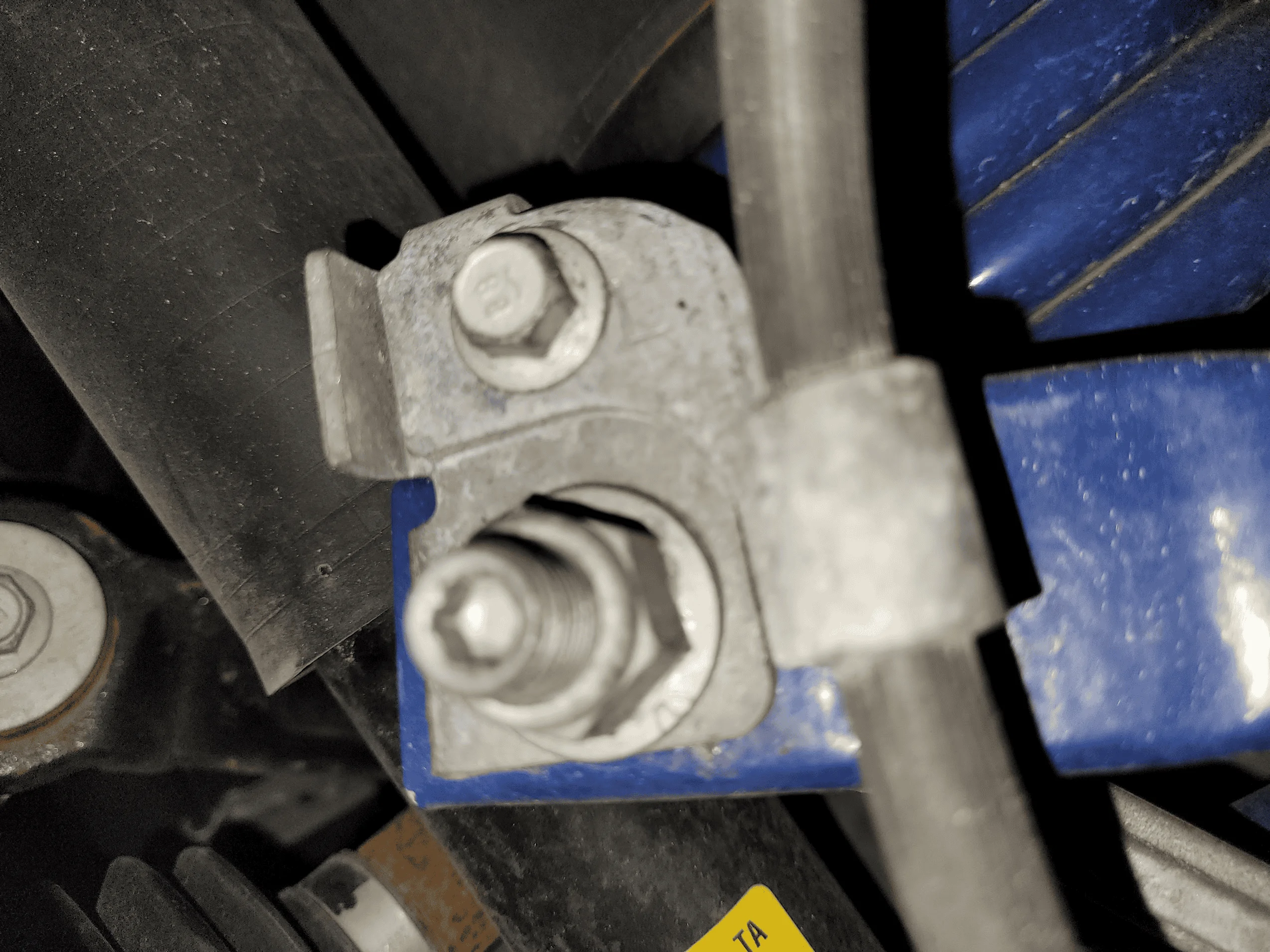

@TrackMustang - let me take off the wheel later today and will share how dealership installed this on mine, if that helps. this is the best I could do by climbing under the car, but you cannot actually see the side you're interested in, I'll try to get better pics and share with you:

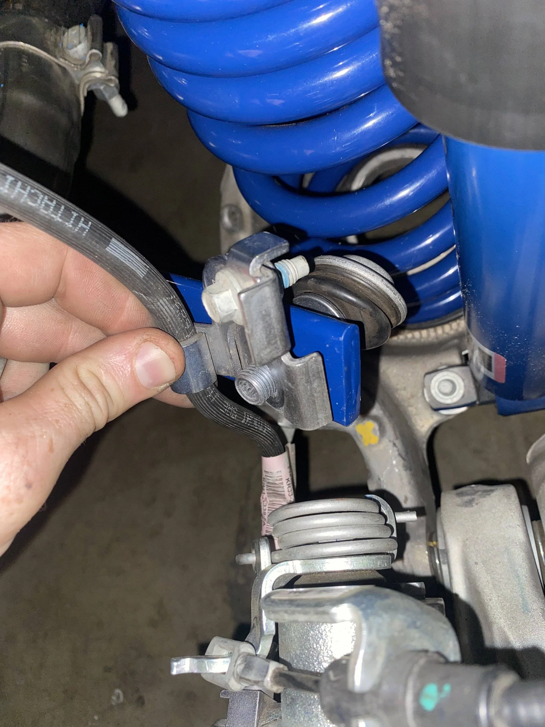

I did this kit, if I remember correctly I flipped the bracket up side down...

Looks like I’ll either see it Steeda will sell me the bracket or just flip it upside down if that’s what it takes. Thank you all for the help!
