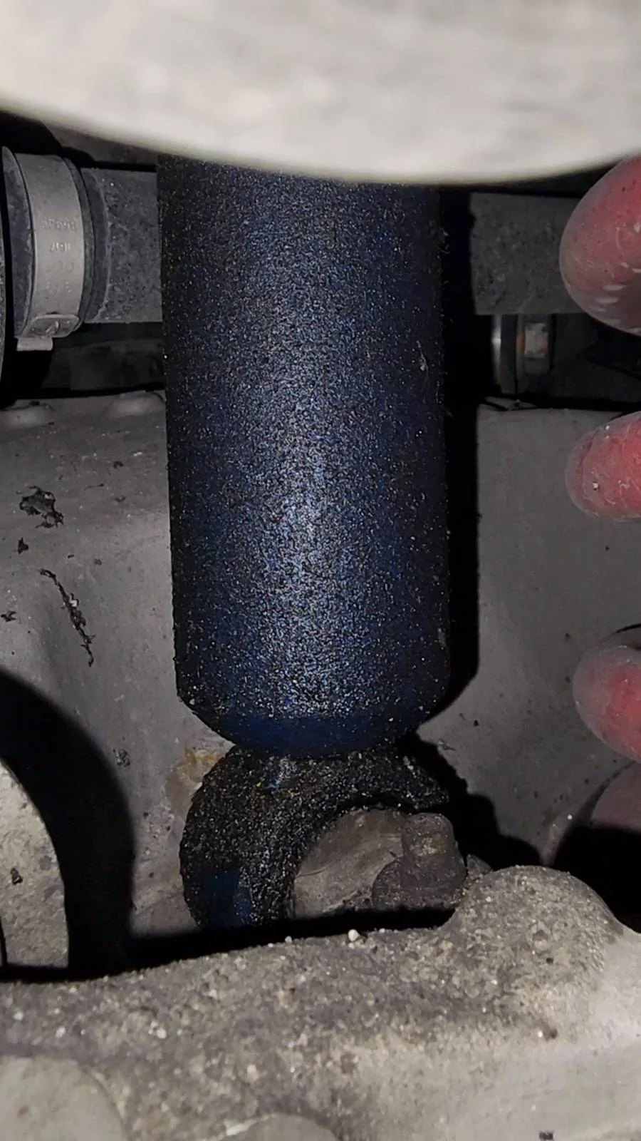

I got a creaking noise in the rear driver side when at low speed and worse on bumps. I checked the suspension to reproduce the noise but I couldn't. Was the shock leaked here? Only in the driver side, the passenger side is dry.

The thing is I don't feel anything different in the handling. Got ford racing shocks with bmr handling springs. I just have creaking noise for example going reverse on an inclined driveway or in parking lot with really low speed or on speed bumps. I don't even know if it's the shock or something else. I guess need to replace it to see first.
shadowx
Feb 8, 2020
195
55
Missouri
mustang gt premium 2019
Update: I just replaced the shock a few days ago. The shock isn't the cause of the creaking noise because I still have it.
shadowx
Feb 8, 2020
195
55
Missouri
Update: the new one leaked too with less than 5k miles. Thinking to switch to bilstein

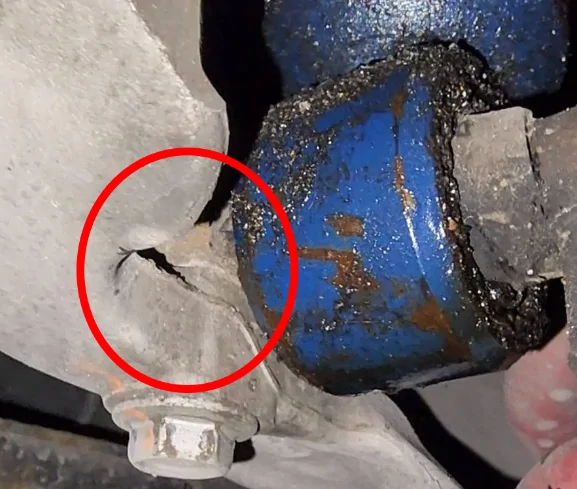

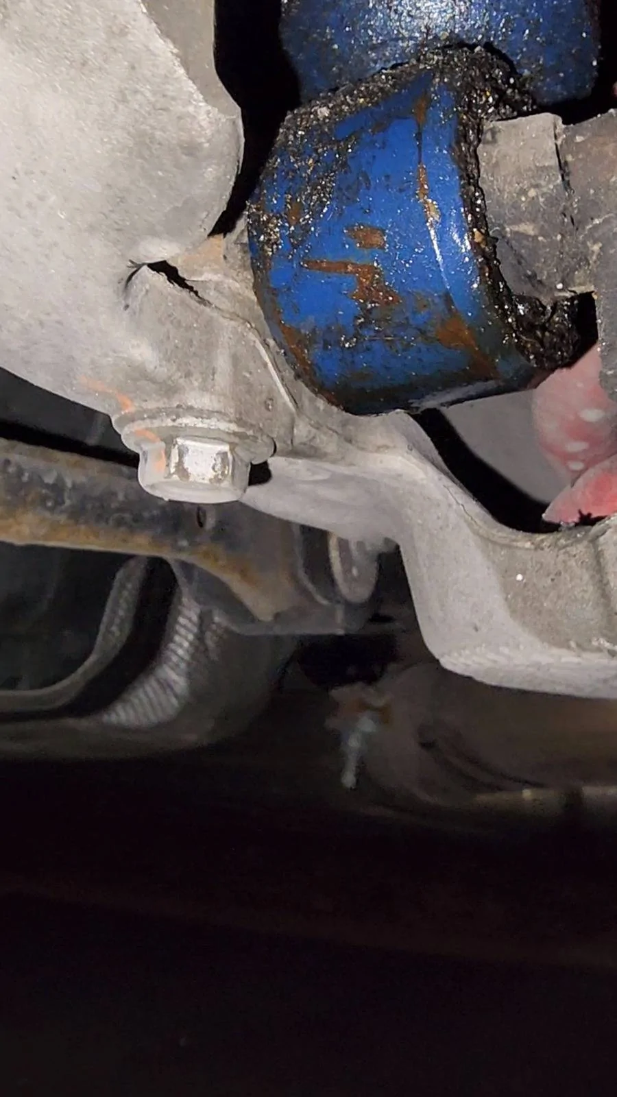

Is this a crack?
