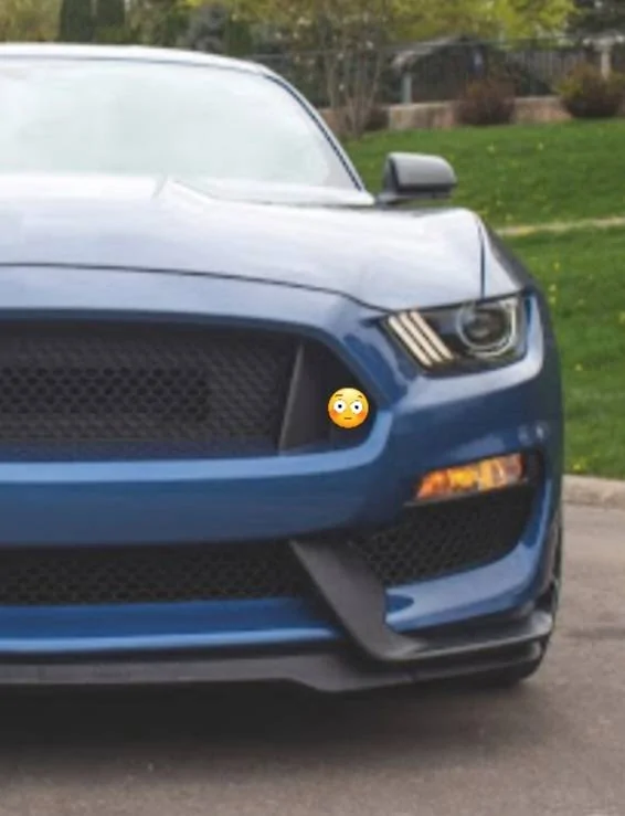

I guess I never really paid much attention but this is our air inlet. Just imagine getting a plastic bag or a leaf stuck in the inlet while on the freeway. Your heart would drop thinking you just lost your motor.

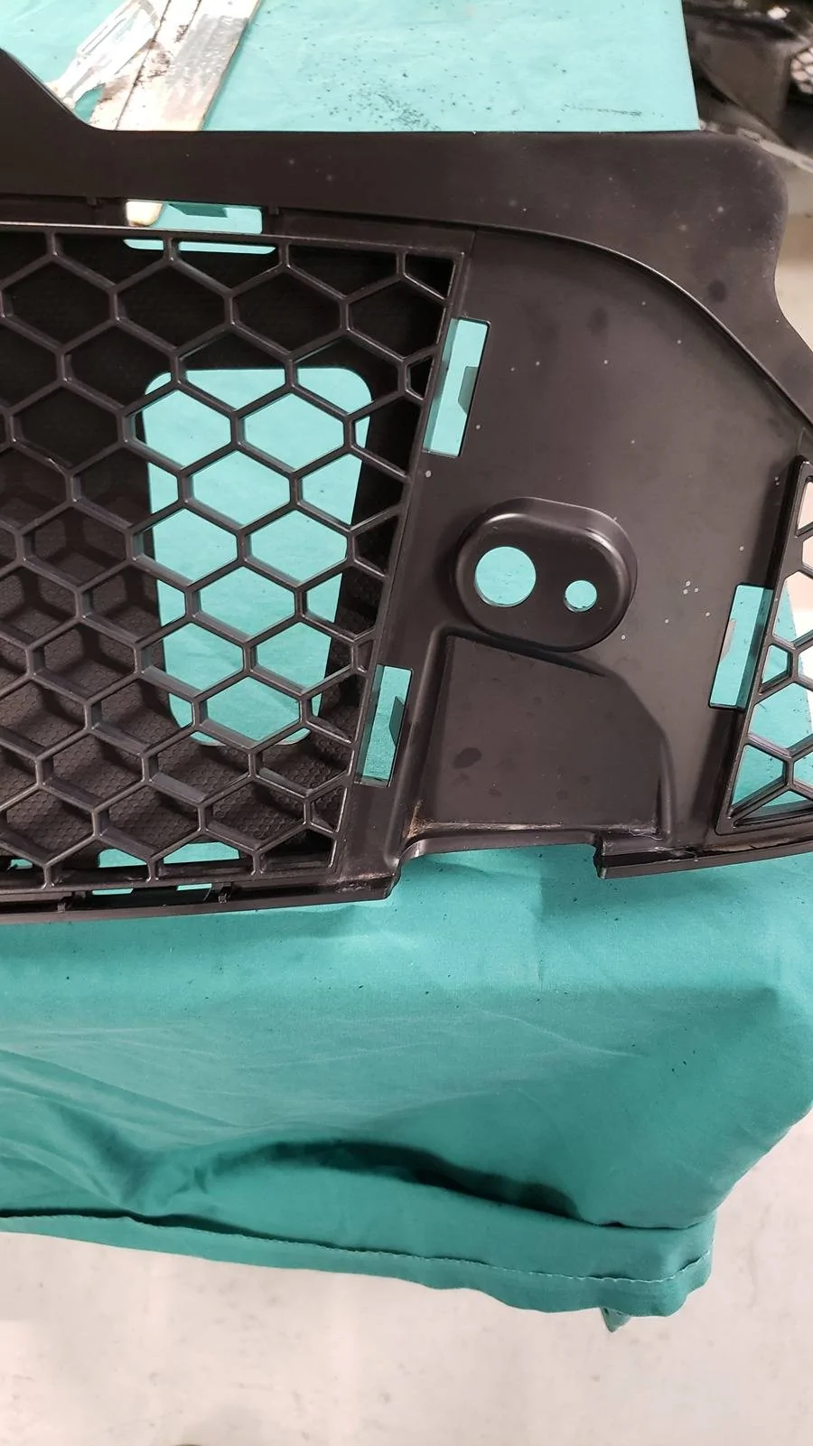

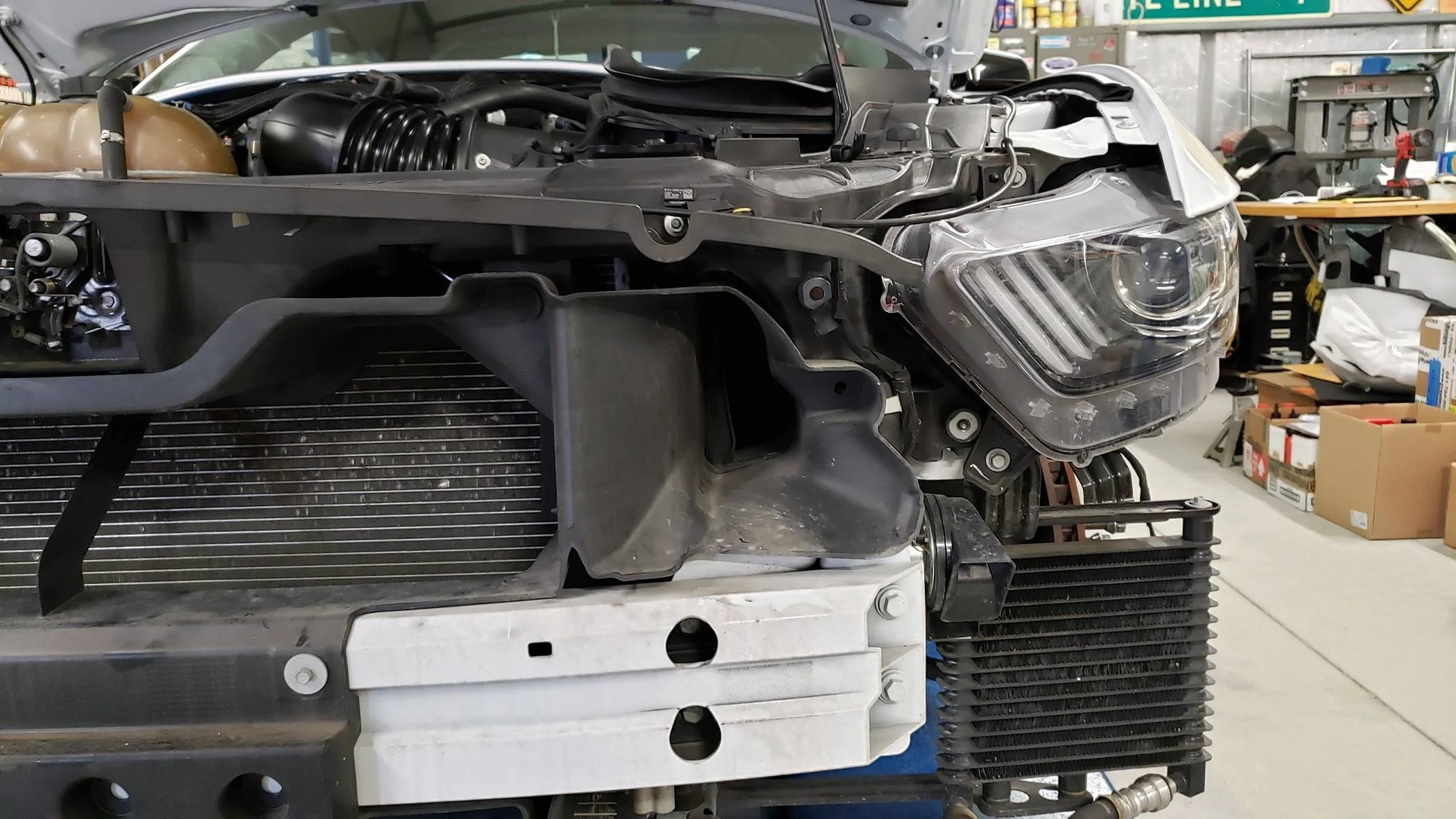

It's actually much bigger behind the grill - that's just the portion that is visible. If that small area were to become blocked, the area behind the grill would still allow airflow, just not direct cold air "ram" effect.
Some of us have opened the grill to expose more of the inlet funnel (hat tip to @Epiphany.... that's his bumper cover in the bottom photo which shows the additional open area better due to the natural light behind it).

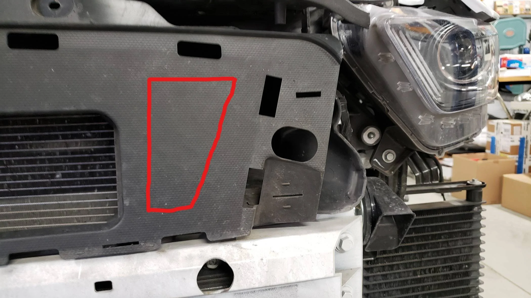

You cut the rectangle out?
Yep - here's a "before" pic.... the second pic above is the "after" shot.
The red is just on the pic to represent the area that was cut out - it was not on the actual part.
Compare to your pic in the OP and you'll see the blank area.

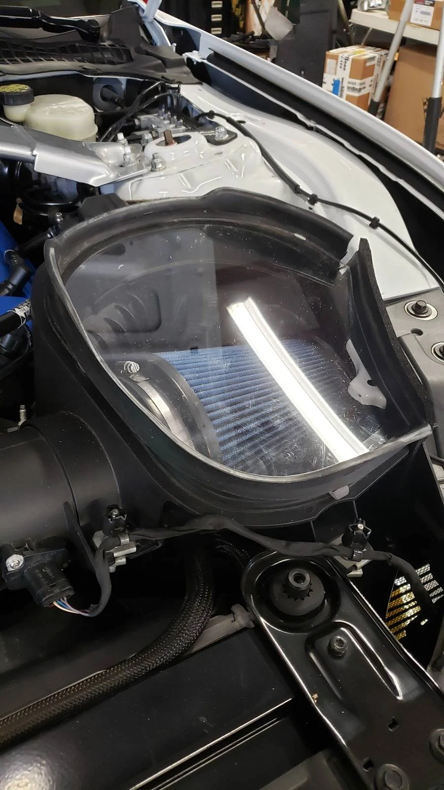

Well, I also fabricated a cover for my air box and need to revise it to actually bolt it down. The force of air into the box is such that it is pushing the lid up off it's mounting point.
While I realize that the intake and throttle body can only take in so much air, it appears that the airbox is certainly getting a surplus, so the engine has all it needs..... and it's all cool air from the front of the car.

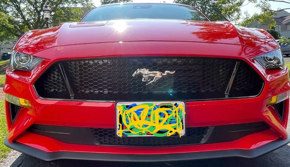

This is a 2023 GT, there appears to be a large open area, but I may be mistaken, I am going by this photo only, correct me if I am wrong.
526 HRSE
526 HRSE
Jun 4, 2020
1,664
1,909
California
2017 GT350 Grabber Blue
On the 350, it's literally only where the emoji is. Maybe the same on a Mustang?
