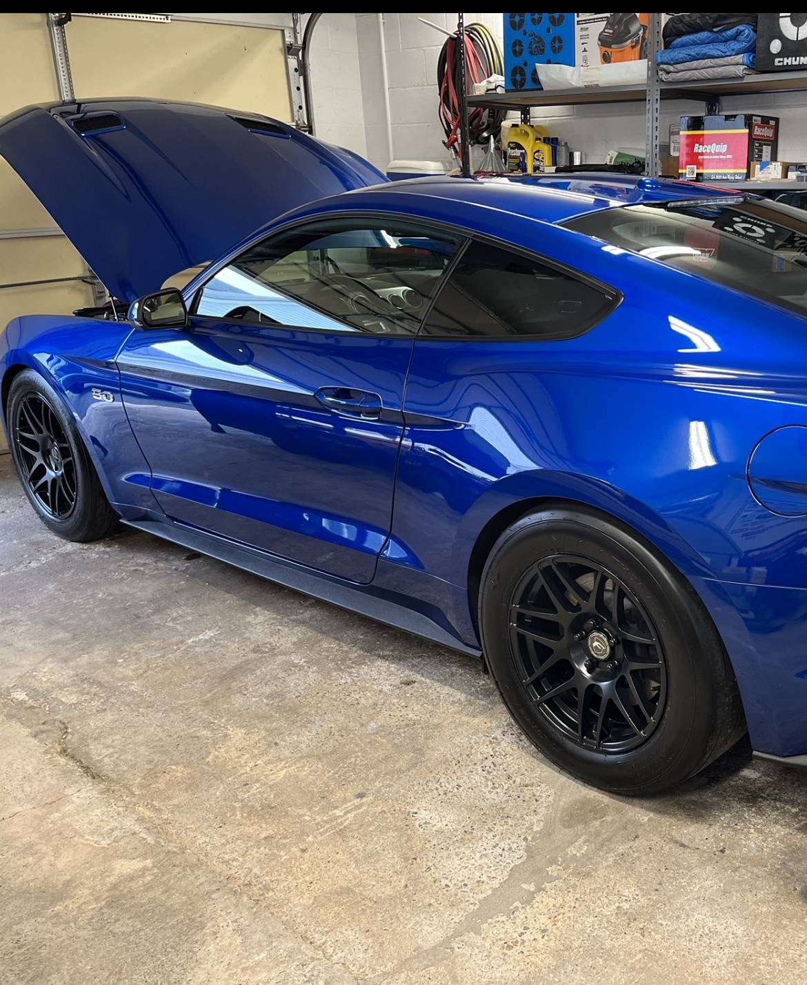

Anyone have any idea if the forgestar F14 17x10 +50 offset 7.5inch backspacing will fit a stock S550?

Yes, that’s what I’m running at the track. They fit perfect!

Wrong specs! It’s 17x10.5 +57 offset anyone run these?

I’m running the 19’s with similar backspacing. I have to assume that your set up will fit fine.
edit: if I would just read further down….
my wheels are both wider and with a slight bit less offset and they fit fine. I think you’ll likely be fine.

Nice, looks great. Love the colour too.
post some more pics if you got them
