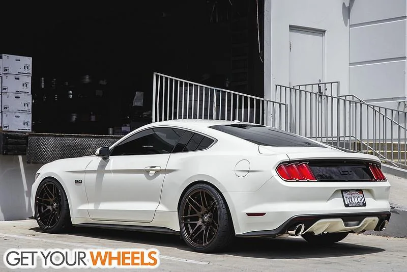

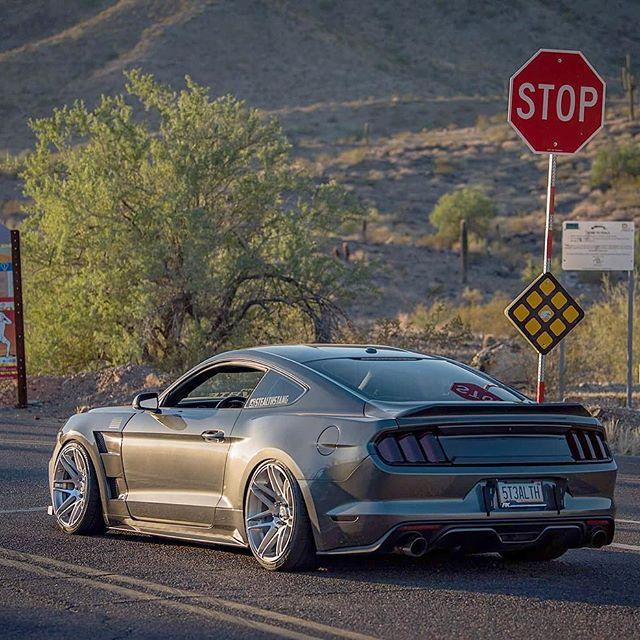

I am looking to get wheels for my new to me '17 GT and I have had my eyes on Forgestar F14s.
I love the super deep concave look on the rear wheels but I have not had any luck finding any examples of them on a S550. I went through the aggressive wheel mega thread on here trying to find offsets that correlated with the Forgestars but it seems like anything close requires quite a bit of negative camber which I want to avoid.
Has anyone fit these or know anyone who has?
A side note, I will either drop the car .5 inches or keep it stock height.
Here are the offsets available per their website for 19's and 20's.
