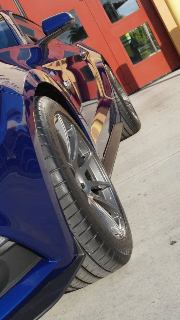

Right hehe..i got the shoes for me part covered, lets concentrate on the shoes for her:
Nice color choice on the car. Pic looks too artificial & grainy though IMO.
These cars can take some very wide setups front and back, just a matter of offset as others have said. No real need to go past 10" though, especially on a street driven eb. Plus if you go too wide with the tires in front you can run into problems like tramlining. You also reduce hydroplaning resistance, increase rolling resistance, and add more rotational mass. I think they max you should go up front is a 285 tire on a 9.5-10" wide wheel.
Yeah thats a cell phone pic, wanted to show my friend my
Tripple waxed finish hehe.

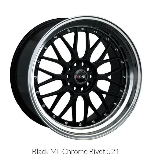

I love the look of those wheels, too. It's a very classic timeless look. The Polished lip with classic BBS-type mesh center. Unfortunately those XXR wheels kinda have a bad rap for being low quality and having poor offsets for our cars. However, I have seen them run in both 18's and 20's on these cars. I will try to find a pic of the guy with the 20's I think it looked great.

Couldn't find pics on 2015's but those XXR;s look great on these older gens:

Yeah the xxrs do have a very bad reputation, but hey at a buck 80 per wheel its almost to be expected. Anyway i keep coming back to this look. Bbs, work, chicanes, strauss, i forged, they all have them. But theyre either over 1k per wheel or the sizes are not up to snuff.
