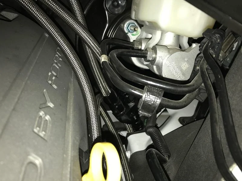

Hey All,
Those of you with fuel systems with the fuel rails run in parallel, where did you place the "Y" for the feed? Can anyone provide a picture of where you did?

My single feed comes into the engine bay down under the brake booster, and the Y is right there. I've seen some people put it under the car, but then you have another whole line you have to fit through those areas going into the engine bay.
Mine has been good so far. I'll try to get some pics later (car is at home).

That would be awesome! Do you have it attached to anything?

Nope. The steel braided lines on either side don't let it move much or at all. I think I put some rubber tape on one side of the Y fitting itself where it could occasionally bump into the brake booster. But, for sure it cannot flop around; the line going from the Y to the LH rail is fairly short (very rigid) and the main feed on the other side is anchored not too far away.

Sorry for the delay. This is about as good a shot as I could get of the Y. It's way back in there.

Seems like the easier way to do it

I put mine under the car like another member on here. I will try to get you pics later today. It all fit under the cover.
