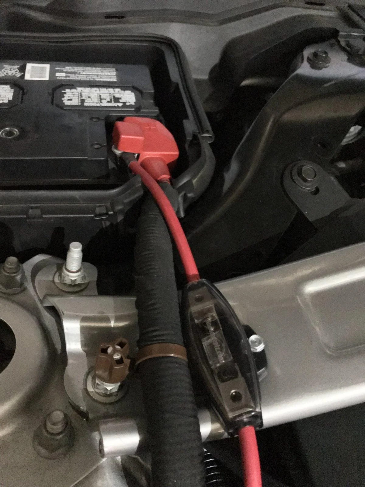

I have come to realize that I have a slow drain on my battery when my car sits for extended periods( about a week and a half). I am wondering if my power wire for my fore kit being wired directly to the battery would be the cause of this and if so should I have wired it into the fuse panel?

So now I try to start my car after running it yesterday and I get 2 codes on my a P0339 and a U0415.

Is it not possible to wire it to ACC in the fuse box, that way when the start button is turned on it would turn on. There is an install video but it shows it wired directly to the battery.
I have seen them installed on one of the post closest to the batter in the fuse box. I replaced my battery which I think may have been the culprit and left everything hooked up the same so I will know something here in the next few days.

You having your power running directly to the battery should not have anything to do with a short. I have installed 8 or more of these kits, running them all the same way with no draw.

we always wire direct with 0 issue
