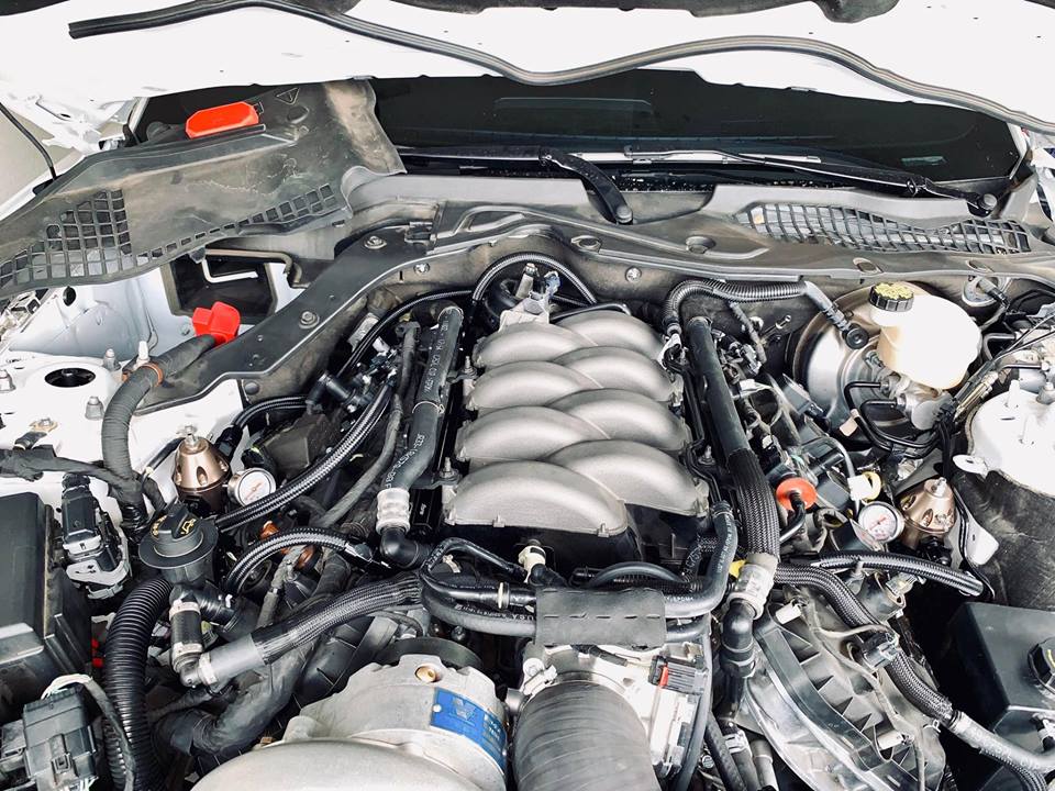

These are DW regulators, but still an example:

Nice!! I guess i havent seen any plumbing diagrams for the high pressure side so i need to figure out how that all will work.

Fore has a diagram for this but basically main feed to t block then 2 feeds out 1 into the hpfp and 1 into the side of the second regulator, from bottom of second regulator to pass rear of fuel rail loop the front then out the drivers rear rail to the side of first regulator then bottom return to tank. First regulator gets boost reference second regulator runs static.

That actually makes perfect sense. I was worried id have to pull the blower off to unscrew the fuel line supplying the direct injection. I will be really reloeved if i DONT have to do that just to add fuel return
