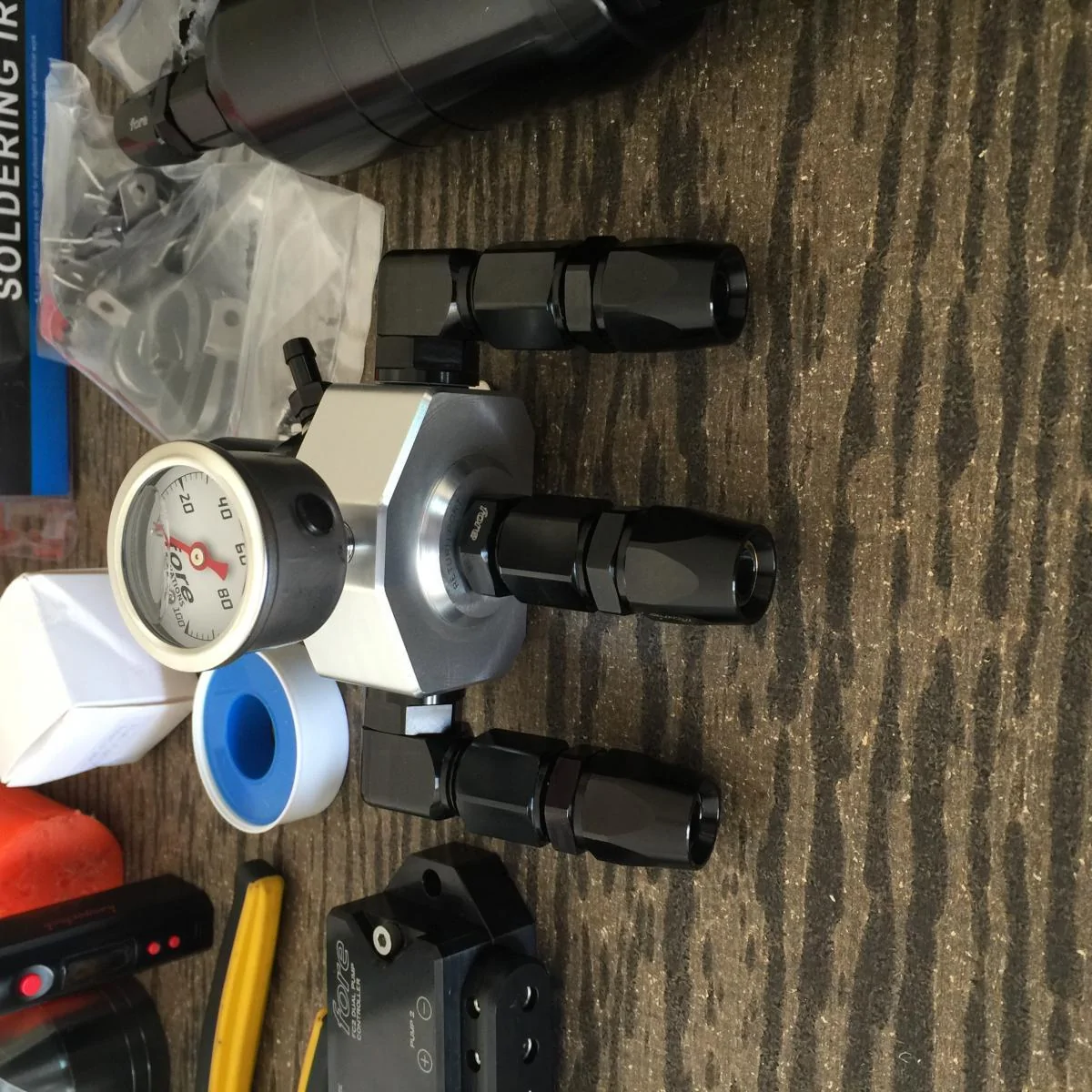

Getting started and trying to figure out the install. Not much for documentation out here.
Being that the OEM fuel rail only has one connection coming out of it, do I need to plug one of the two outputs on the regulator?
I'm assuming yes, but also assuming that it would have been accounted for since I ordered the stage 1 kit that utilizes the OEM rail.

On a stage one. You do to the regulator and return from the regulator and then feed to the stock rails

Would one be plugged or use both pressure ports to a Y to the rail?

all good :)
