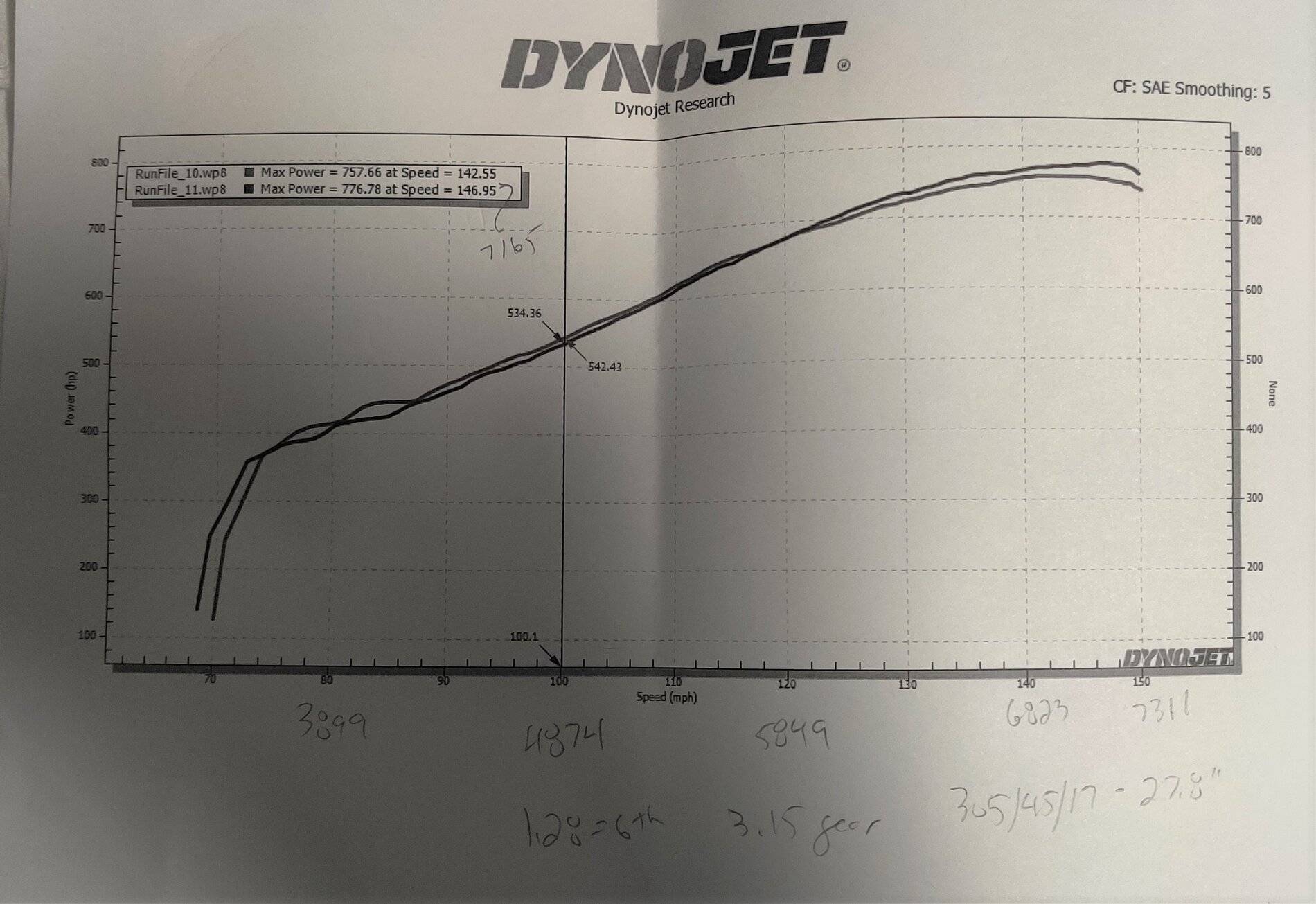

Added headers today, well I had them installed, TSP. I also added a magnaflow x pipe resonator in place of the factory to tame it some. I did keep the factory mufflers, goal was make more power but stay quiet. It actually seems to be about the same volume wise maybe quieter, though it sounds different. Not as raspy. I also added a box of dynomat (amazon equivalent) in the rear seat and trunk area this evening; in cockpit it is very tolerable, almost to quiet. I know adding weight doesn't make me faster, but I quit driving my last car because it was to damn loud.
So the dyno run, this was post header install, wanted a pre, but they didn't have time. I wasn't there, wish I was, also, it was done in 6th gear and is MPH instead of RPM. 776 at 147mph; which using an online rpm calculator is about 7200 rpm; not sure if he let off the gas or what. So maybe a little more left in it, who knows. Either way, I do have a 3.48 pulley in the mail,, which will likely be my final mod for normal operations, will dyno it again. Goal was low 10 high 9 car, this should get me there. Very happy with it and the install.
cbrtrx
Nov 23, 2014
33
970
645
tampa fl
2016 mustang gt
Nice numbers, you dynoed on drag radials? I've seen over a 30 rwhp loss at those power levels on the dyno with drag radials.
