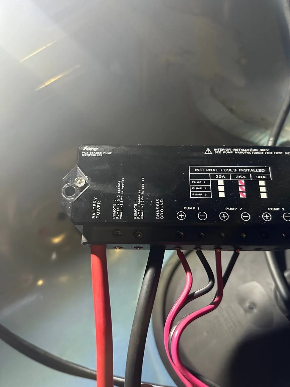

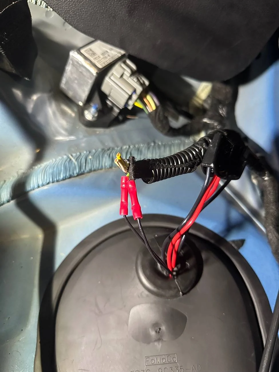

I’m looking for some info on the wiring for the FC3 controller. I currently have the yellow/purple and green wires from the factory connection that went to the top of the fuel hat connected to the black wires on the Fore hat. My question is with the remote connections on the FC3. If I want both of the pumps to run full time do I only run one remote wire?

For mine I personally split my trigger wire and sent it to both trigger one and two. I run both bumps full time. My buddy was smarter than me when he did his he just wired both pumps in spots 2 and 3 and then sent his trigger to trigger spot 2 to run both those pumps. Both have worked well for each of us, however his is easier id say.

You need to wire the pumps to positions 2&3 on the controller, and then a single trigger wire from the Yellow/Grey wire to the trigger terminal that says "remote 2, Pumps 2&3"

What Dax said ^^^^^
