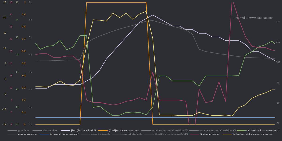

Your final drive increased. If your a non-pp stick you probably have a 3.31 if your an auto then 3.15. That's pretty tall final drive when combined with up-sized rears. I hated 3.31 in my stick, love the 3.73 with the FP tune and inter cooler. Car performs very well and very consistent.
If your bone stock the combination of heat and too tall gearing is probably sucking up all that torque. Gear it down or tune it, better yet do both :-). I up-sized a small amount, 27.8 final size but I also have a very low 3.73 rear end and it works out great. Also if you didn't buy light weight wheels you just added a bunch of unsprung mass which is going to also suck up your ability to accelerate and how the car feels. Sounds like there's a bunch of things working against you, some of which you could easily fix. Tune + Inter Cooler will make a huge difference alone.
I think the gearing doesn't help but having the slightly longer first gear has been the one upside to the increase in diameter. I am quite jealous you put a 3.73 in yours though as i think that would be great but I am trying to maintain warranty while I have it. Definitely not out of the question for me a couple years down the line though.
The wheels I got were vossen CV3Rs. I dont think they are considered light weight so I am sure that also adds to it. But I really feel like the noticable effect of the increased unsprung/rotating mass factor is almost negligible. I'm sure it could be quantified on a track but I haven't had that opportunity yet.
I did a bit of logging and below is a clip of a recent 4th gear pull IIRC. I have looked at some 3rd gear pulls recently too and am seeing the knock sensor get flagged every time and then all the expected safety can be seen too (timing, a/f, etc). My IAT2s go pretty high as you see so I'm sure an FMIC would be a solid helper.
The other thing I just realized is that I haven't replaced my air filter yet any haven't event opened the airbox in a while to check it...should probably do that asap. If its dirty I might be looking for one of those high flow drop in replacements. Probably gonna go oil-less simply for the fact that I am lazy and don't want to worry about oiling a stupid filter. We'll see if that helps.
