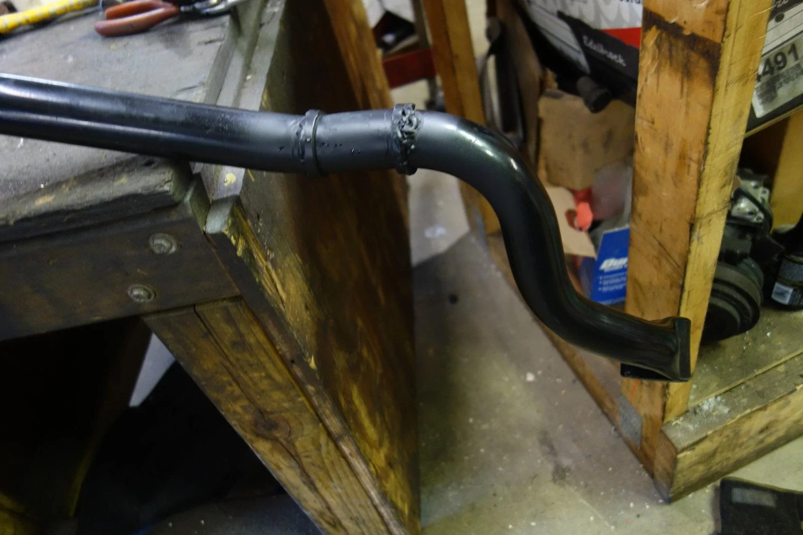

Somebody at least used to make clamp-on collars. Might have been Hellwig, not sure any more.Frpp stopped Making the E model but they do still sale it untill it runs out. I don't like the E series at all. Without the shaft collars the front bar moves side to side.
↑↑↑ you realize that you only needed to make either the two inside collars or the two outside collars . . . no need to do both sets.
