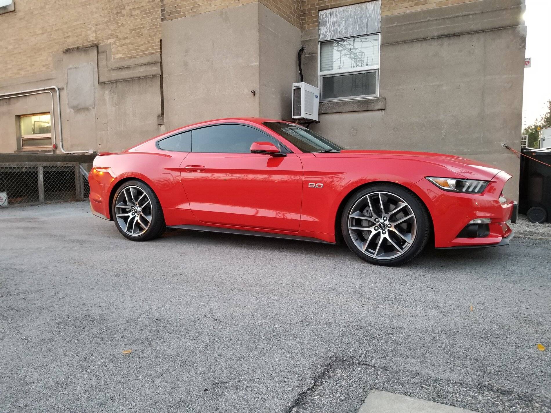

I've got the street handling pack along with the other stuff in my sig.
I have zero complaints about it. For a car that only sees street duty it's so much better than the base and a perfect mix of comfort and handling. The overall ride height ends up great as well.
The roads in my area are terrible but the car feels great on them.
But to each their own. Some will say it's shit but I really have to disagree and couldn't be happier.
Ride height ends up like this....
Looks great!! I so wish Ford made those wheels in a 9.5 front and a 10.5" rear. Love the 20" wheels, they so fit the Mustang.
