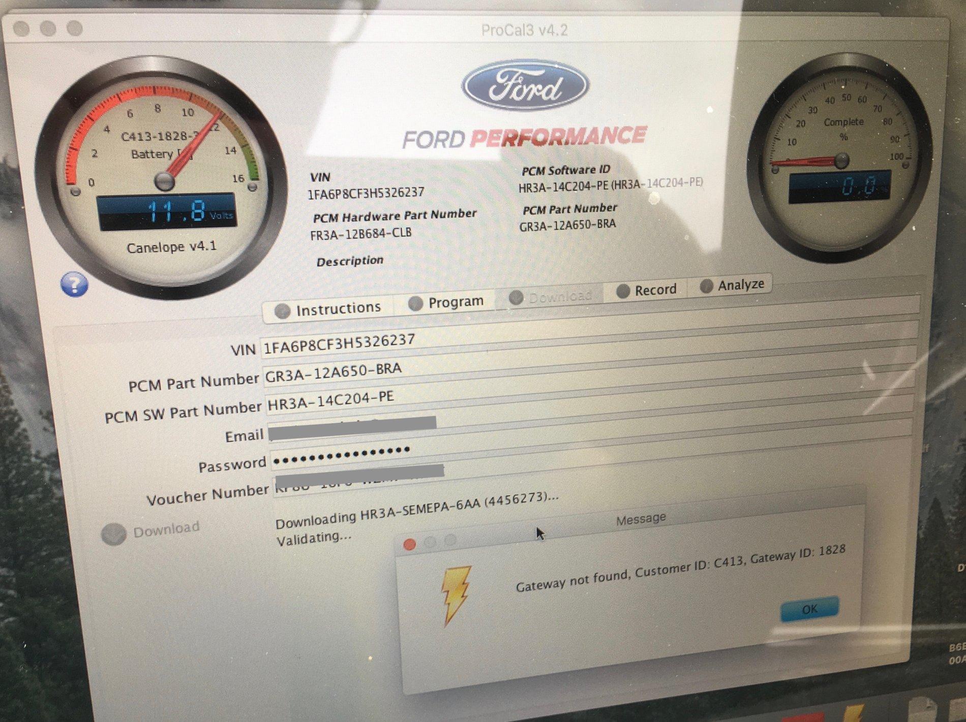

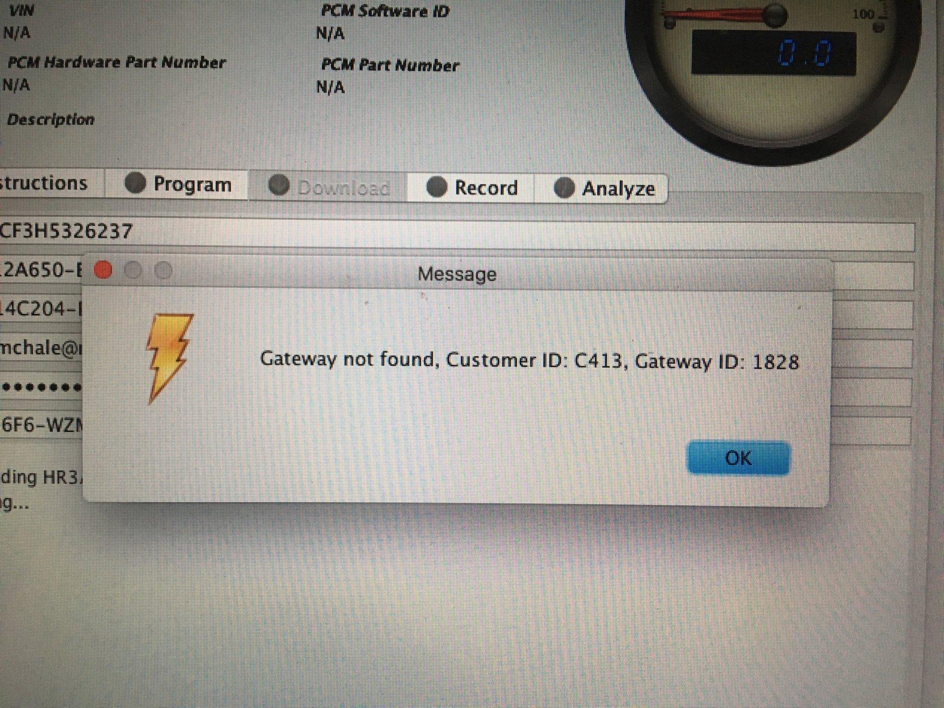

I'm struggling with the install. Followed the instructions (which led me to fhrdracingparts.com/register). Put my details in, downloaded the Procal3 Software, got the details from my vehicle by plugging in, went to download the calibration file - but it will not validate! - it says 'gateway not found' and displays some numbers from the label on the pro cal tool (which I have plugged into the laptop)

Have you called the Ford Performance tech line? It looks like a server issue on their end.
@pacomicro, did you do your calibration yourself or go to a ford dealer?
I did the installation myself.
You must make sure that the OBD2 Port is connected correctly, sometimes it looks good, but push it hard.
Then you open the calibration program on the pc and then connect the usb to the pc.
Read this too https://www.mustang6g.com/forums/th...t-ford-performance-power-packs.60467/page-243

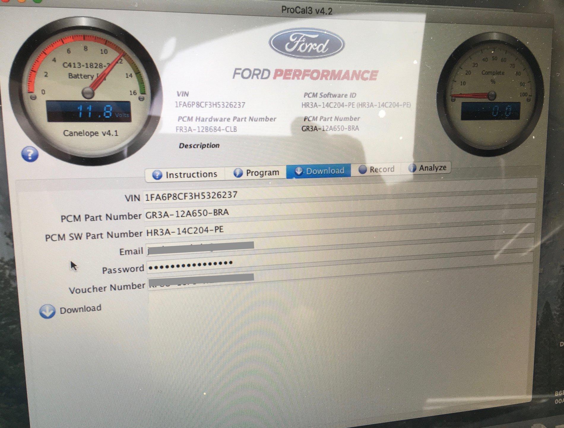

Well I tried again this morning, this time attempted to download with the vehicle connected to the laptop via the ProCal tool, thinking maybe it needs all the vehicle details in the header, rather than just the fields in the download page.
Got the same message again!
Having read other threads about the Power Packs, I'm beginning to think the dongle is faulty. There is a blinking green light when it is connected to the laptop, then whenever the ProCal software is opened it flashes like mad in all different colours and places. I don't know if this indicates anything?
I'm expecting the support from Ford UK to be even worse than Ford US, so I'm not expecting a resolution any time soon!
Just for info, here's some screen shots from this morning in case anybody spots anything obvious I'm doing wrong.
I see all the right data, maybe it's dongle problem, bad luck.
I would try to eliminate the software Procal3 of the pc, to restart the pc and to return to begin again following the instructions exactly, the pc must be connected to the OBD2 and the ignition of the car "ON".
There are indeed two flashing lights, one blue and one green.
I would try to talk to Ford Performance in the USA, the rest I think is wasting time.
