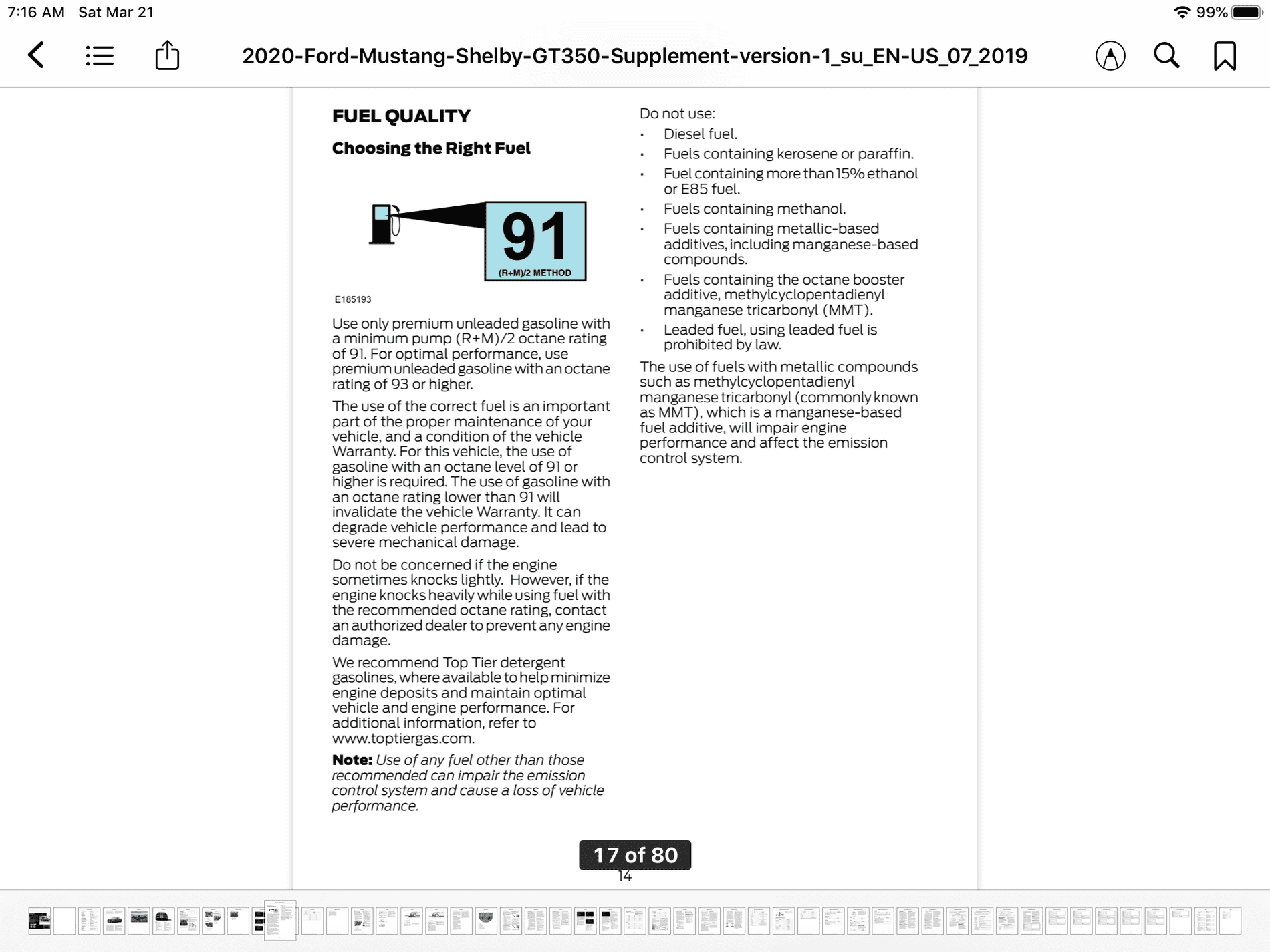

Second time in five minutes I’ve posted this.
I believe your warranty is done if you do E85 and/or a tune. Some are ok with that, some are not. It’s your call.
Exactly. I’m not willing to give up or gamble with more than 2 1/2 years left on my warranty. I trust the engineers that built the car.
