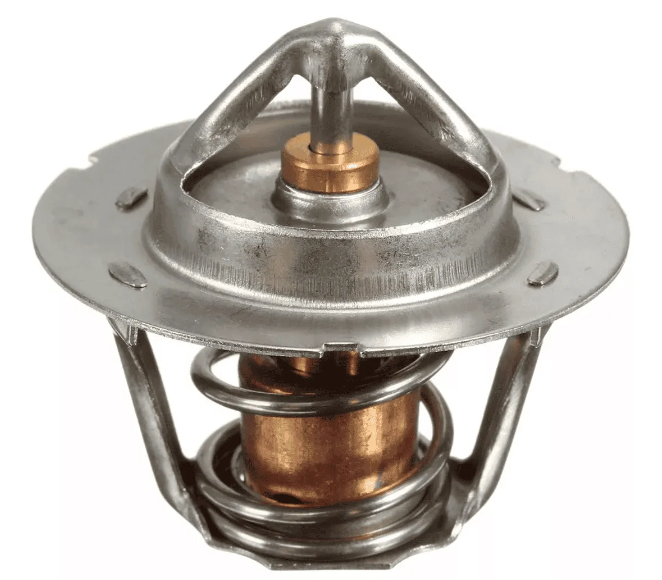

2. 160 degree thermostat.

Just remove the thermostat. Dont waste the money on a lower temp one.
