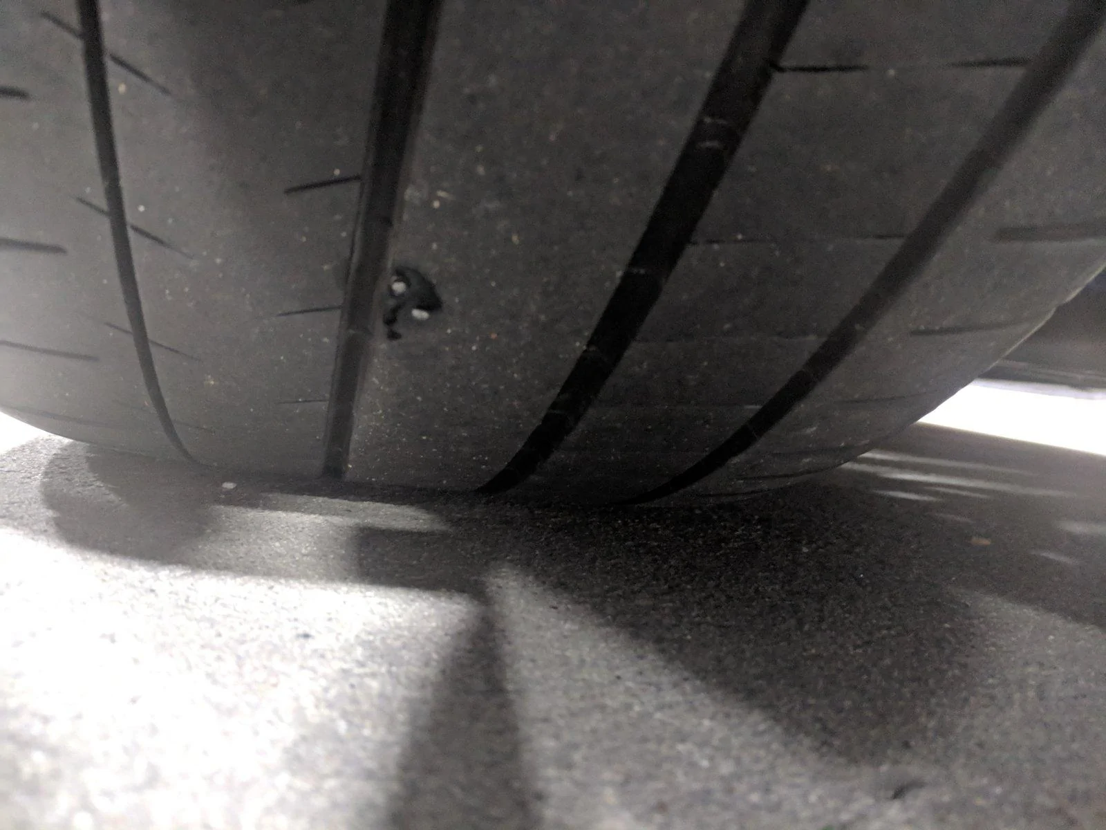

I got 2 small nails next to each other with a very slow leak . Can this be repaired ? America tires told me they cannot repair it due to the nails being next to each other.

I mean, they have plugs and patches of various sizes. I don't see why they couldn't...

A larger patch should take care of that, but I'm not a tire expert. Maybe patching two holes that close together is a no no. I would never plug a tire unless it's just a temporary fix until I could get somewhere to patch it.

Yes. If it was sidewall or near the edge then no. This is small holes dead center of the tread. Just do patch and plug. So need to remove the tire for the patch. Lazy way is just to plug.

That is what I thought also. They can use a larger patch to fix it but I guess the liability of something happening is against the policy.

Both nails are leaking. Slow leak but still leaking.

They're not on the outer tread. Nothing wrong with repairing those with a plug patch. And if you even want to track on that? Go for it, it'll be perfectly fine.

My tire guy says they don’t use plug anymore but a patch should easily cover both holes, they may actually be closer on the inside if they went in on an angle.

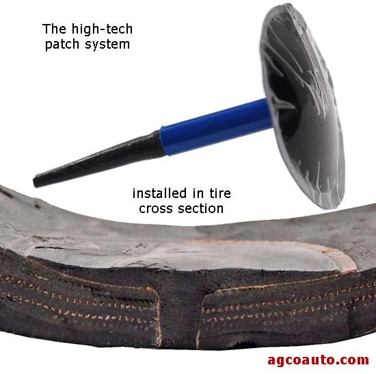

For liability reasons most reputable tire shops use a plug/patch that is pulled through the hole from the inside that seals the hole and patches the inside. How do you use one when you have two holes close to each other?
Niz55
Niz55
May 10, 2015
358
3,674
1,285
Us
17 GT350
What am I looking at here?

Never seen those type of plugs before. Pretty neat. Will pick some up for our shop. Another thought you may consider would be use the plugs & a good old fashion tube to play it safe if tracking.

By the "rules" that's two punctures and by the "rules" two punctures within a prescribed distance are not repairable especially in a Z rated tire. Sure it can be repaired but the assumed liability makes it not-repairable, in their eyes.

Got it all fixed. Patched from the inside.
