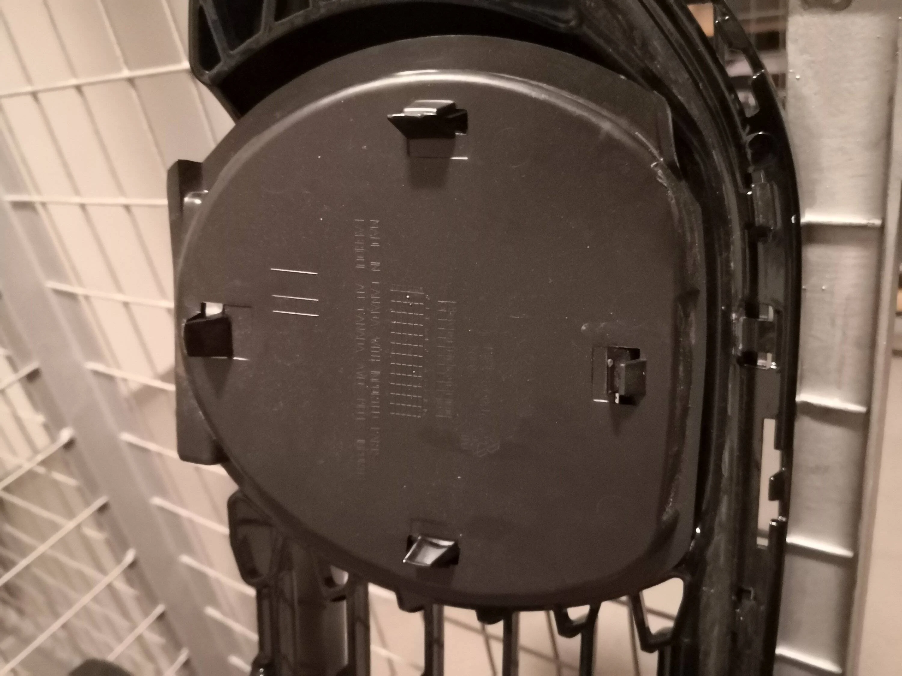

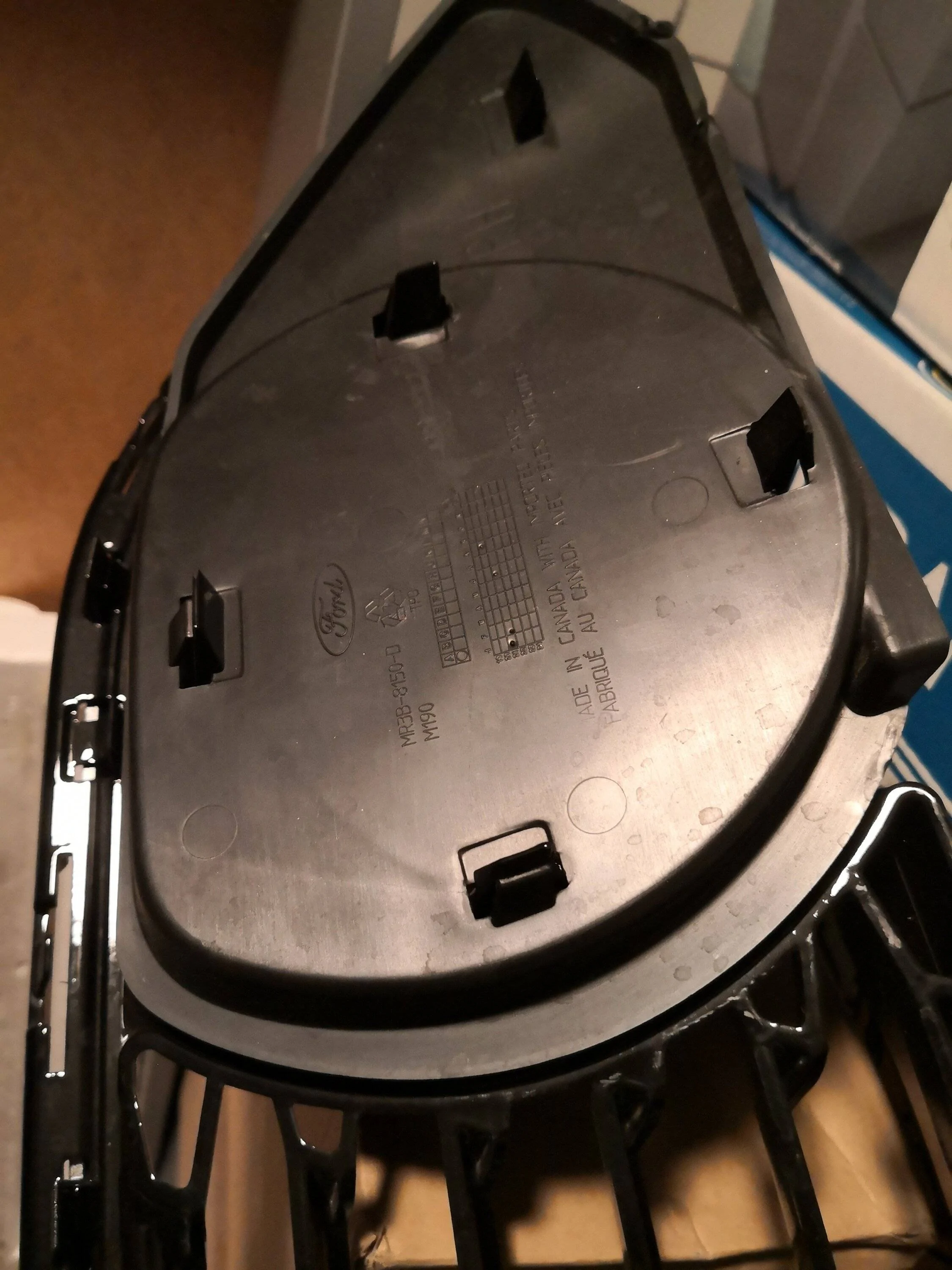

I believe you have to remove them from the other side (inside). Since I happen to have one front grill in a closet, I took few pics to illustrate what you are facing:
The lids are not symmetrical - the driver lid has four latches, the passenger lid has five.
Driver side:
Passenger side:

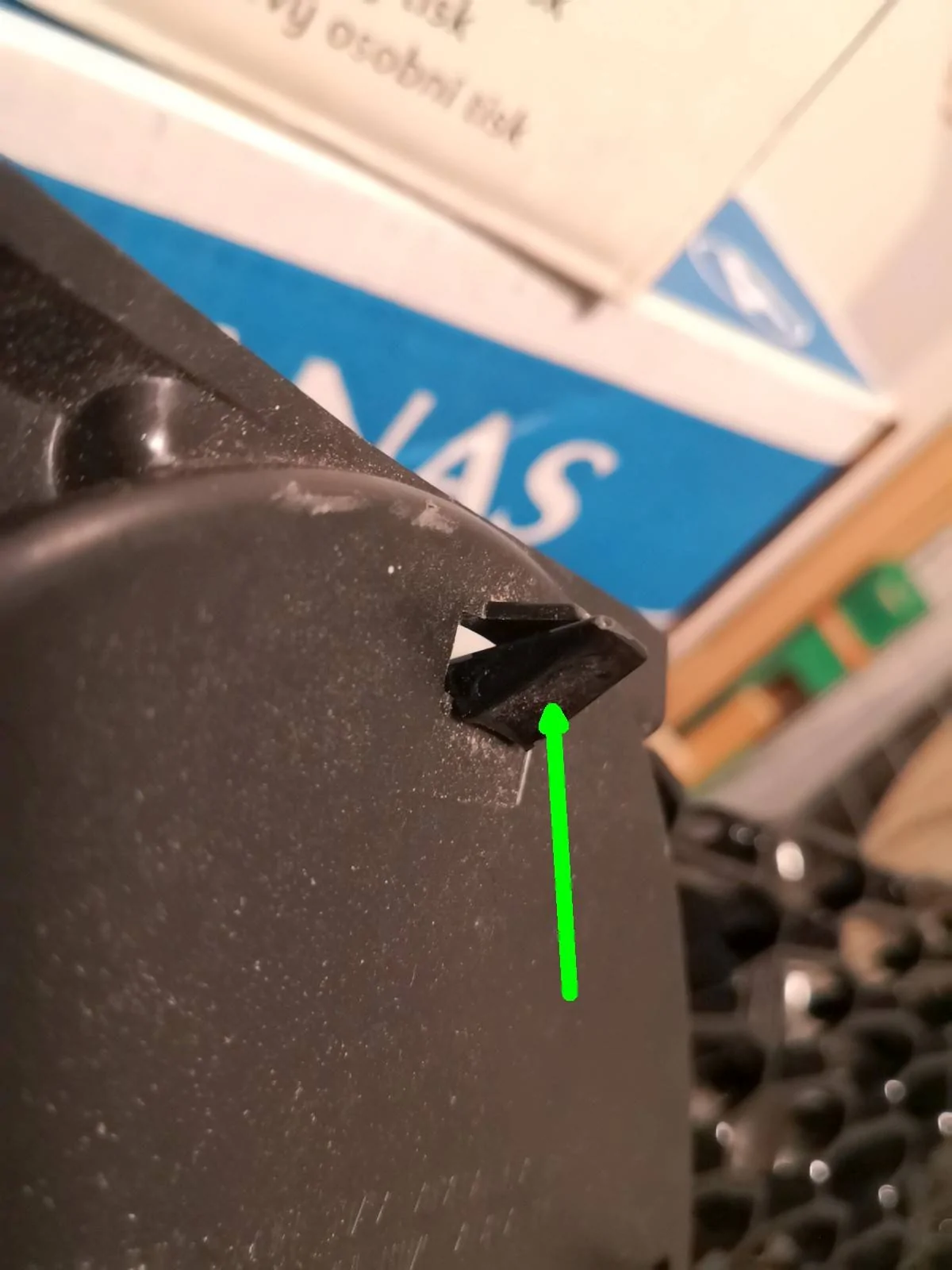

You need to press the latch (stems from the grill) against the flare (from the lid) to unhook it:
The white triangle inside the latch shape is actually a see through of the cardboard box behind.

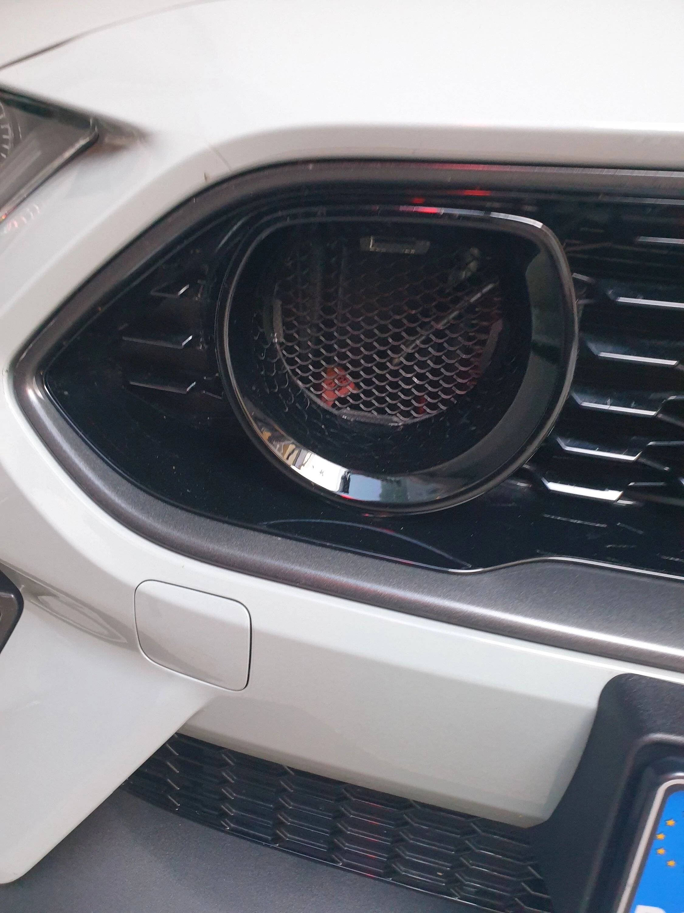

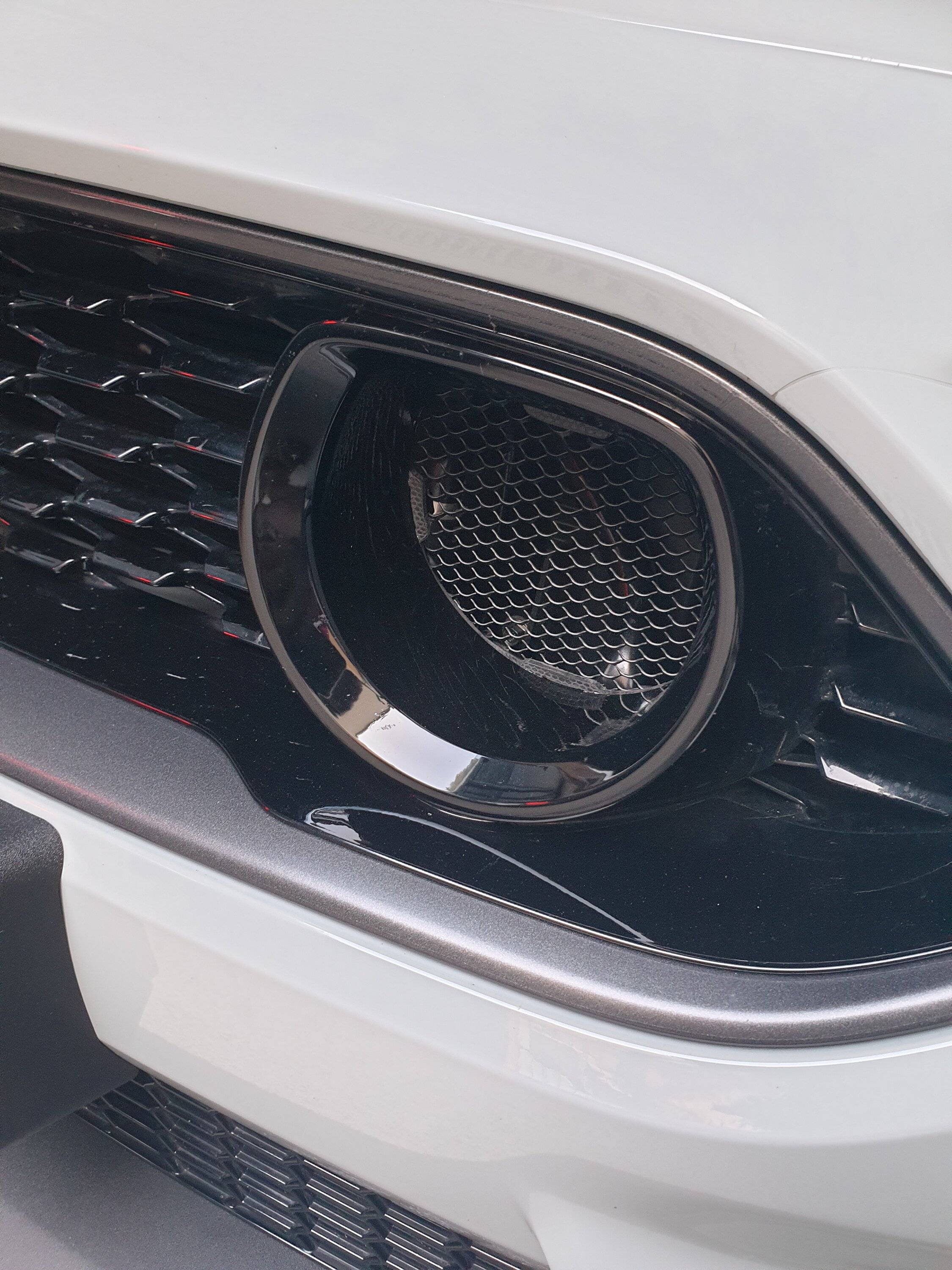

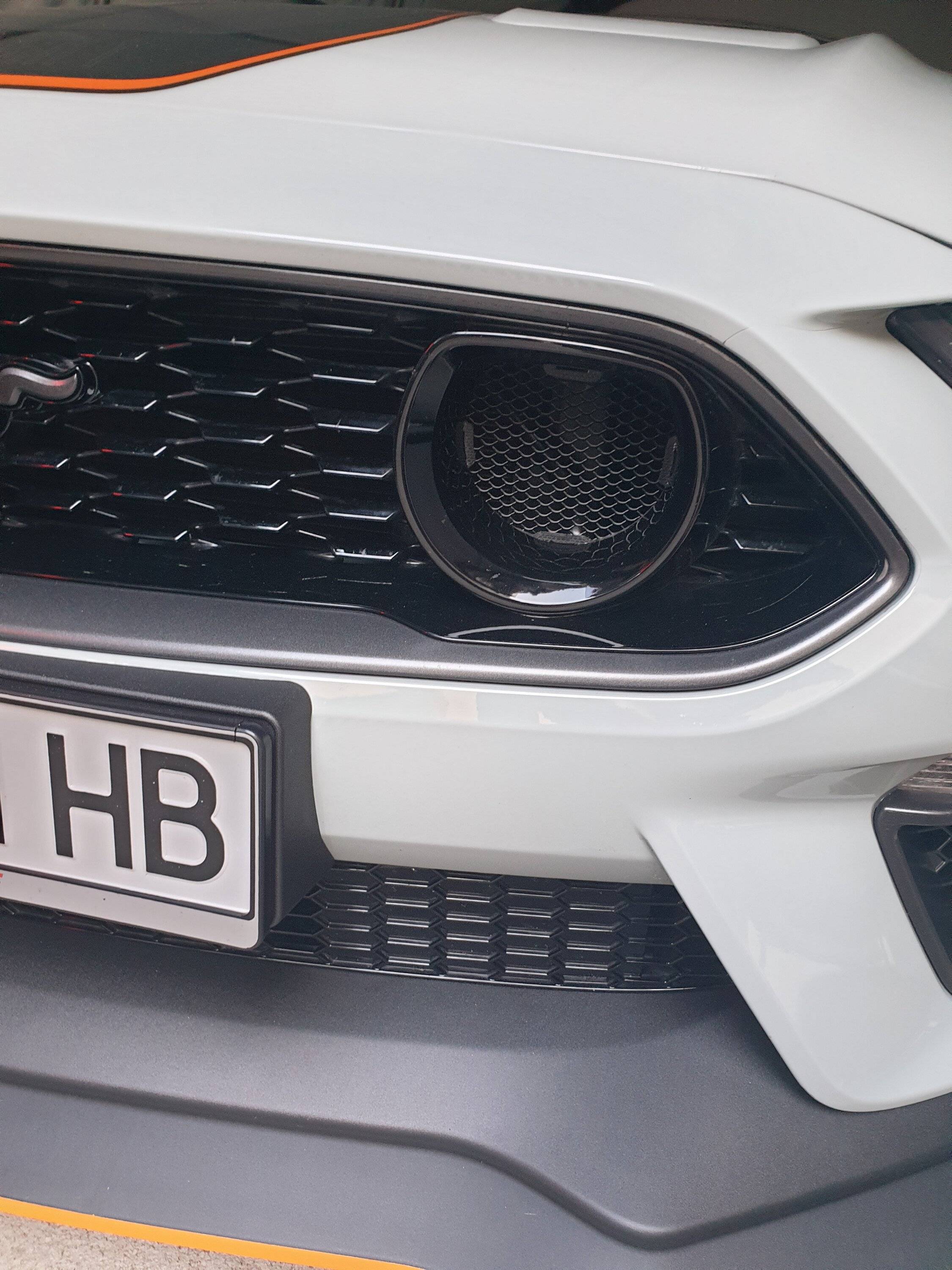

That's what I did with mine.
I like what you did here. Now at least they look like they have some sort of function. The factory solution makes it look like something’s missing.
