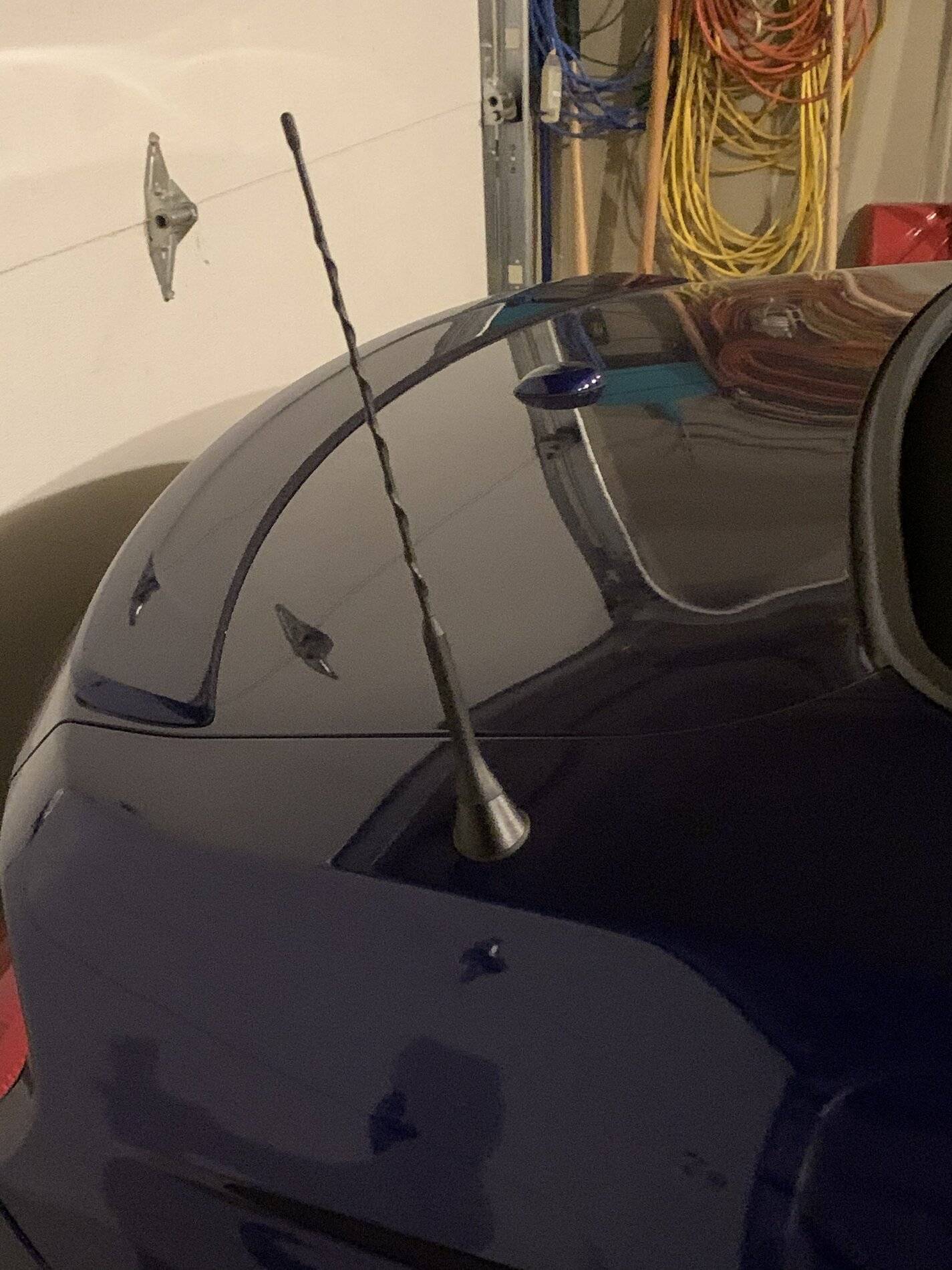

Here you go. Not the best lighting but should suffice.
Radio antenna on the quarter panel and satellite antenna on the trunk.

Thanks, that would work way better. I wonder if the lead goes straight to the radio or through some module first. Time to find some wiring diagrams, If there's a module in between that would trip me up. So Todd are you saying I should give up the GT and buy the jeep or just the antenna :crackup::crackup: Thanks guys you've given me hope. Jim
