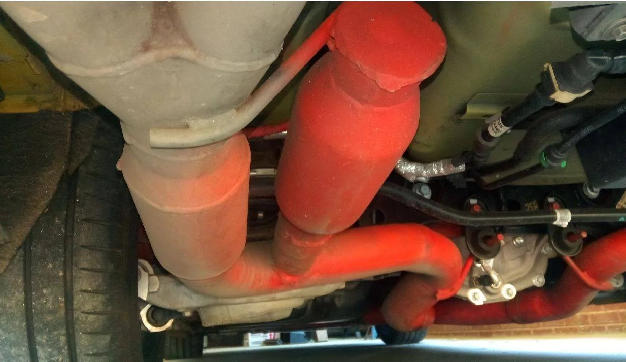

Not in a million years would I be bothered to do that for some POS dronemasters hahaI added a Vibrant resonator as a Helmholtz chamber and that killed the drone and added a little tone.
that's awesome!I had the Outlaw's on my 2018, they have ear bleed drone fer' sure.
I initially installed the catback on the stock cat pipes and it was loud, I installed MBRP headers and that was crazy loud, I welded in a 3" Vibrant mid-mounted muffler and that dropped the volume a tad but really deepened the tone.
Sounded almost like my 3v with the Borla Stingers.
