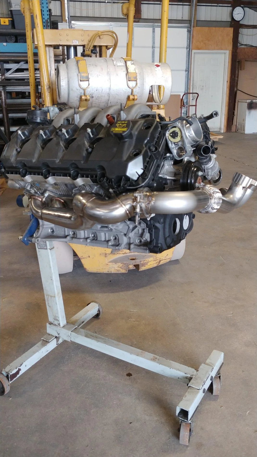

I sourced an F-150 coyote locally to mock these up further. I'll let the pictures speak for themselves. If there is anything specifically you want to see, let me know.
https://photos.app.goo.gl/t1kG5VserGs2FAap8
Who makes a single turbo cross over for these or is that where the custom fab begins?
I want a big single kit with the screamer covers hellion sells LOL.
