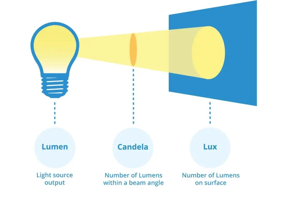

Looking at these two lights and still trying to learn what you get from lumens vs candela. Looking at two lights that...
700 lumens/100,00 candela
vs
1,500 lumens/34,000 candela.
Big picture, what can you expect differences between the two?

Higher lumens is more total light.
Candelas is how focused that light is.
750/100000 will be a concentrated beam with more range
1500/34000 will be a broader beam with more overall illumination but much less range
