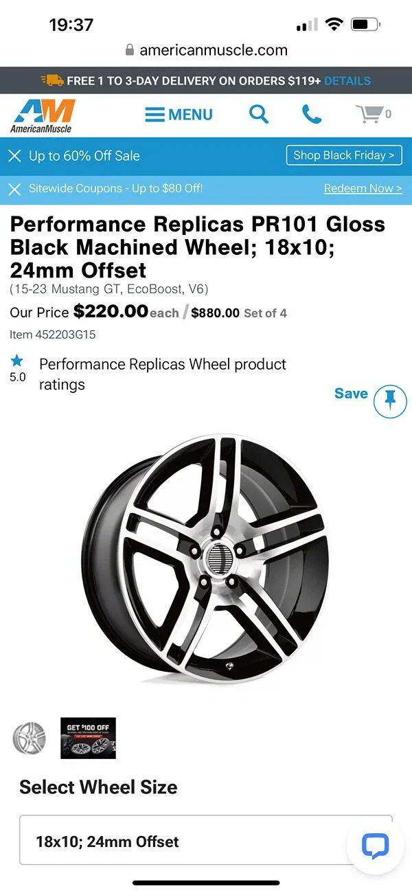

Ok I know there’s hundreds of these posts but I can’t seem to get a straight answer when I googled this crap so I’m coming to the experts lol.
I’ve been searching for 18x10 wheels and trying to pick the right offset for them. I want to keep a truly squared set up so I can rotate tires . I keep seeing it needs to be like +40 but all the wheels I find for sale are +20-25
I truly like the wheels pictured here but want to make sure the fitment is right before ordering.
My car is stock suspension and will likely stay that way. Car has a blower and more power than is safe with the 235 tires on the car now.
I don’t want 20’s. I like the look of the 18.

I'm thinking 18x10+24 would give too much poke.
They make the same wheel in a +45. Would that be a better option or am I out of luck here.

45 would be tucked and probably hit the strut on the front. That would work on the rear.
Front could be fixed with small spacers or not ideal?

I just installed 20x10 +35 square on my 2020 And that is pretty flush. No rubbing at all.

Yes you could do spacers. But to me that defeats the purpose of buying new wheels.
