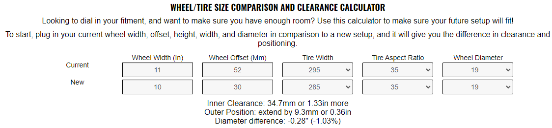

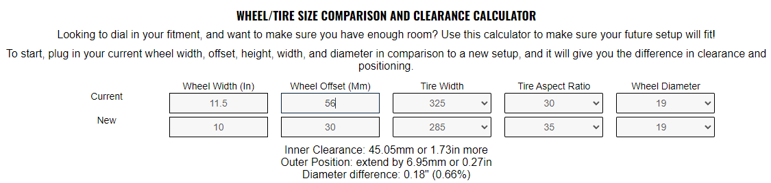

30 is a bit aggressive, but should be fine with the 285's. Per the calculator on Fitment Industries, your setup will be about 7mm further outside the fenders than my "street" setup per side.
Or about 9mm further out than my competition setup.

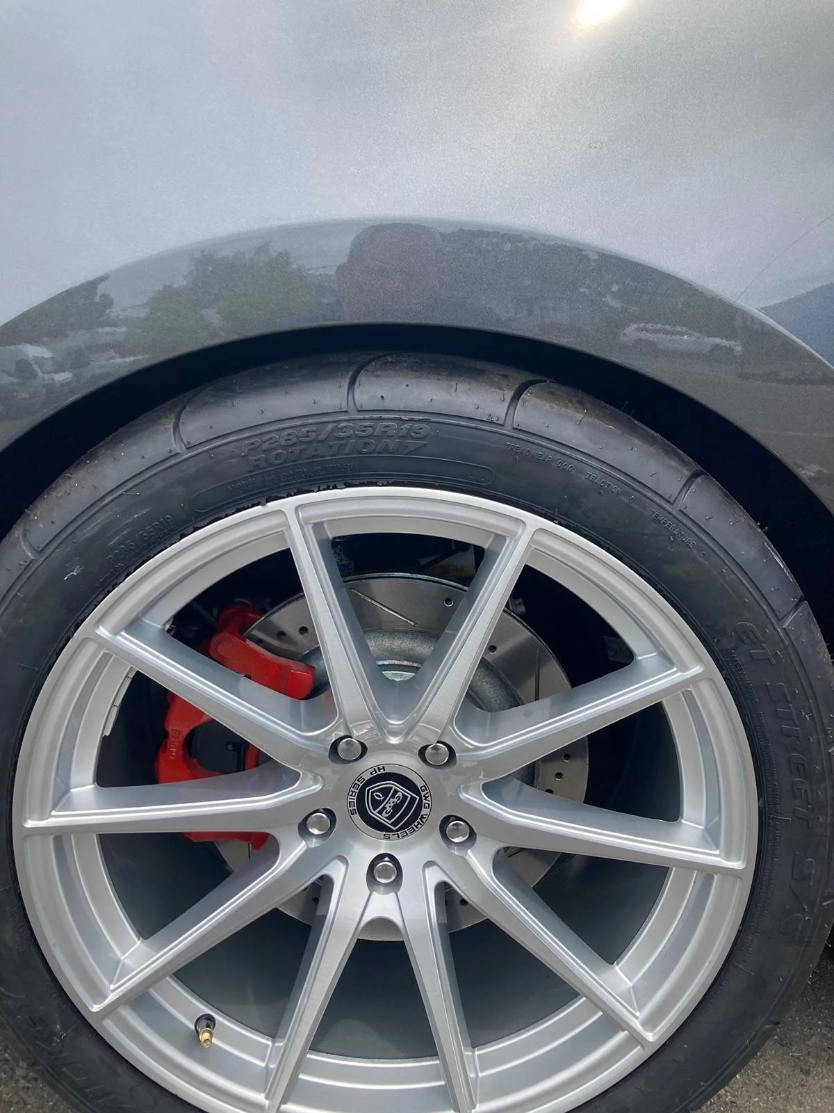

Went to the wheel place today, wound up with the rear offset at 37 and the fronts at 32. The fronts are tucked in just past the fender with plenty of room. Rears are about 1/8 of an inch past the fender and looks great. Plenty of room between the fenders and tires. Thanks everyone for your input.

Yeah luckily the guy added to the offset and it fit perfectly. Slightly aggressive looking but not obnoxious. Thanks for all the advice.
