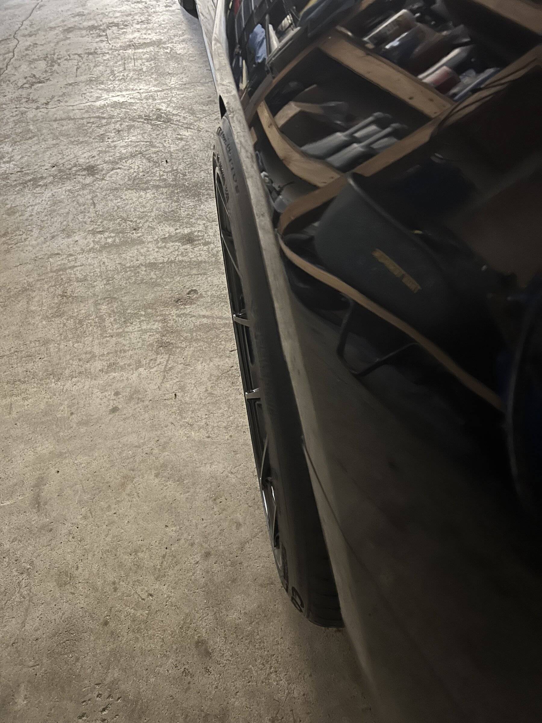

Ok, one thing after another..lol.. bought this 15’ with 255’s in the back (stretched and looked ghey) dealer owed me a set of tires, so got new 275’s next day from dealer.
Fast forward 2 months. Driven like 3 times and confirmed in the last ride, tire is touching and I don’t like that. Car is on red eibachs.
It’s just too low and the backspacing/offset is not to my liking
What size rim and correct backspacing/offset to tuck a 295’ ish inside the wheel well?
I’m trading/selling these 20” niche btw/slight rash here and there
what backspacing, for a 295/305 in rear with still being inside the lip?

ET 50-52 is pretty common for wider 305 tires on 11” wheels and should work well on a 295. Season with rear camber to taste

I’m just trying to get it tucked back in
So looks like I need to find out what other backspacing/offset niche makes for this wheel or I get to buy another set..
damnit..I’m in supercharger mode and now gotta spend $$ here again
Just hit new tires ;(
