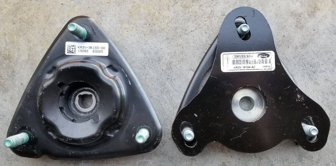

Adjustable on right. See the notches in the black portion that are 180° apart on the one on the left? Looking down into the strut hole you can see them if you have non-adjustable plates. No notches means they are already in place and they will look like the ones on the right. Sometimes you can see the stickers too.

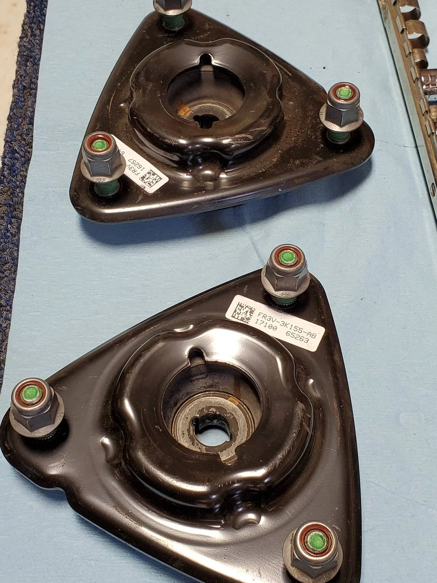

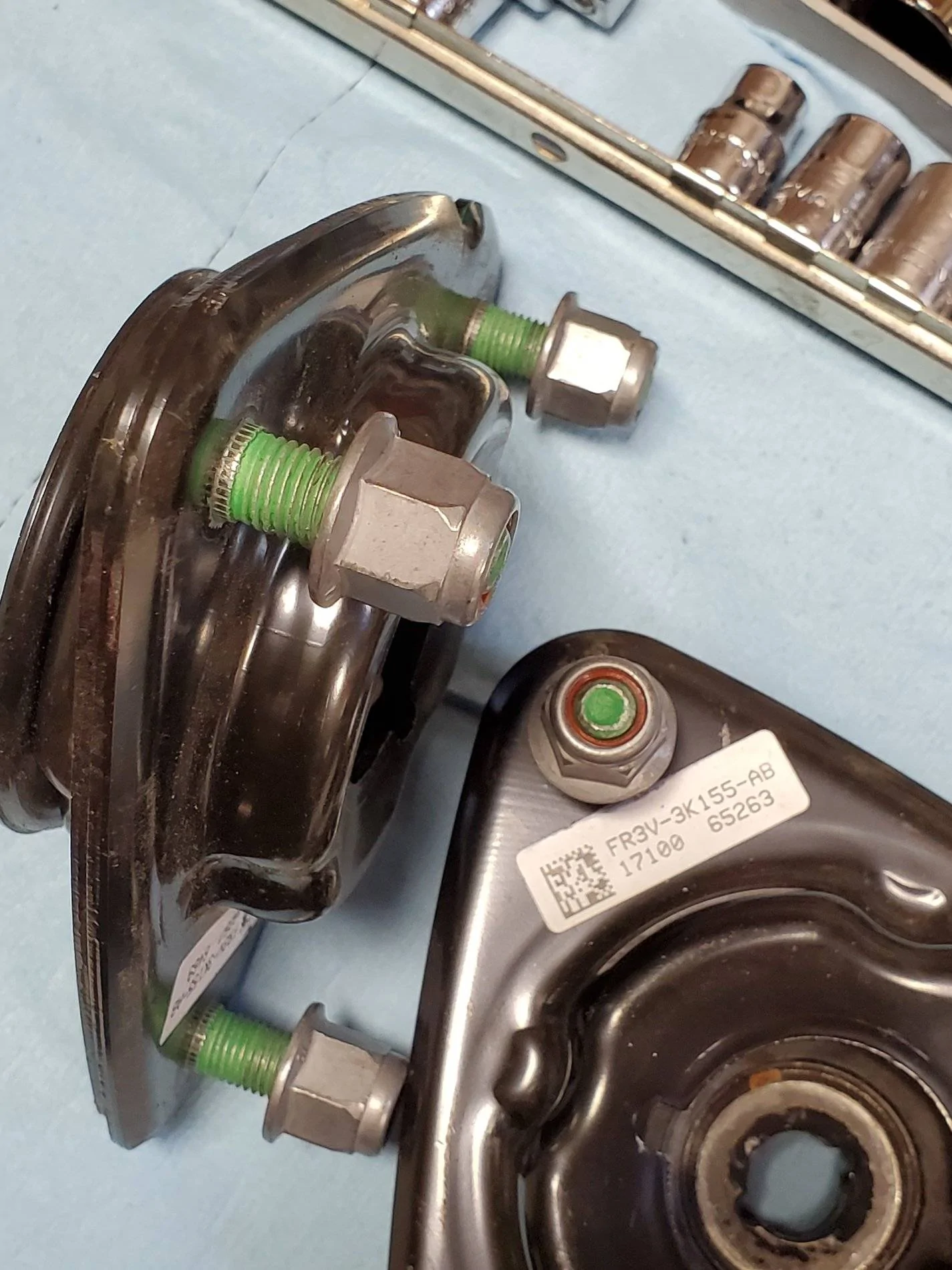

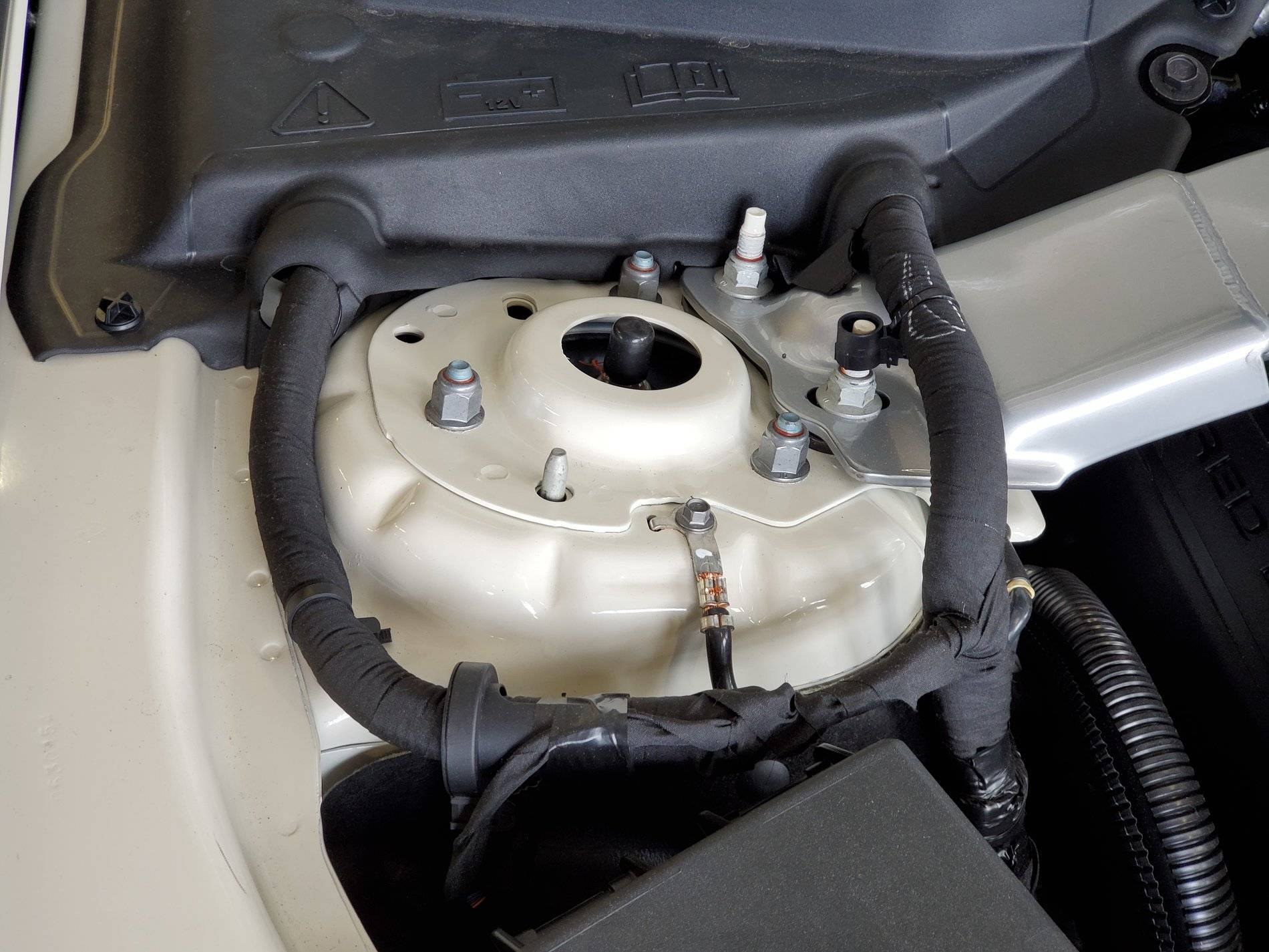

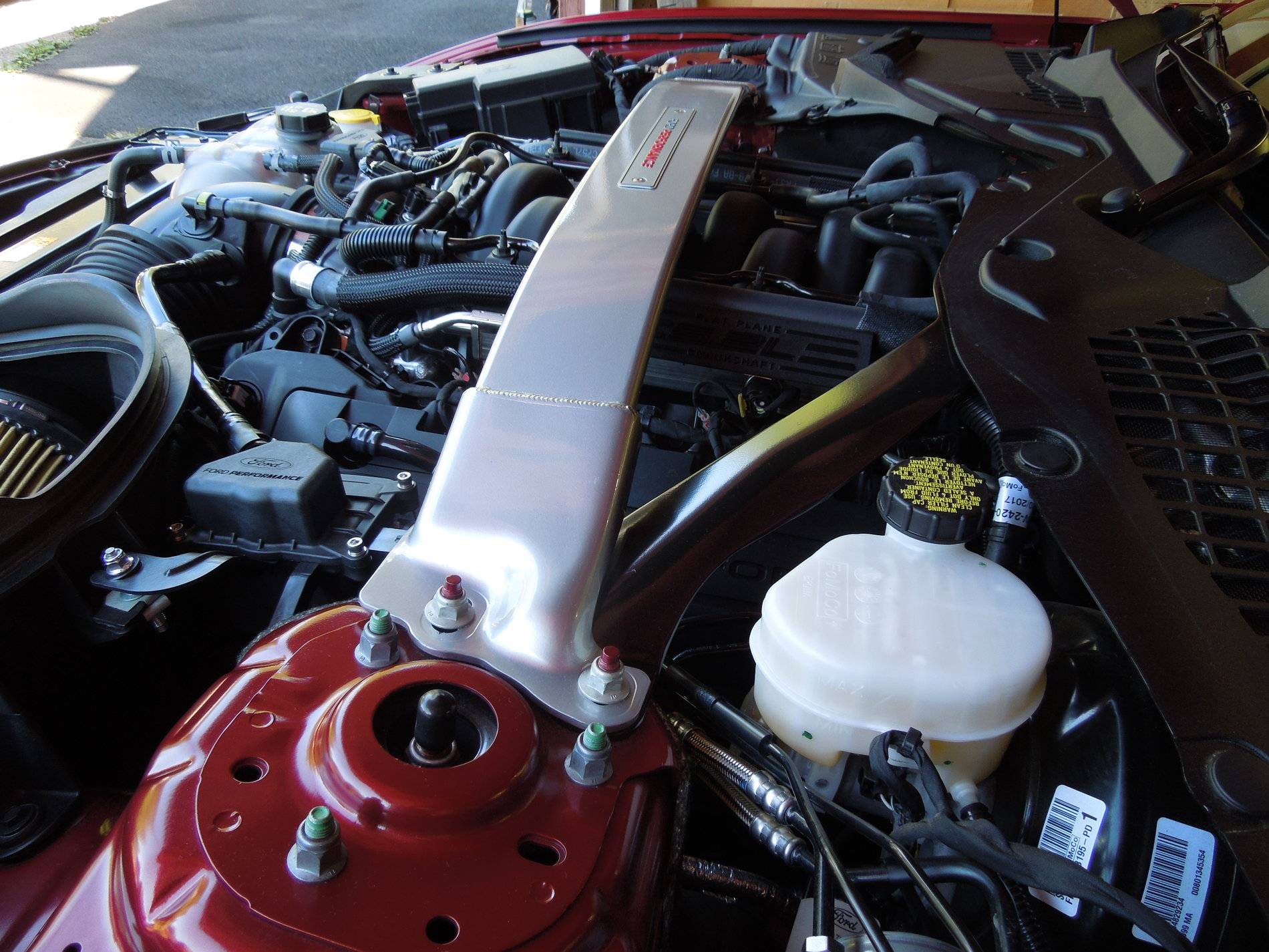

March 16th GT350R HEP build, Just received it June 25, didn't make it out before Shutdown. It's a Job#2. Camber plate part numbers from our 2017 vs the 2020 R.
Also, notice the "pin" Sticking up on the Wimbledon White 350 vs the no "pin" on the Ruby Red strut towers.
  • 2017 GT350 fixed- FR3V-3K155-AB
  • 2020 GT350R ADJ- LR3V-18184-AA
Couple pictures to compare with. Also, from the bottom you can see an extra part(don't have a good pick of that yet. Brian

So Brian...does the pin just get driven down/out thus allowing adjustment with loose bolts, etc?

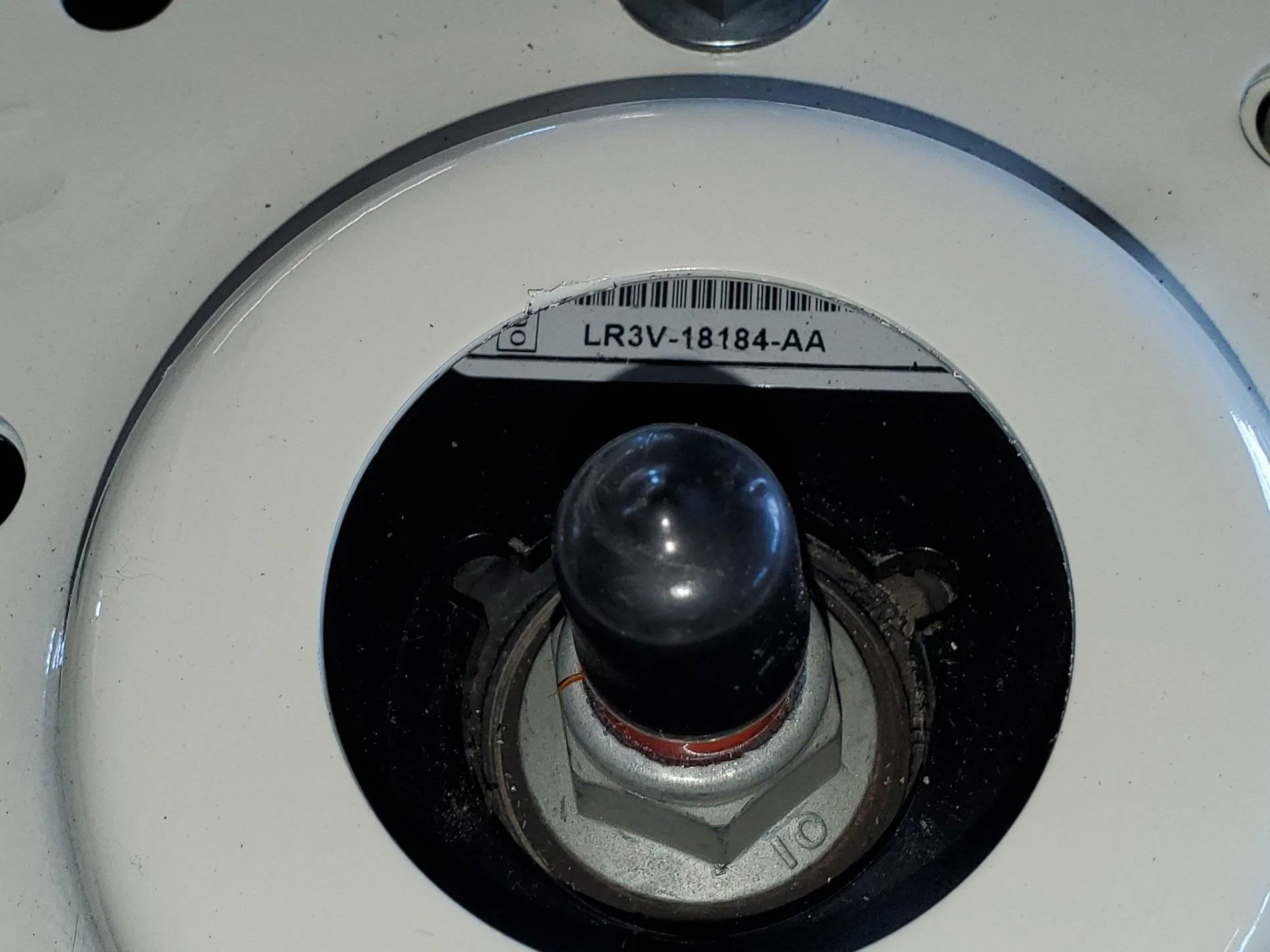

I can’t see any adjustment slots by looking down over the strut but I do see a part number.

Tob: I've never seen a non-HP strut so I didn't know if there were visible differences but obviously, I know zip about camber plates. :-)

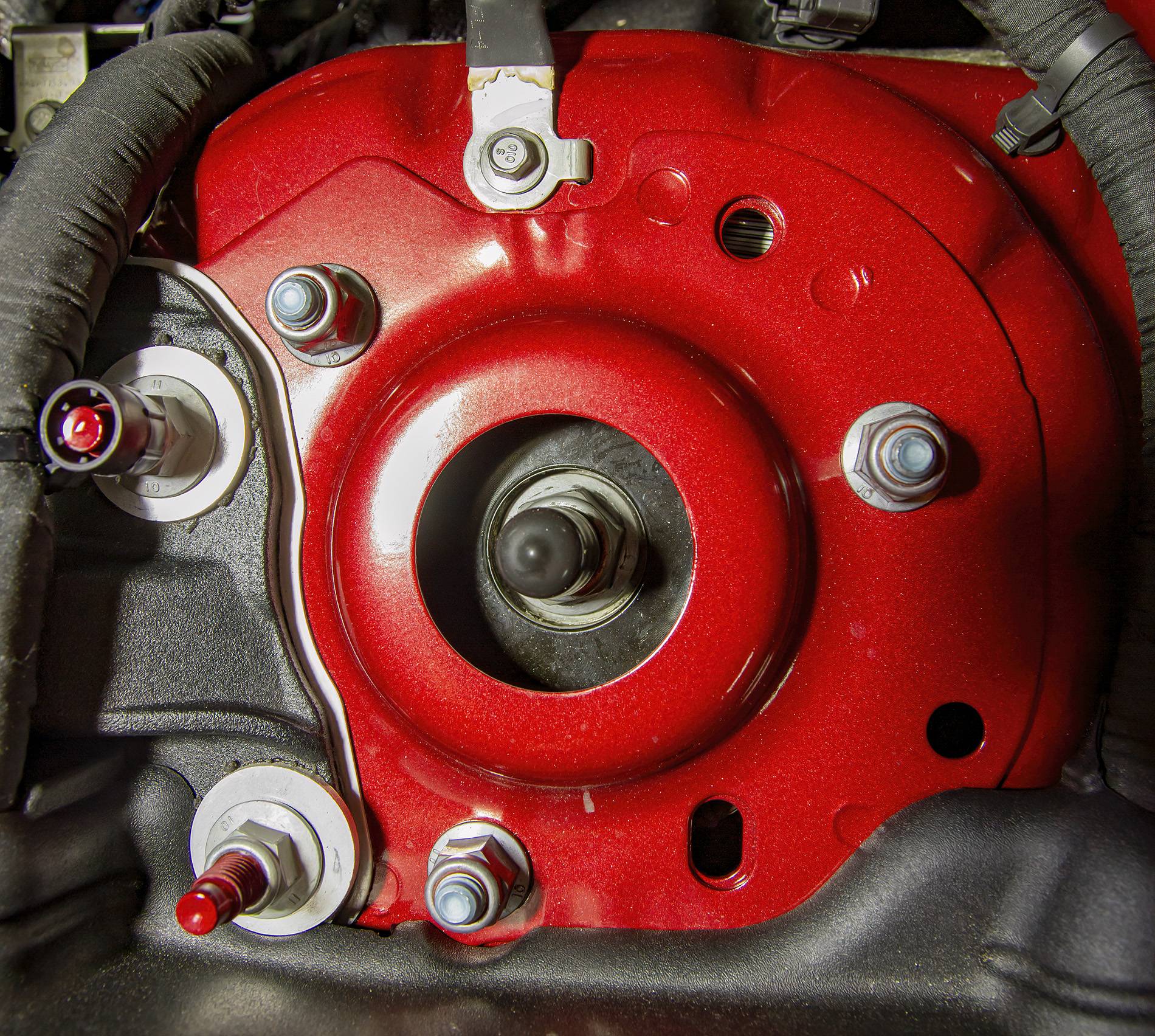

I doubt this will help but here's the overhead.
Adjustable

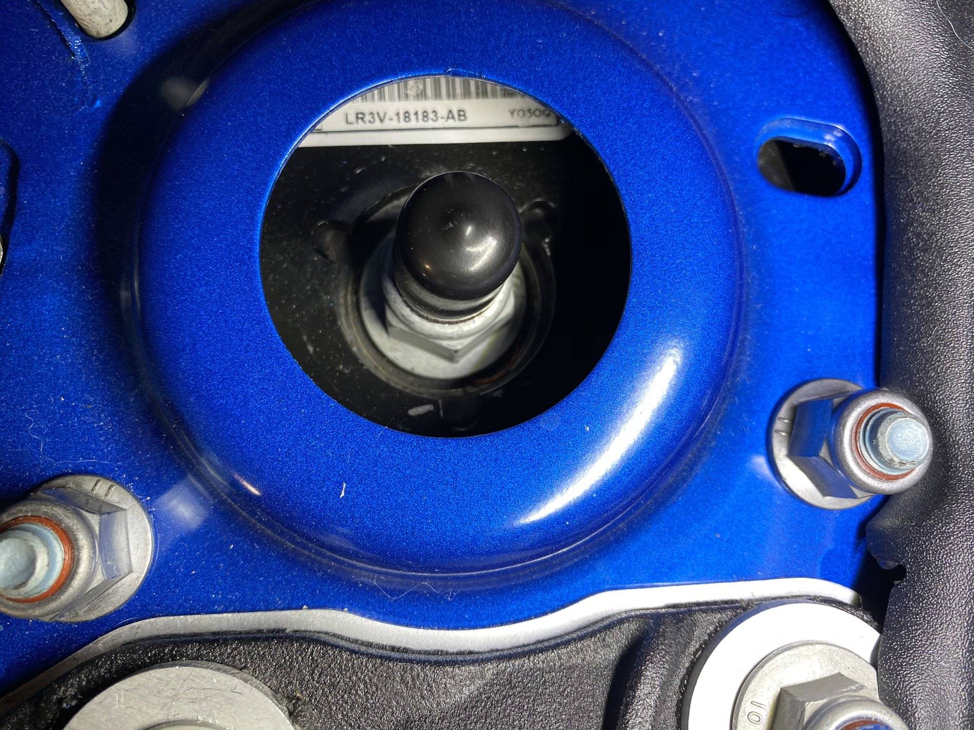

Non adjustable
