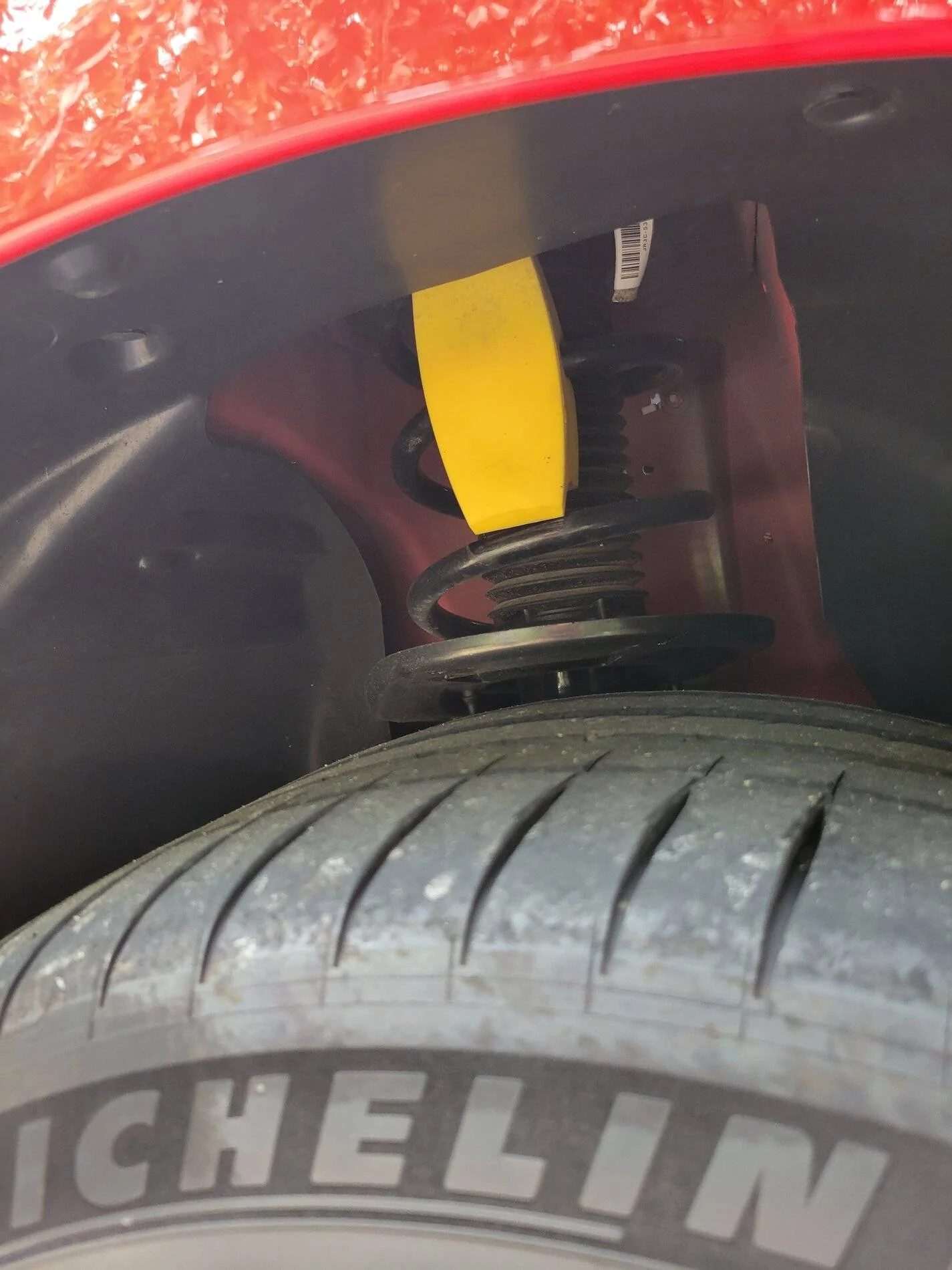

Guess I should have changed my oil sooner.
Guess what I found!
Could these have weakend the springs or struts since I've driven 7.7k miles now with them on?

Dang man, your dealer should have removed those during PDI

I don't know if I want to be that guy and call complaining and see if I can get new springs or just leave it be

I hate to say it, but never assume your dealer has done a proper PDI. Always check to make sure the shipping blocks have been removed. Several posts have shown cars delivered to customers with shipping blocks still in place. I asked that they be placed in the trunk when I took delivery, and checked to make sure they weren’t still on the car before leaving the dealership.

I don’t think it could really damage anything. Don’t they just limit the suspension travel?
to be safe I would have the dealer remove them and document it in case something comes up down the road with a shock failure or anything that can be attributed to the blocks being left in. Just to cover your own ass. But I think you’re car is probably going to be ok

The first thing I did when picking up my car was look in the wheel well. Sure enough they were still in there. I’m like dudes. Kindly remove those, and the dealer sticker you slapped on the back. Also, check your tire pressure, mine were at like 45 psi.

I have seen several YT videos where the new owner found the shipping blocks still on the springs (StangMode was one of them). I wonder, is it something new Ford started doing on Mach 1s, or why are dealers missing them?

Any Mustang with Magnaride has them. The dealer new car department, including mine, assume they are all the same and dont bother looking if they have Magnaride.
