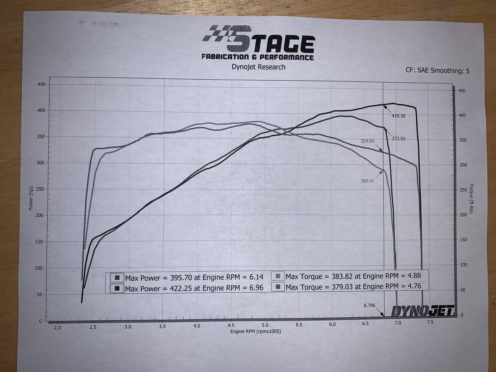

Got my car dyno'd at an event this morning, going into it I wasn't sure what to expect - Car spec is here
Are Sport Devices Dyno results accurate ?

Strange. I was expecting the peek power higher up with the gt350 induction mods. Have Lund got a soft limit at 7000 rpm on your tune?

The tune is something I want to revisit, I'm still running the initial tune Lund sent me 3 years ago, which included the manifold and headers. I understand the stats the dyno is showing me, what I don't understand is how these compare to others and where, if any, I can make gains.
My new nGauge should arrive tomorrow, my existing nGauge was damaged beyond repair. I would have liked to have enabled logging on the dyno runs.

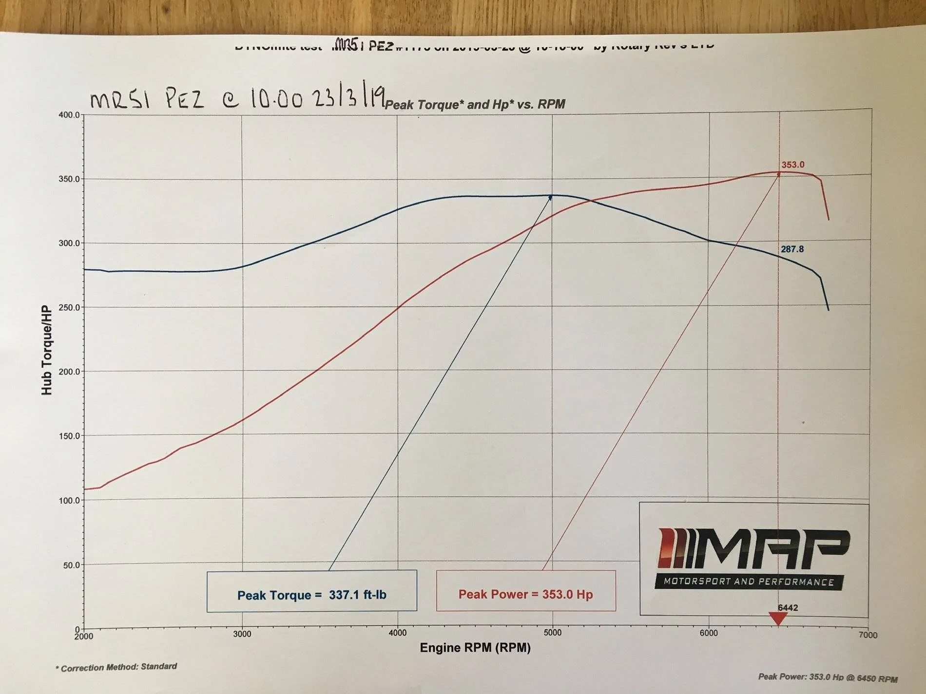

^^ thats mine boggo standard MY17 measured at the hubs if it's any help for comparison

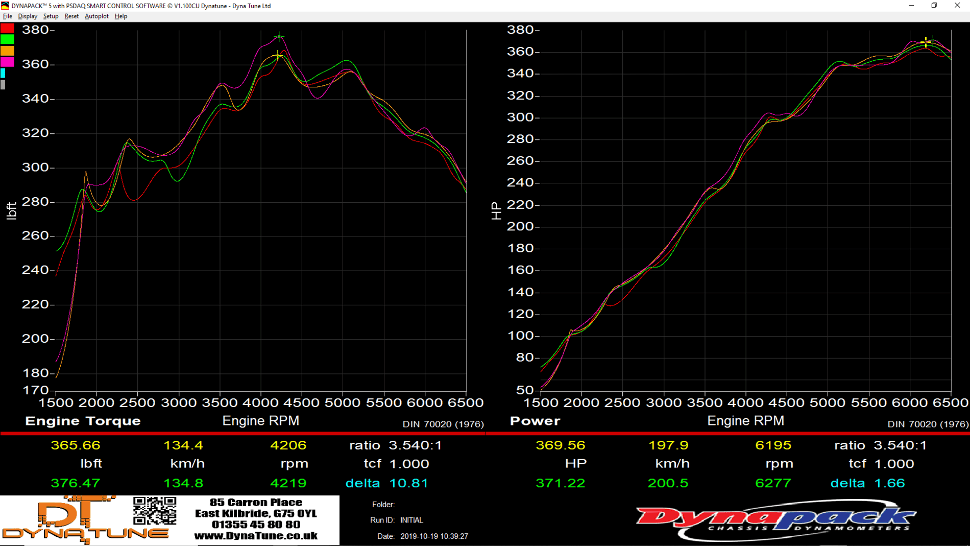

Here’s mine stock no tune just axle backs 2017 Auto on a hub Dyno
I tried asking Lund about my tune but they weren't too forthcoming and then said I needed to pay $150 for 6 months tune support

The last log looks more typical of the Gt350im curve with power peaking at 7k rpm. Suggest gr11ms log stopped short of reaching peak power maybe because of traction control fuse or the tune having a low soft Rev limit. gr11m has headers so in theory should flow better and not drop the power off at 7k rpm. Obviously different dyno is so can’t compare absolutely numbers, just the curves.
