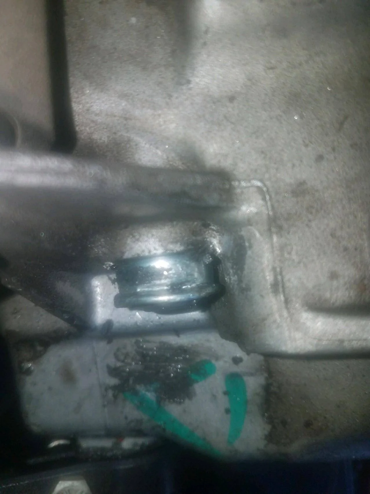

So I've been chasing down a leak on the transmission area.
https://photos.app.goo.gl/bpW65LQ6pVU23mW3A
Let me know if ya all can see the video.
Back story.
Looks like it was coming from the drain plug area. Took off the drain plug and it looks like someone took some silicon put it around the plug. Waited for it to dry a bit. Then put the plug back in. So when I took off the plug you could see the made silicon washer falling apart. Also it looks like that the thread towards the bottom of the plug is missing, or have been warn/stripped out.

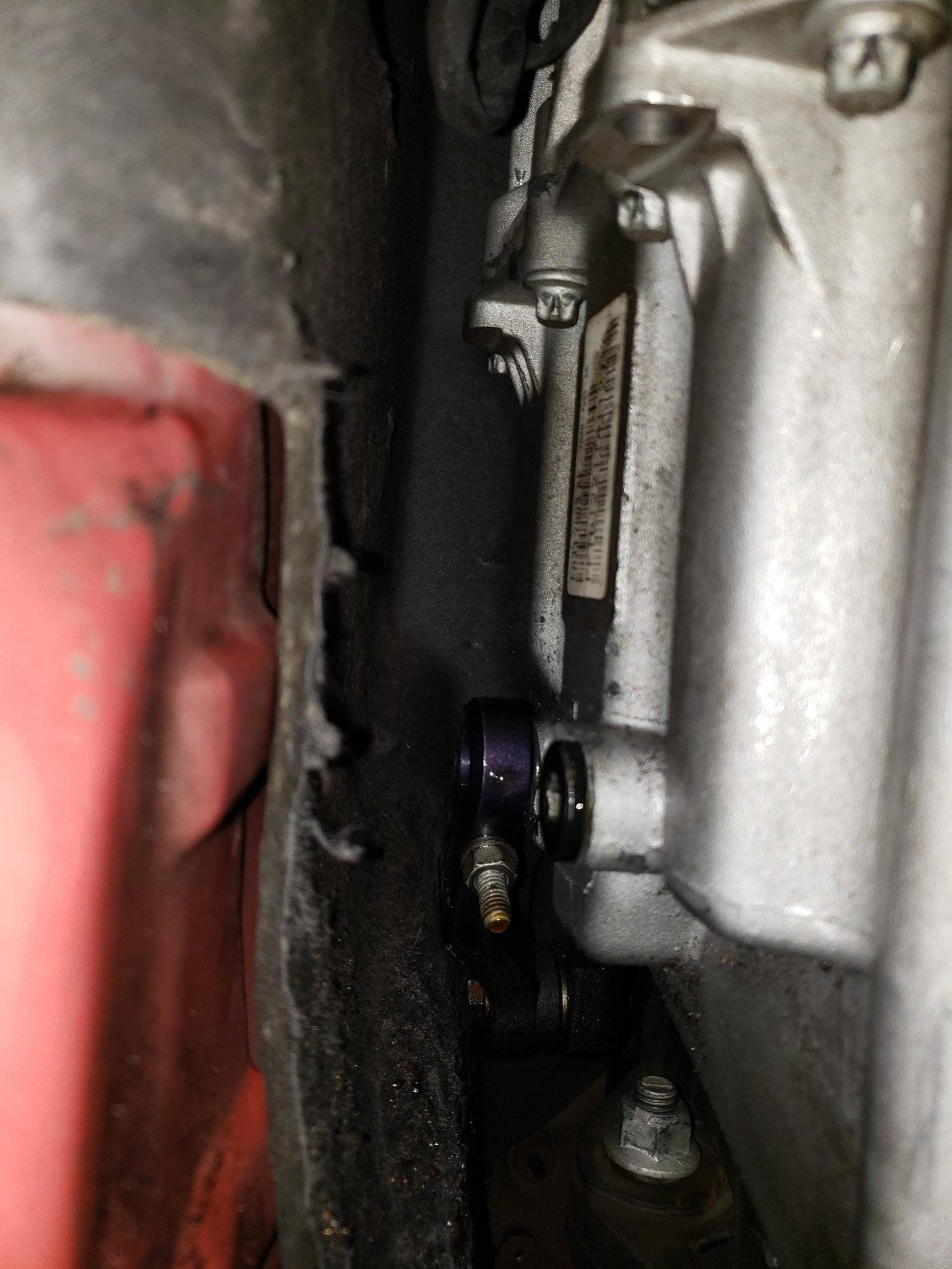

It's going to take until Monday to get a replacement plug for the drain. I'm starting to wonder if I should have just ordered two of them. Cause the fill plug looks like its the same type, and it too does not have any type of washer on it. Next... I'm trying to figure out what the top purple bar is. The shifter has been changed before I got the car. And it does look like a Barton shifter linkage. But still trying to track down where the leak is coming from.
Suggestions?

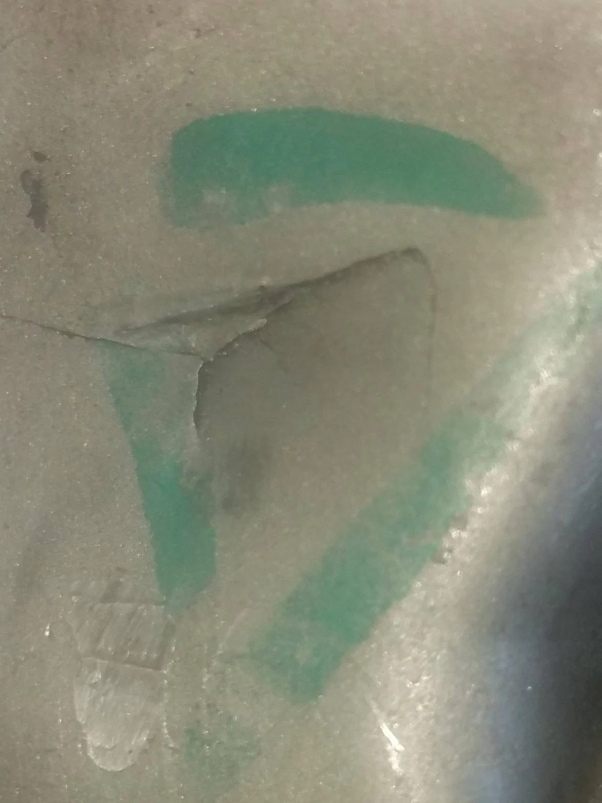

The previous owner strikes again. I found the leak. It would seem that the previous owner had broken the shifting forks and had them repaired. Well the forks were fixed. But the case was cracked it would seem. And they went ahead and used Silicone to seal up the crack. The crack being small enough, seems that the seal job was good, for about 6k miles.

...since that crack was overlooked on the initial repair...
They didn't overlook anything, someone dropped the transmission, cracked the case, and tried to hide the damage with silicone. It's most likely that silicone was applied by the tech that replaced the shift forks. That would put the replacement transmission case on the dealer doing who did the job. Luckily a MT82 is pretty cheap to replace.

Sounds like it's time to give a bit more info. The Mustang is a 2015, with a Hellion twin turbo kit. Without any timing added it puts out about 650 @ 10lbs boost, and 720 @18 lbs. boost. The shifting forks were fixed by whom, I do not know. Also, the previous owner did put it through its paces. There were a few posts of the car on youtube. And when I bought the car from a dealer (not a ford dealer) it came with an AS IS Warranty
So, taking it to a Ford dealer and asking them to fix the cracked case. Don't think its going to happen. So, what am I going to do. Well I did visited AMP Performance. They are a local company here in Phx. Got a Tremec T56 XL, and all the fixings to handle the 800+ hp with timing added.
