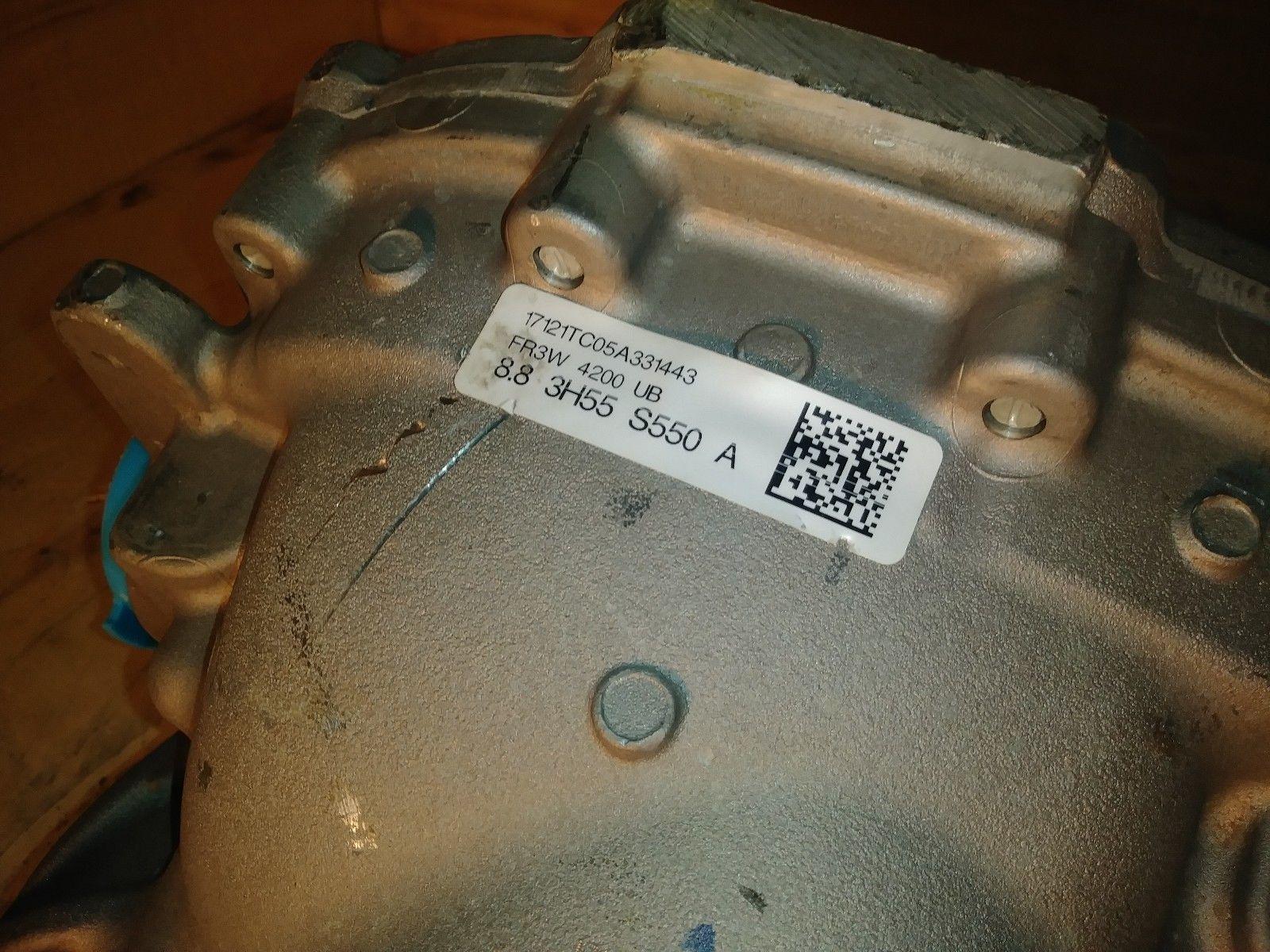

I'm just wondering the same, as my tuner asked me what ratio I have, I don't really know. I've got a AT 6R80, GT2015 PP premium
Is there a way to find this on the car ?
I've read 3L31 few post upper but where do you guys find this info on the car ?*
Thanks in advance !

There should be a tag on the rear of the diff, you can see it from the rear of the car. If you can’t get under the car you may need to lay on the ground and snap a photo to read it

Should look like this. This one is a 3:55 ratio.

Oh thanks a lot ! I'll do that right now :-)
