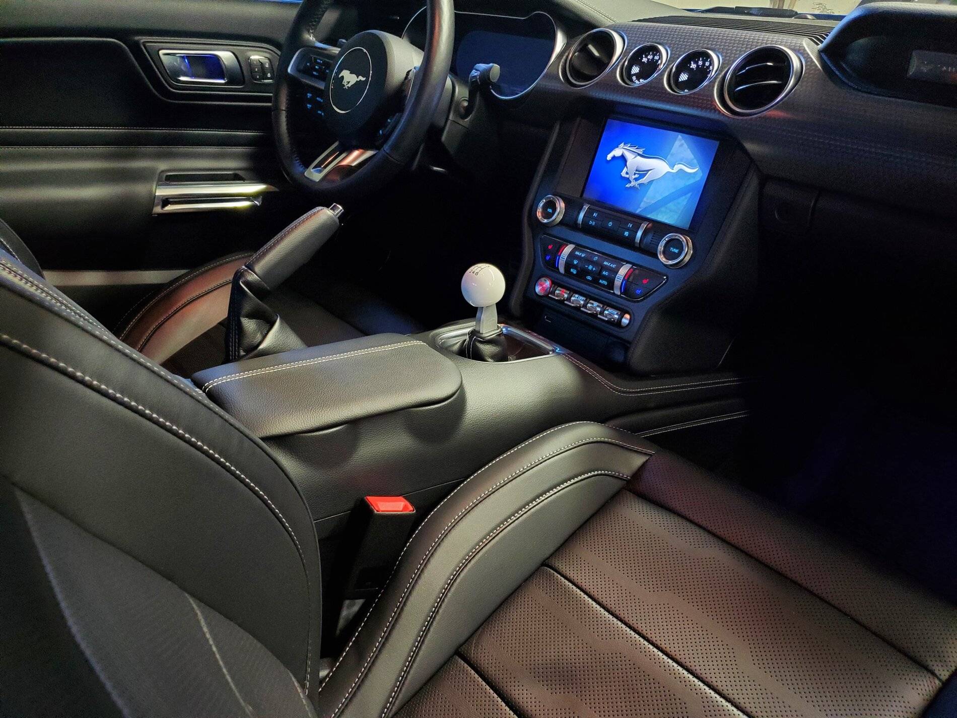

What a difference in shift quality and feedback!
Installation wasn't bad overall, the rubber shift boot took some time...

How much added NVH?
None felt at all when I took it out after the install.
It definitely takes more effort to shift and push against the side springs but I've read they take a little bit to break in.

Does reverse camera function with this set up ?
I have one installed on my '17, yes everything functions like normal. Reverse camera works and everything. The only big difference is you push down on the shifter and slide over into reverse rather than pull up the collar.

Thank you. I figured it would, mgw seems like the best option out here. The others specifically say the camera still works so I second guessed it!

I looked at the MGW but went with the Barton Hybrid. I couldn't find a lot of info comparing them. Most people raved about the one they had.

I was undecided until I watched this video
which convinced me that the MGW shifter is quite well engineered, so now tend more towards getting the MGW where I was considering the Barton Short Throw shifter before. In the video the design choices are explained and they make sense. Both shifters are still interesting, so I might try both in the end, just start with the MGW first.
I looked on their website but I don't see an option for the flat stick. Just the round shaft which is very nice and not as pricey as I thought it would be.

MGW is the best mod you can do to any MT-82 aside from the fluid swap.

Literally no NVH added when it's installed correctly. Nothing but benefits when using an MGW.
For whatever reason they never added the flatstick to their website for ordering. You have to call them to order one.
No NVH increase at all.
