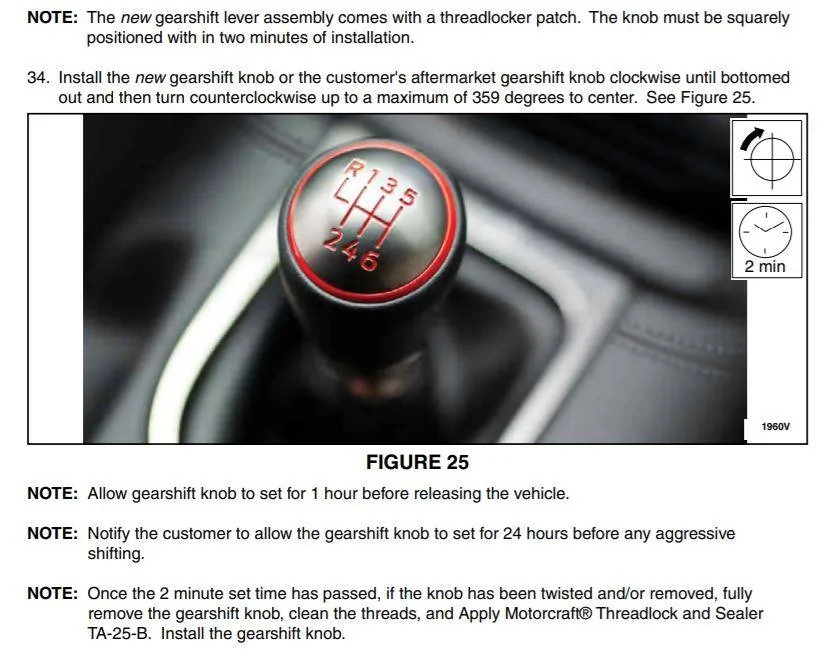

2019 GT 350 Performance Blue
Tech told me it was so the thread locker on the shifter knob could cure.

From the service instructions:
"NOTE: Notify the customer to allow the gearshift knob to set for 24 hours before any aggressive shifting."
