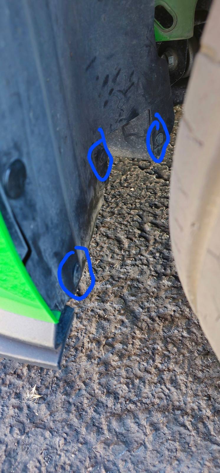

I've started replacing the missing plastic clips on my car, and I'm looking for help on some missing clips. I went to the dealership and I'm fairly sure he gave me the wrong clips, because I can just pull on them and they come out. The part number he gave me was W713610-S300. I think the correct part number is W705436-S300. Added a photo of the clips in question circled that I need replacements for. Also, do the fender liners go inside the belly pan, or on the outside like I have them now? Car is a 2019 GT Premium PP1.

I recently went through this process myself, replacing all the missing push pins, etc. on my wife's 2017. There are at least 3 different sizes in the bellypan and front fender liners alone. The rear fender liners use a completely different fastener. I managed to find them on Amazon and ebay but it took a few trys to get the right ones that actually matched the OEM pieces. IIRC, Most of them are 8mm as noted above but a few are 10mm and then each front fender liner has one oddball large one that you actually push the middle button *in* to release the pin instead of pulling it out.

A couple of those pins have the push to release centers. Not sure if it really matters or not though and I think those might be located higher up on the fender liner anyways.

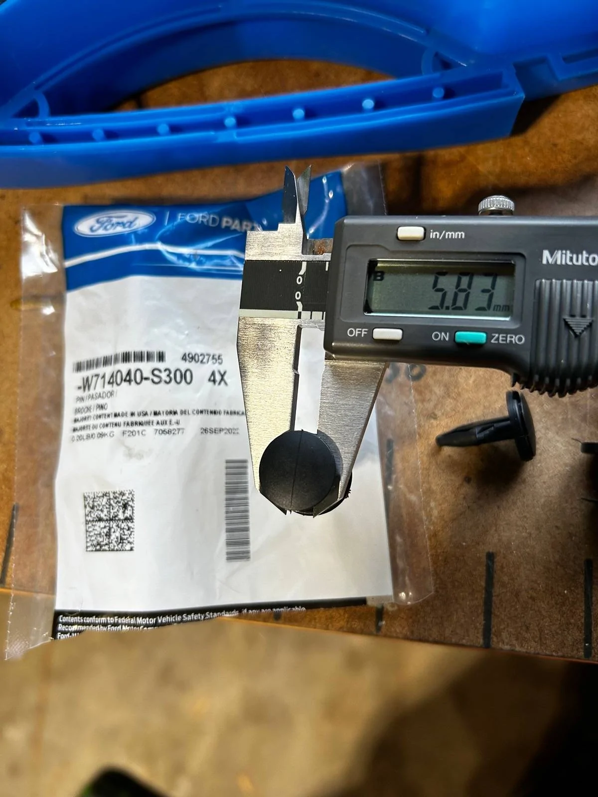

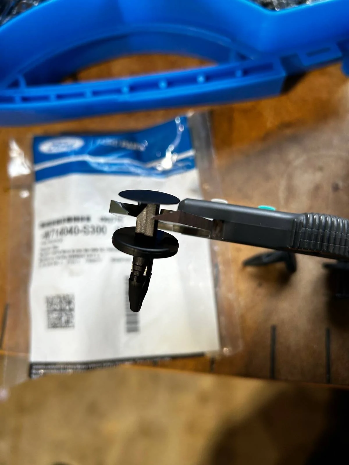

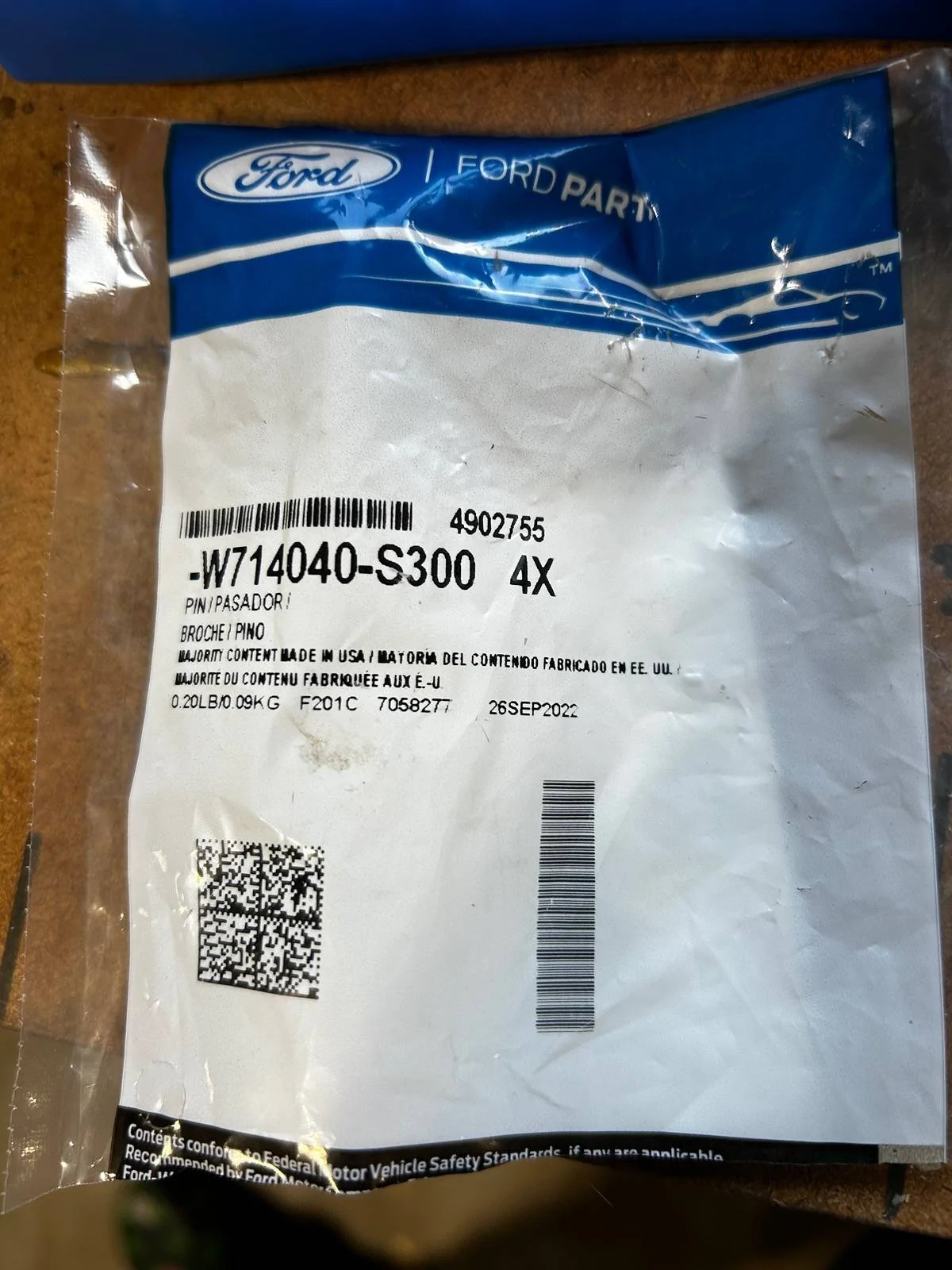

I bought 4 of the OEM push to release ones. They were all missing on my car since I've owned it. I think there's 2 per side. One right above the lowest push pin and another up above in the recessed part of the fender liner.

Well, the 8mm ones I bought off Amazon are too big. They fit, but once you try to press the center in, there's too much resistance. The kit I bought only had 1 push pin for Ford and 1 Christmas tree clip. The rest were other manufacturers.
Just stuck the ones I got from the dealership in.
