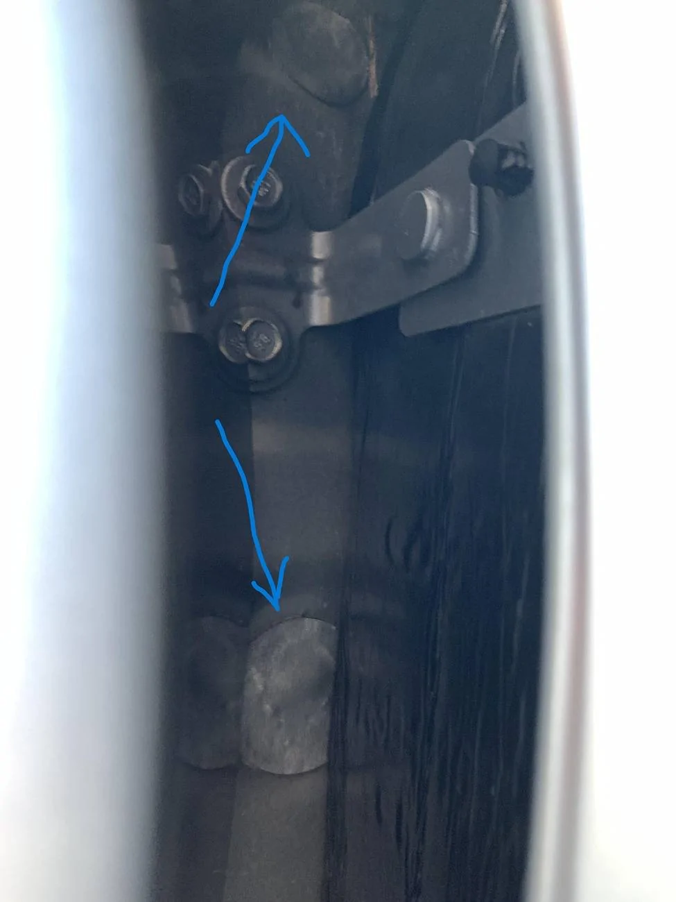

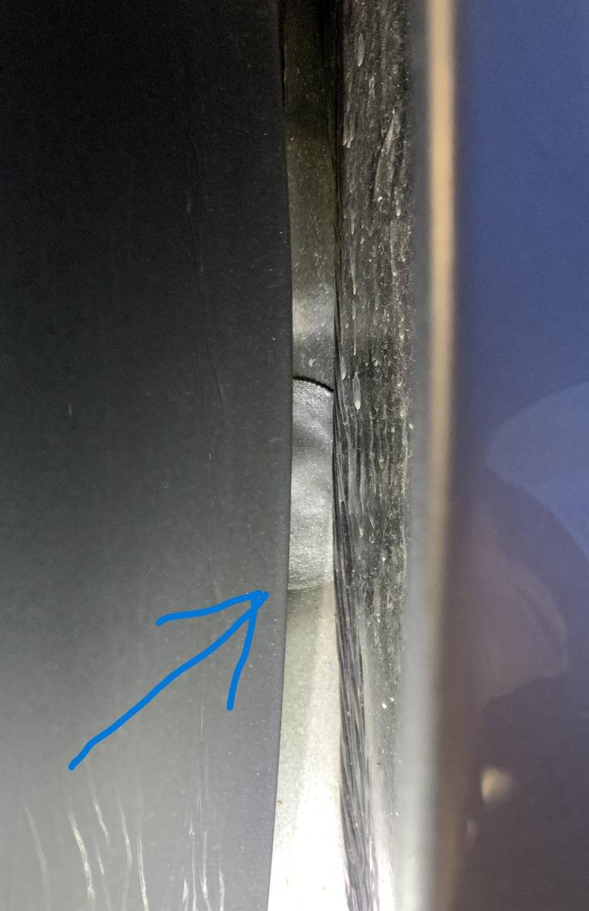

Numerous folks had issues with the hole cover inside the front door jamb. It is only a PSA backed "decal", and can degrade/dislodge over time. Open your door, and look between the door and the front fender about 2/3 of the way up the jamb.
Edit: I thought I'd take a better pic and learned in the process that there are 2 plugs/patches. A smaller plug/patch/decal is forward and above the first one mentioned previously. See updated pic below:

The stickers have already been taken care of (twice just in case).
